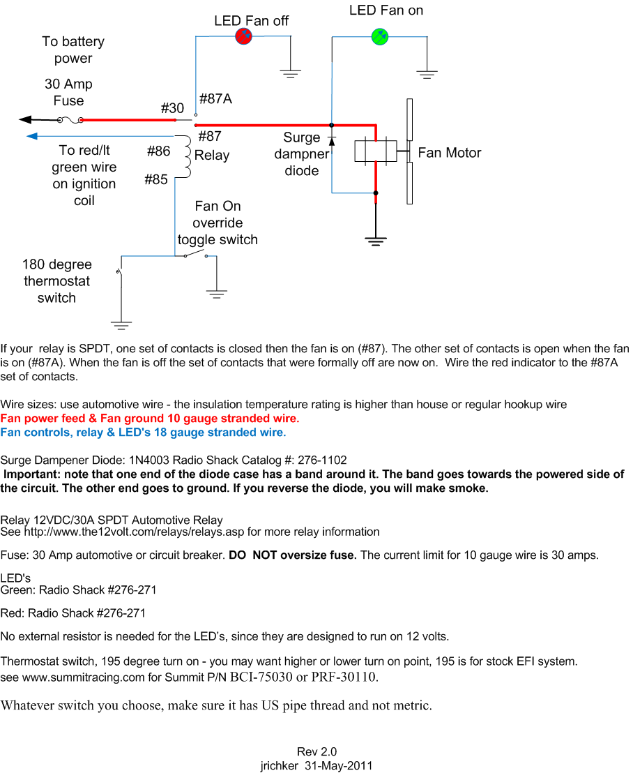

I have a question about wiring up my electric fan on my stang. My question is how do I wire in my electric fan control thermostat unit into my ignition switch so that my fan will turn off when my engine is off? This is the only thing that is stopping me on this install. I know some guys just wire in a switch under the dash but I want a better system, I want it to turn off and on when the car is off and on etc.

Yeah thats what I want but I am just confused on how to wire it into the ignition, what wires do I connect to? Do I need to run a wire into the dash or can I use a wire in the engine bay to connect to?

Do not use a simple on/off switch without using a relay. The current load can burn up the typical cheap automotive switch very quickly. The fan draws 30+amps and you need to use #10 wire on the fan power and ground wiring.
If you are good with electrical stuff (90% of the people here aren't), build your own controller. The numbers on the diagram (#86, #87, etc) refer to the numbers on the bottom of a typical automotive relay.
attachments\66614\
Note that the thermostat switch in the diagram isn’t really suited for the job. You’ll have to do a Google search and find your own.
This version of the fan controller will continue to run the fan after the ignition switch is turned off, just like most new cars.
To allow the ignition switch to control the fan so that it does not run when the ignition is off, connect the relay contact #86 to the red/green wire on the ignition coil or to the red/yellow wire on the coolant level sensor.

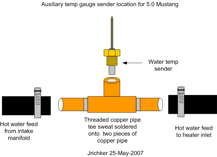

Alternate placement for a temp gauge sender or temp switch/temp sensor for an electric fan. Use the heater feed that comes off the intake manifold. Cut the rubber hose that connects the manifold water feed to the heater and splice in a tee adapter for the temp gauge sender. Be sure to use the same water feed line as the ECT sensor. That way you will get the most accurate temp readings.
Tee adapter info:
Make a pilgrimage to your local hardware or home supply center and get some copper pipe and a tee that fits the temp gauge sender. Solder two pieces of copper pipe onto a copper pipe tee with threads in the tee part. Find the correct brass fitting to match the temp sender threads to the tee fitting.

So i run #86 to the ignition coil. lol i know thats exactly what jricker said above.. But it says to run it to ground. But i assume the coil is grounded obivously. I want it to shut off when ignition is off.
Also, so i hook up each power wire off each fan to a 40a relay, which terminal? Then hook up the power fan wire coming out of the controller relay to that 1st relay, but which terminal?
I know im stupid. Id rather look stupid then burn the car down. So let me add, the power wires coming out of the 40a relay for both fans is not 10 guage, its 14awg. Not cool or what? Each power wire is on a 25a fuse, which i read blew up, so put 40a fuses and it worked fine. with this controller, hayden 3652.
Also, just run the negative fan wires straight to grounds, or to the relays, then ground the relays?
Negatives on the fan motors go straight to ground. What fans are you planning on using? Depending on what fans you may need a bigger relay.
Terminals 85 and 86 can be power or ground each. Basically power one side, ground the other. jricker is calling for 86 to be power, your instructions above call for 85 to be power. The two options to get power that jricker is referencing would be the ignition switch in your diagram.
Right. Contiur fans. It technically does need a bigger relay. I got a 40a and a 70a. But should still turn on if wired right.
My power wire for the relay is coming off the starter solenoid where my positive cable terminates at. Ima run it to battery direct for a test, i just noticed it said that. Maybe that gives me power. Lol.
