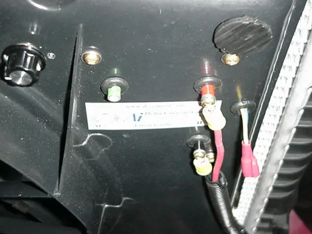

If you haven't already mounted the fan look on my Stangnet site photo page and see how I mounted mine. I still have the cooler ties in there but I didn't trust them. the top two brackets bend over the lip of the radiator. The bottom is a piece of aluminum I cut out. Mine works great btw.

Very nice work! Im impressed with how clean everything is! So three questions......
How did you make the brackets?
Where's the Dc controller mounted?
How did you get everything so clean?
:D
I ordered everything from www.dccotrol.com. The controller was already mounted on the inside of the fan housing. All I had to do was hang it and run wire to it. The controller is pretty compact so I don't think it would look bad on the outside either.The top brackets are strips of stainless steel I cut and bent. Then I riveted them to the top part of the housing. Try and mock everything up and see how you want it to fit. If you need exact measurments for anything I can get them tomorrow.

Impressive, sn9550! I was not aware that Delta Current integrated their controller with the fan in the complete kit. Kinda feel like Im missing out now.. Im gonna remember that when I go over the cooling system on the Bronc :nice:
I think you should be able to get the stainless steel at Home Depot or Lowes. I don't remember the thickness just don't get it to flimsy. I used a cutoff wheel to cut it out and a vice/dead blow hammer to bend it.
One of the reasons I ordered the whole setup from www.dccontrol.com was to save time and hassle with trying to set everything up. He does a good job!
