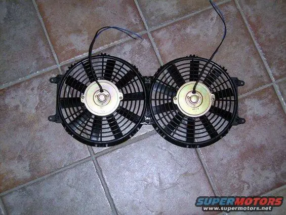

Mustang J: your car is cooling fine with two 10" fans? Did you mount them on a fan shroud or are the fans just mounted straight to the radiator? Stock-type radiator?

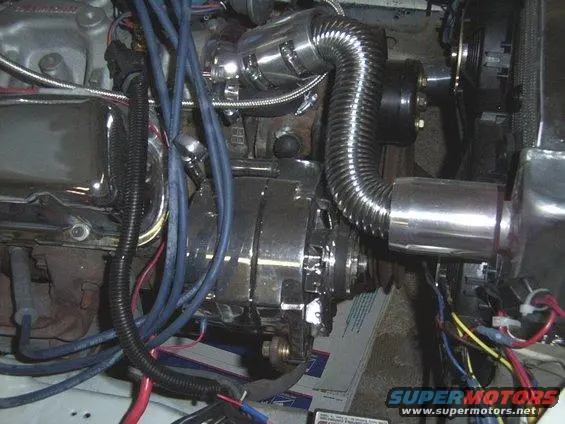

For those with electric fans, did you need to upgrade your alternator? A single 16" Mr. Gasket fan draws only 11.4 amps. Seems even a lowly stock 40 amp alternator could handle that (I would probably upgrade to at least a 60 amp alternator though).
I am also using 2-10-in fans on my II. The fans mount directly to my aluminum radiator. I upgraded the alt to a 1-wire 100 amp unit.
