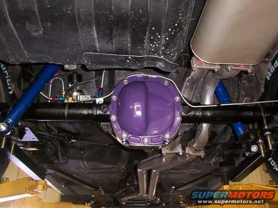

I have an inline electric fuel pump from a Merkur XR4Ti that I'm using in my 2.3T aplication. It's a decently large system with the fuel pump and filter in one mounting assembly. I was wondering where others have mounted their electric fuel pumps.
Pictures would be great, if not I'll just figure something out this weekend. I just want to see if I can learn from other people's experience.
PS, I had a bung welded into the tank for the return line, I'm using the original 1/4" supply line as my return line, and I hade the stock pickup and fuel level sender modified for a 5/16" line that I'm going to route to the pump then up to the fuel rail.
Also, if anyone has any pictures of fuel line routing that'd be great.
I mounted mine in front of the rear axle next to the junction for the rear brake line.
