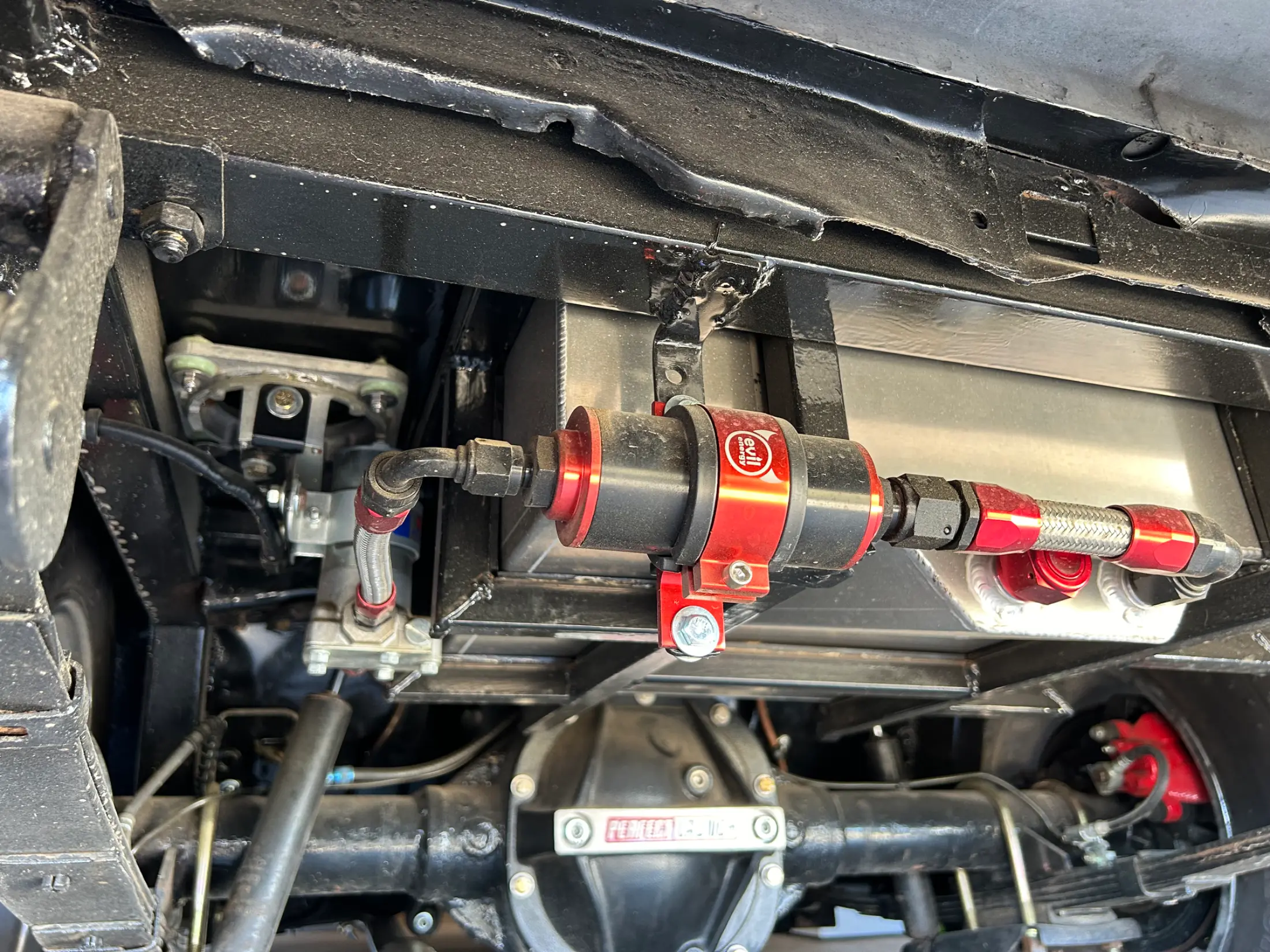

It is all the way in the back mounted between the fuel cell and frame rails. Basically just aft of the rear differential. I used a rubber and spring isolation bracket I built myself. Just like the gyro mounts on an aircraft. I was certain that would keep it quiet. I’m now starting to wander into f that is somehow making it louder by the mount vibrating. But I can’t see any vibrations. Looks smooth and steady to the eye ball.

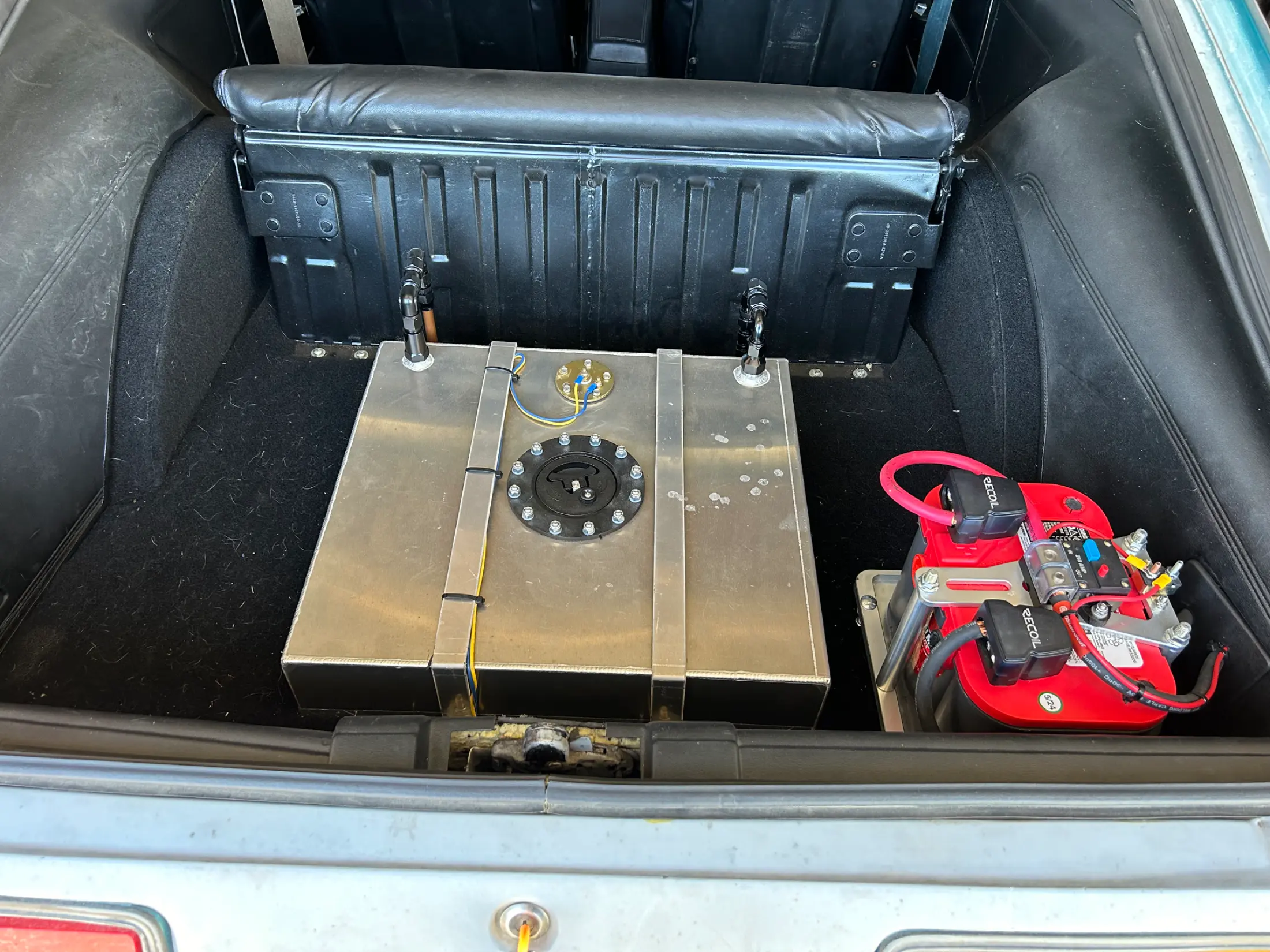

I was hoping an in tank pump would be an option. But I have a fuel cell with the lower sump outlet for the fuel. In order to go with an intake pump, I’m guessing I would have to block off my sump port and then have the fuel feed line come off the top of the fuel cell and then plumbed to my filter from there. My main issue with that is my fuel cell comes through the floor exposing the top of the tank in the hatch. I was trying to avoid pressurized fuel lines inside the car.
Here’s my current setup.
Top of fuel cell in cabin area. The lines you see are vent with roll over valve and the return line from regulator.

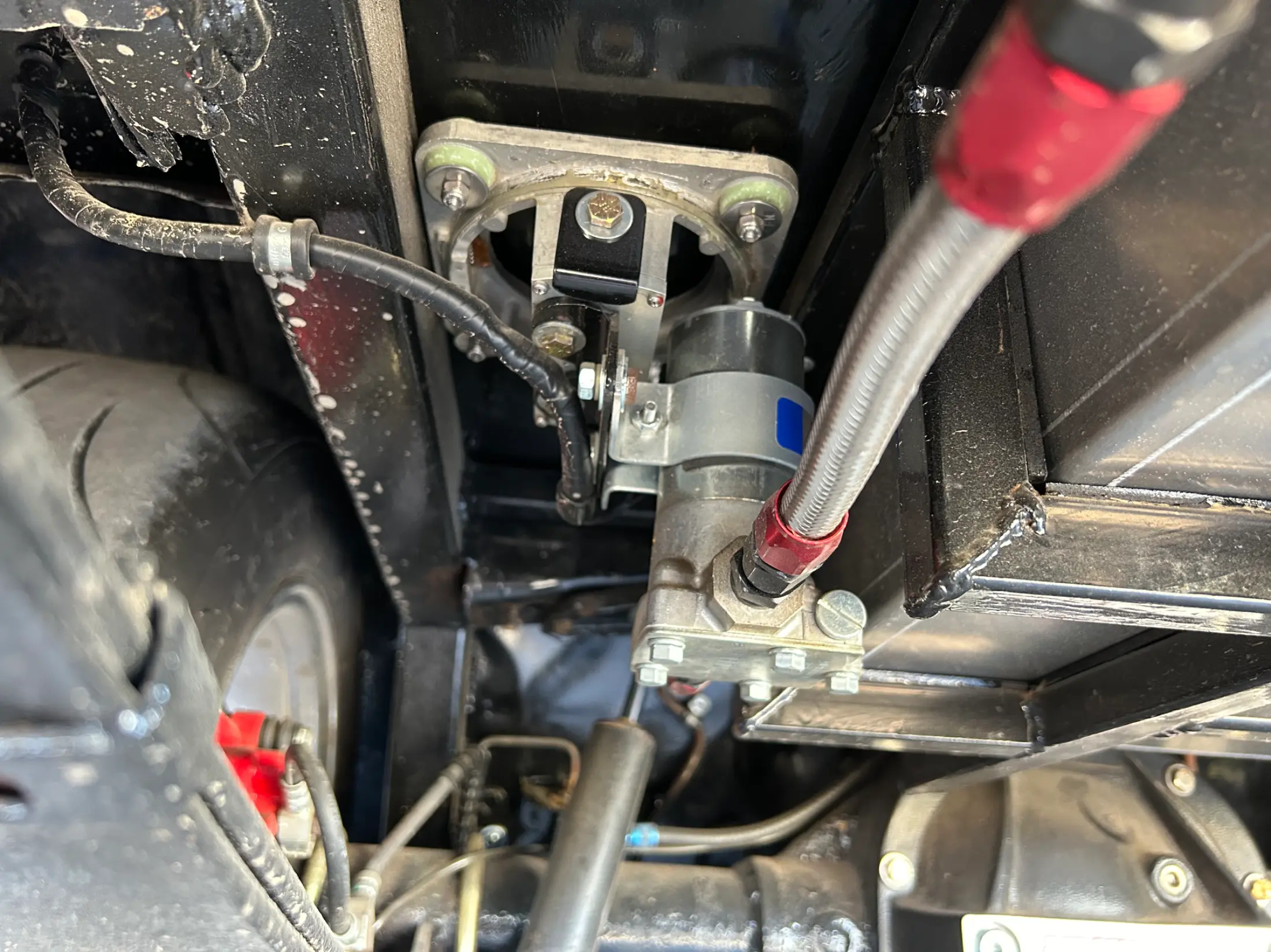

Here’s the bottom of the fuel cell with an inline filter and Holley blue pump plumbed just to the left of the fuel cell.
This is a shot of the bracket I made to isolate it from the car chassis. It seems to do a really good job of that.
Reactions: Blackhawkxx
While taking the above pictures, I just thought of one possibility. I am hard lined and stainless steel braided hose all the way back to the tank. I wander if I could be reverberating the sound through the fuel cell. Making it even louder than normal? I’m not sure how to prove that theory. But does seem possible.

You have 3 metal pieces between the outside of the pump and the four rubber isolaters... if one of this 3 pieces has a eigenfrequency near the frequency of the pump, this part could make a lot of noise. Best thing is to take a piece of wood and press it against different positions of things that could vibrate, while the pump is running, can help to locate such sources for noise.
Another thing is i read in the interwebz: that they ordered 3 pumps of the same model and always try which one is the quietest pump and the rest they send back. it seems there is within one model a big variation in noise...
