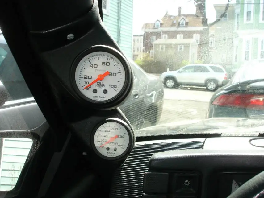

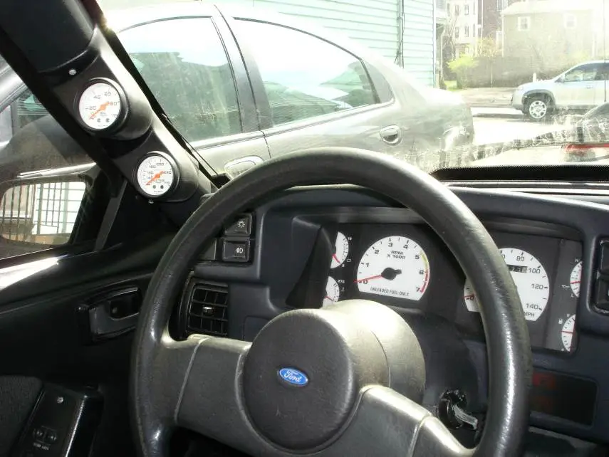

I installed mechanicals in mine simply because i wanted the larger range of needle sweep.
