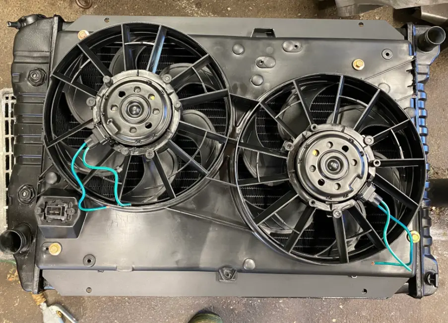

I was looking at the Mishimoto dual fan from american muscle, but it only stated 1900 cfm combined whereas the Contour's claims 3500 cfm. Could be your issue.

I think one strong point of the contour fan is that it does cover the entire radiator, especially when used with the LMR brackets.
With the entire open surface covered, the fans are drawing air through the entire radiator.

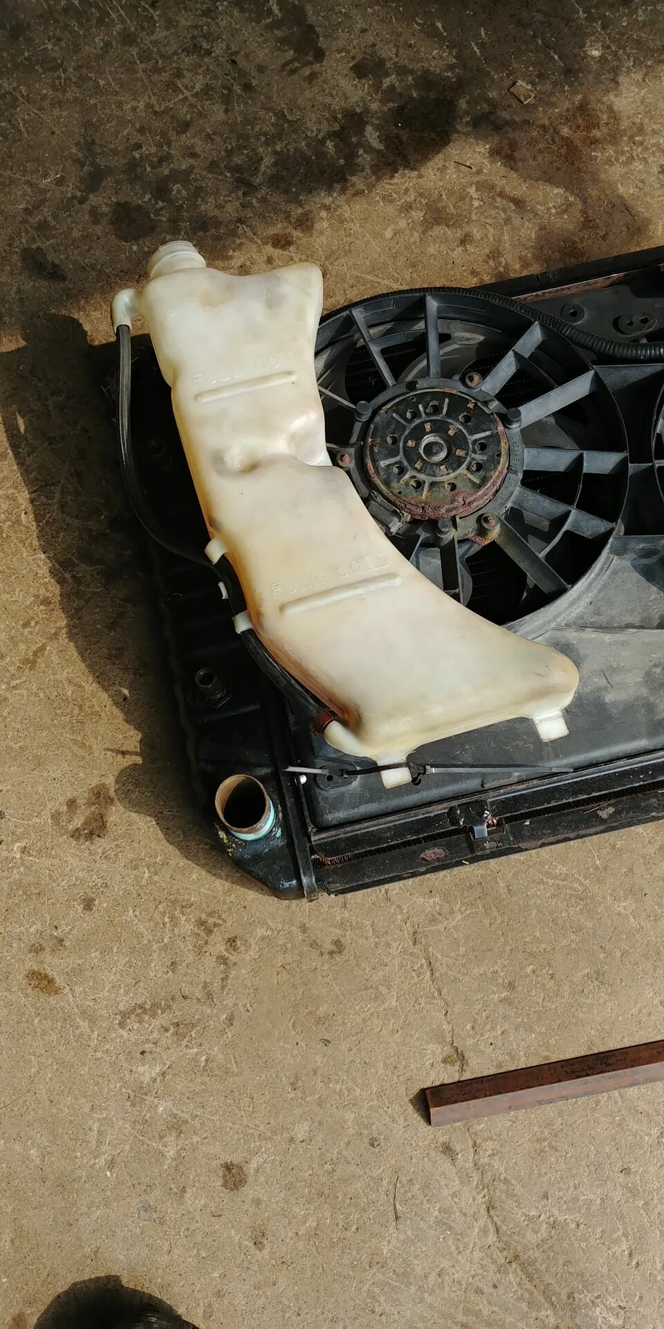

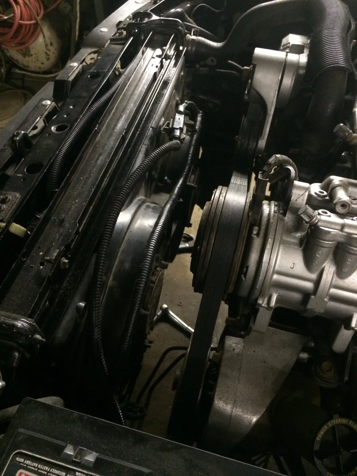

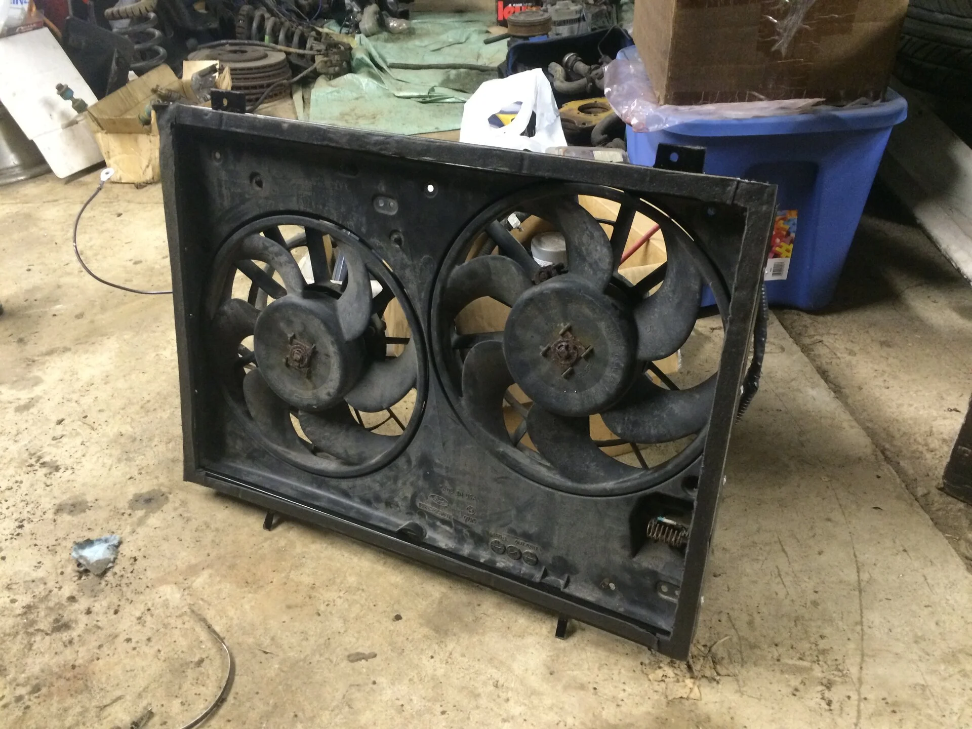

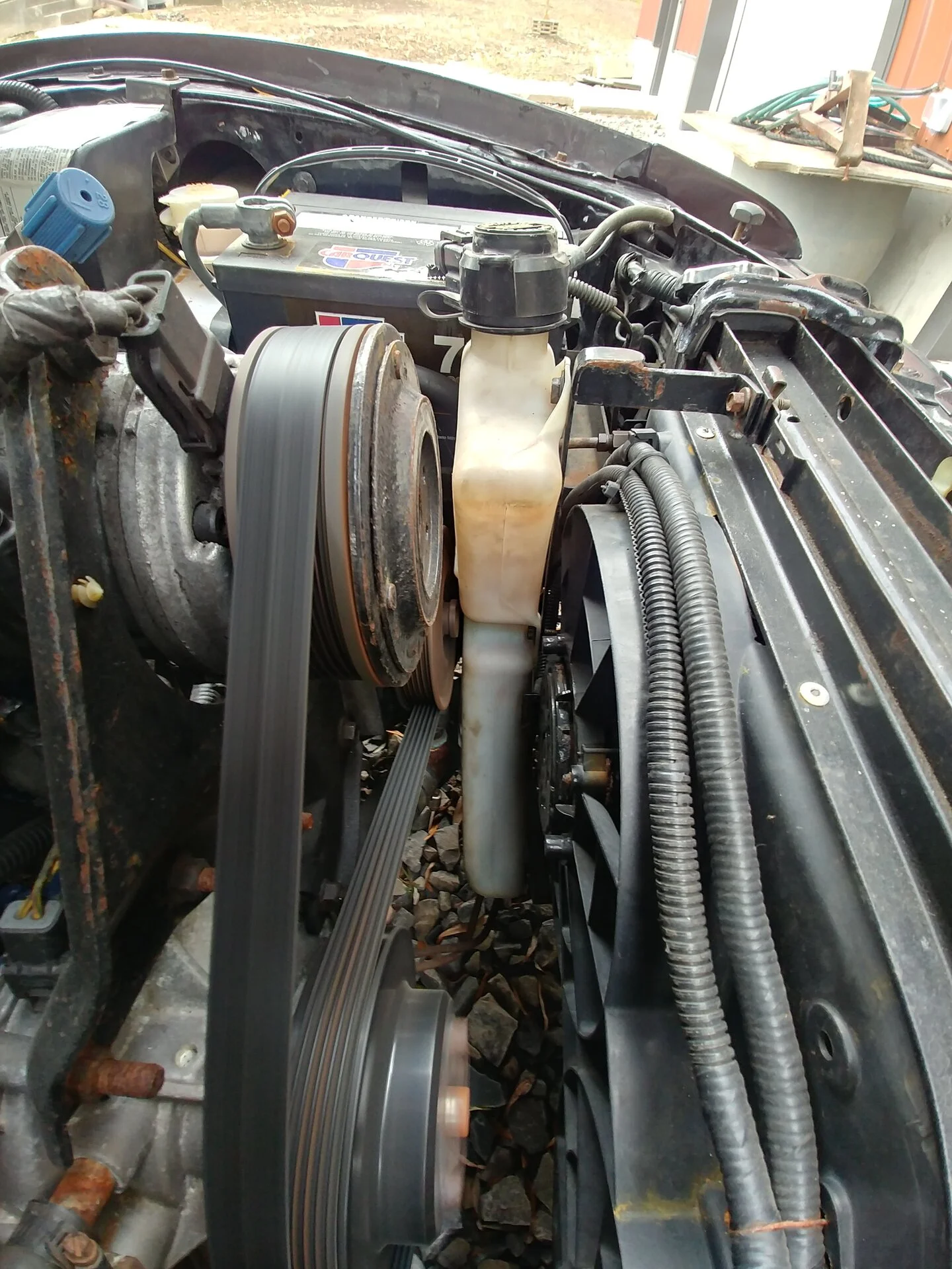

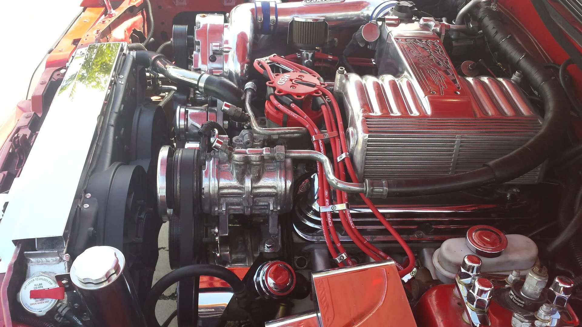

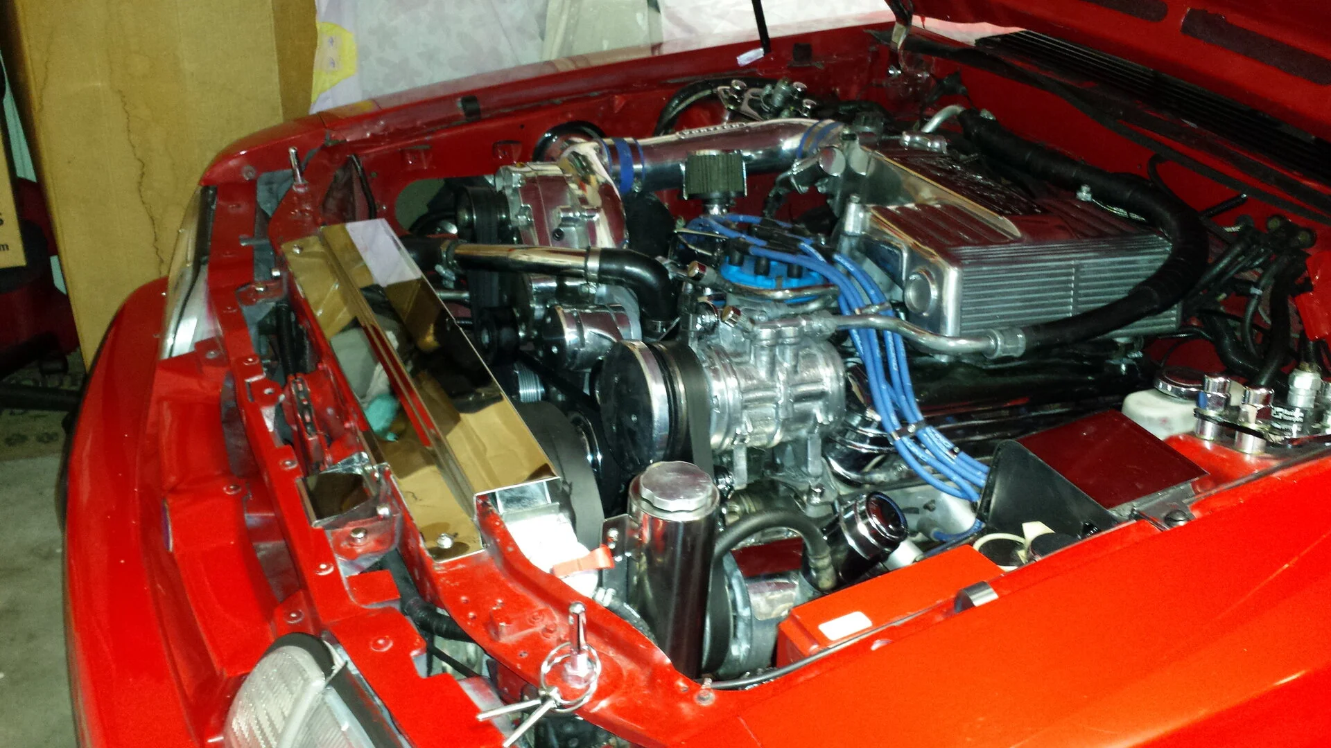

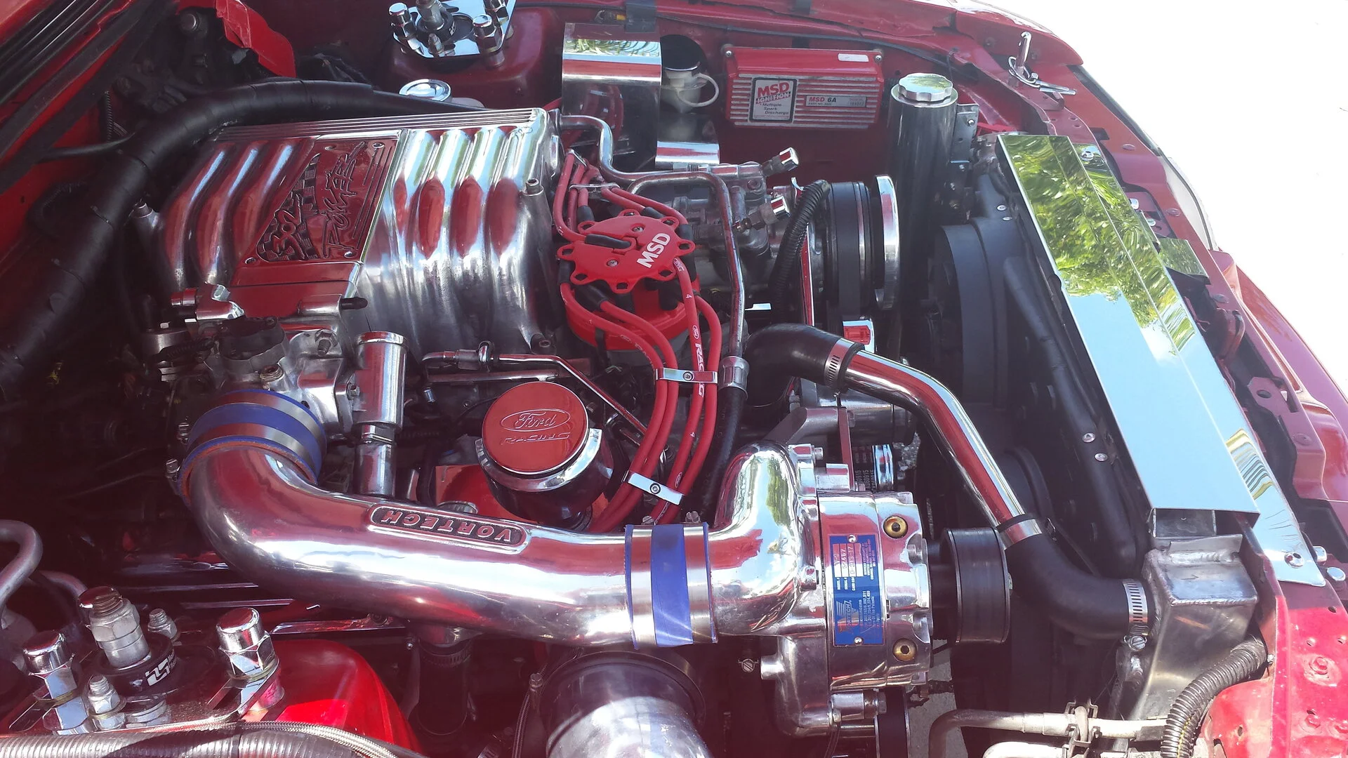

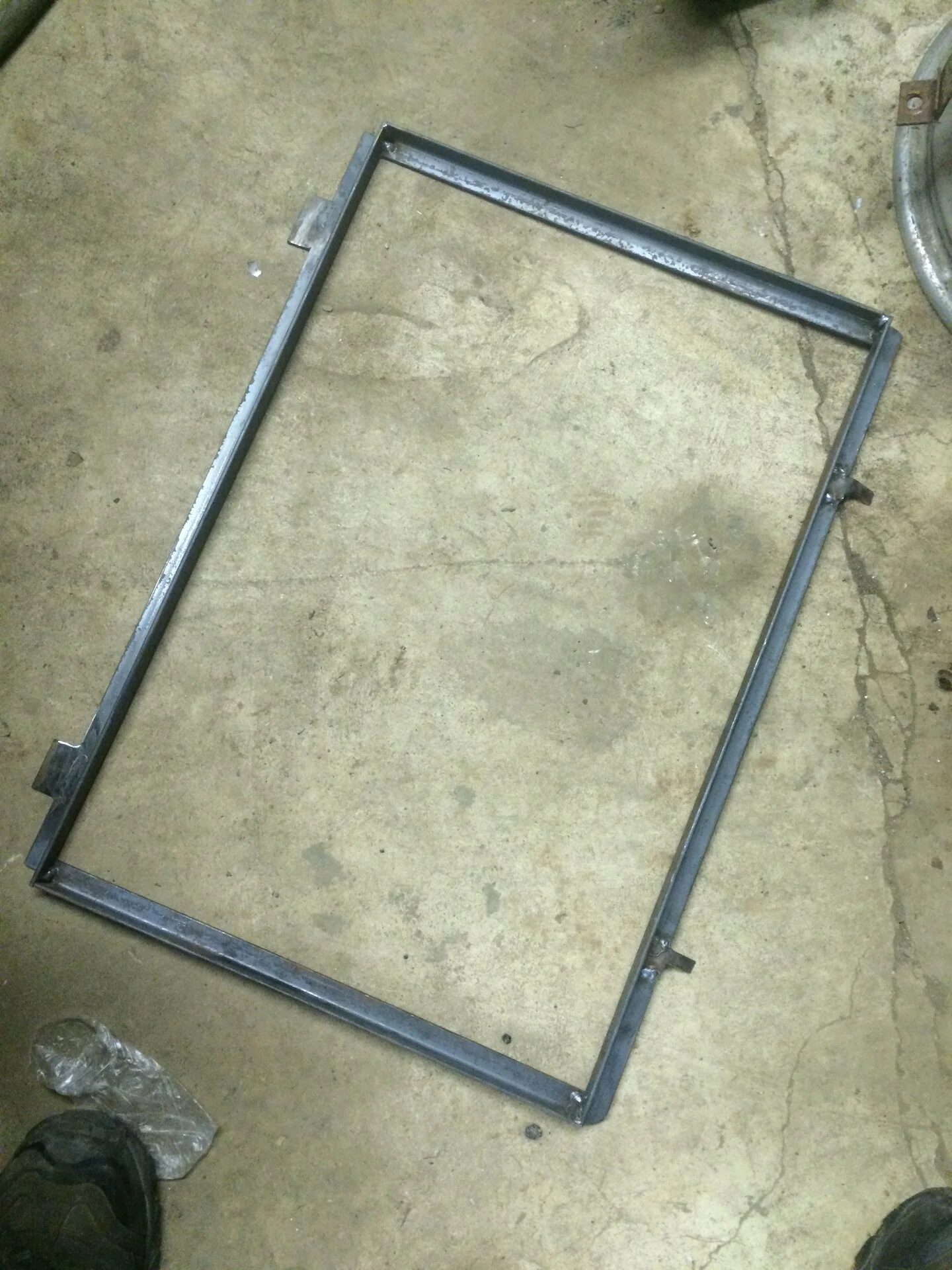

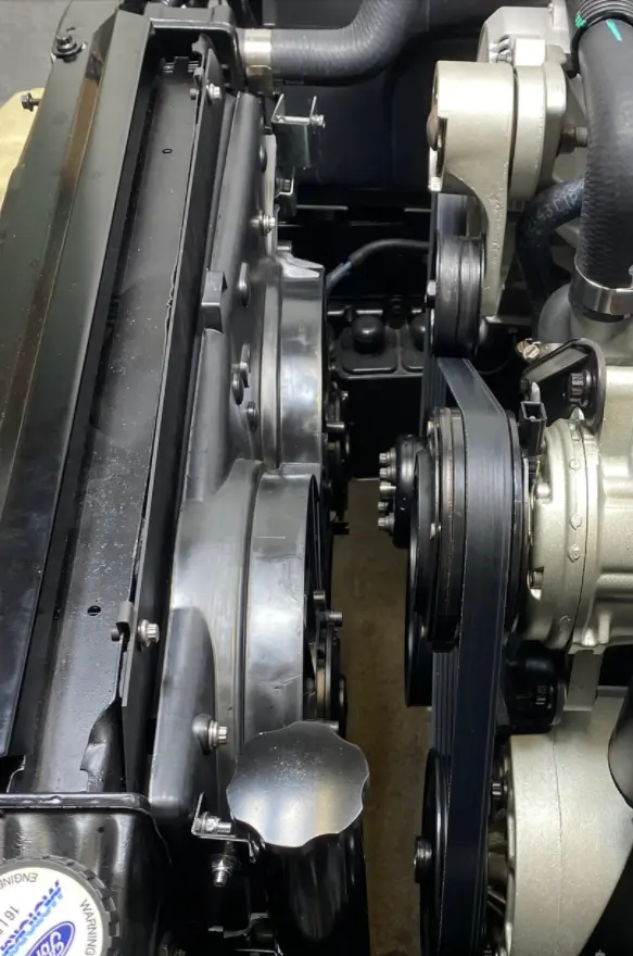

I agree with Mike that one of the big advantages of the Contour fans is it completely covers a stock size rad.
I made my own frame to mount the fan to. I used 1x1 angle like so.
The fans fit inside and then I drilled and rivetted the fans to the frame. I applied some foam tape to get a good seal to the rad and help prevent any damage from frame rubbing on rad fins.
I then mounted the stock overflow bottle. First with zipties (for about 2 years) and later with some fabricated brackets.
Clearance to front belt.
And overflow clears, not by much but it clears.
My rad in all of these pics is a OEM style, 3 row (instead of factory 2 row).

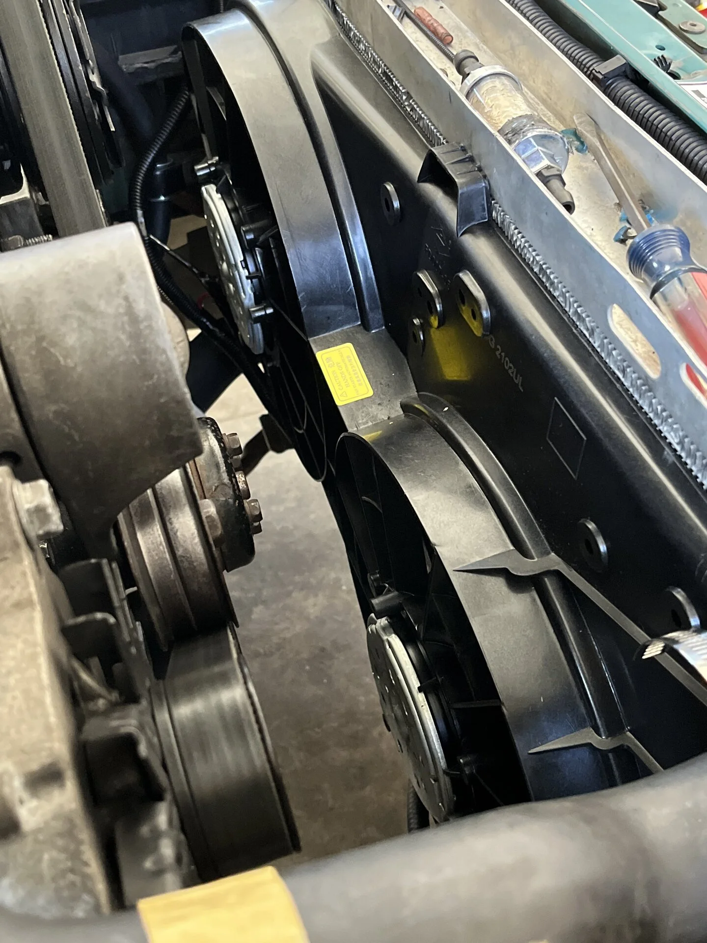

mikestang63 said:
What pulley set up are you running with your set up? I want to run the contour fans but not sure I will have the room. The supercharger belt sits pretty close to the current dual spal fans I'm currentley running.
Pioneer balancer with the stock Vortech 8 rib crank pulley
Reactions: Fri Guy
Did you have to trim the fan shroud or anything special for clearance?

  • #29
other than the two tabs on each side no. I added foam tape around the perimeter of the fan shroud as well

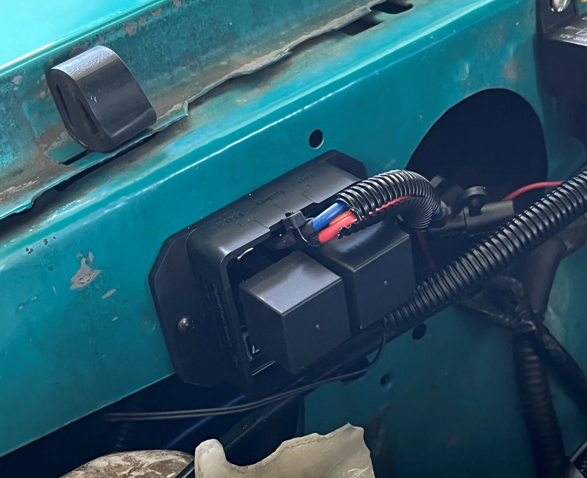

So I got the Contour fans and the summit controller I talked about earlier. Wired everything up and it works great. Keeping it nice and cool so far. I don't drop below 14 volts while both fans are running at idle, but that means nothing in terms of amps. I'm looking into alternator upgrade next.
Did my best with some convoluted tubing.
