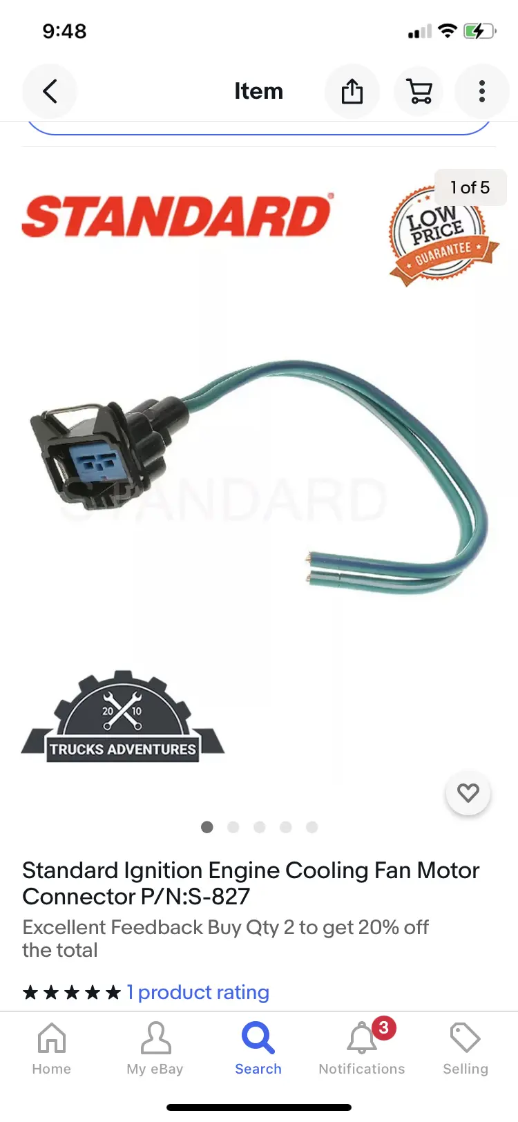

Well, another silly question… anyone have an example pic of a contour fan CONNECTOR?
Looks like this?
Looks like this?
That’s it in your picture

Same connector for the resistor pack on the fan shroud as well
