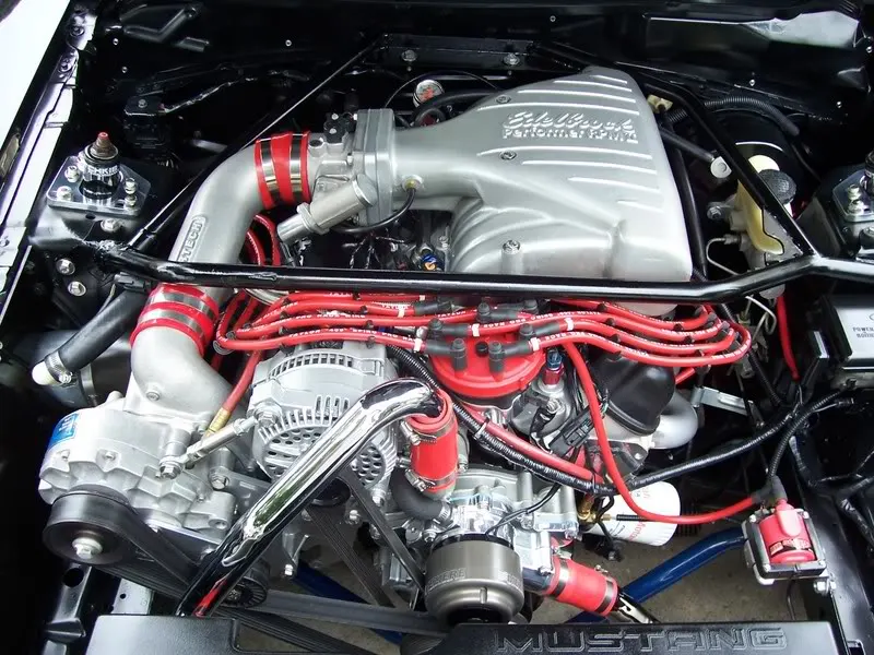

i use the meziere pump.

I run the Meziere pump as well, and it was the best money I've ever spent. I can cooldown the motor between runs very quickly. Water temp is very consistent, and plus I was so happy to toss the thermostat, I hate those things. I just run a reducer in the water opening, I have a hot weather reducer and cold weather reducer.
