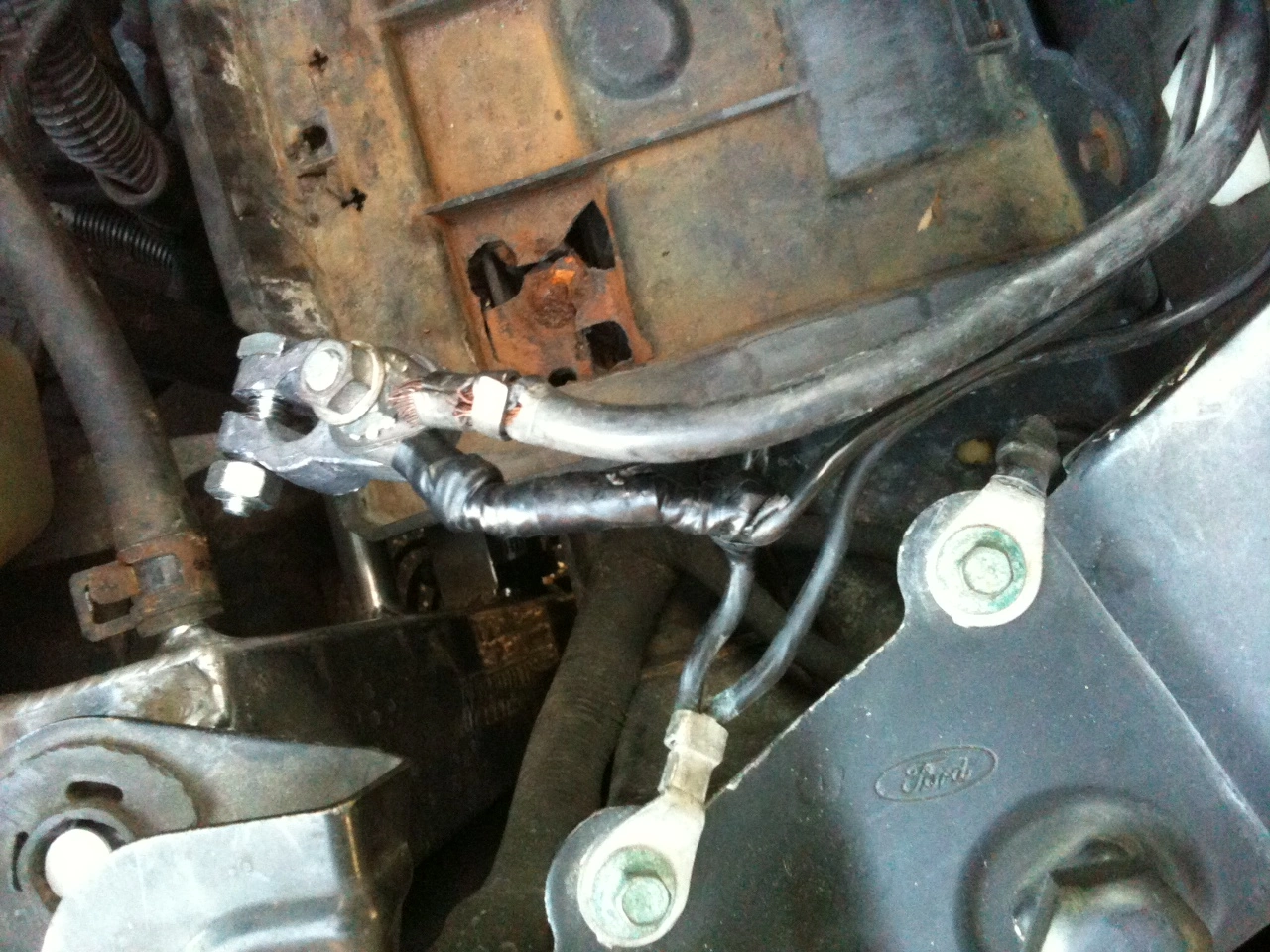

Anyway, noticed the ground cable from the battery to above the DS headlight had a lot of electric tape (picture attached, already ordered new battery tray) but my friend said a bad ground probably won't drain a battery but that I should fix it.

2) I can't find where the ground connects to the engine. I was thinking the first step would be to make sure my grounds are good. Does anyone have a diagram? I know that my hood ground strap isn't connected to the frame but I was pretty sure that isn't the problem.

Regarding the engine ground strap. It's located on the left hand motor mount and goes to the left hand frame rail.

Your friend is correct. You should fix the ground. I agree that it won't cause a drain. But it could cause the battery to not get changed in the first place.

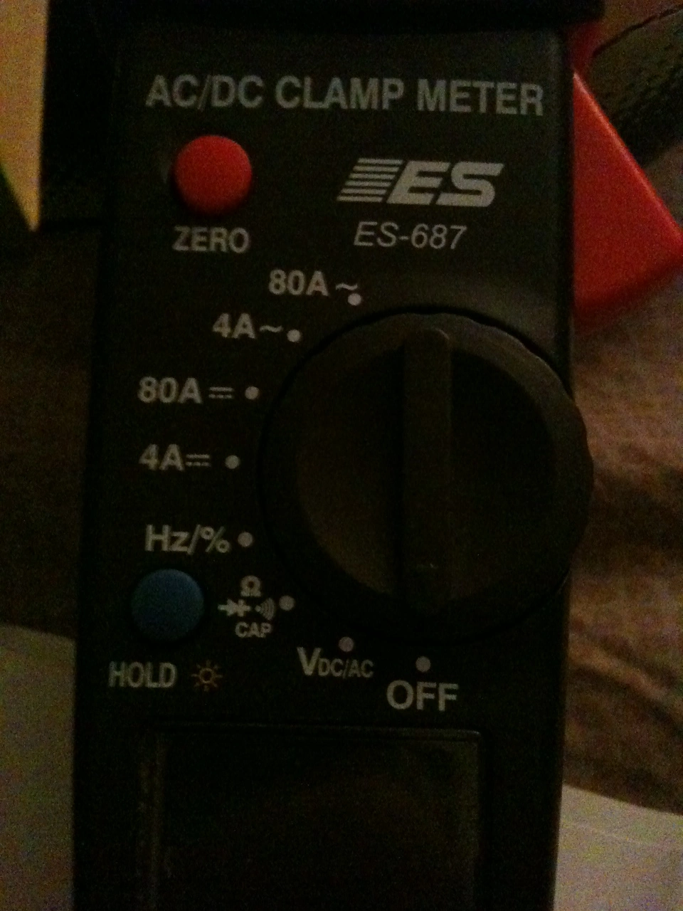

Thanks for the info. I figure I might as well ask, which setting would you use to do the reading with the clamp? I am now sure I was using the wrong setting the first time around V(DC/AC) using the DC setting which would measure volts I assume and I need to measure amps (feel like a jackass now, ha).

Use the 4 amp DC setting (the dash/line symbol). A car's system is DC. If the meter is set to AC, it won't read anything but AC ripple.
As stated before, the meter needs to be able to detect rather small amounts of current. So if turning on the dome light does not change the reading, then likely the tool is not senstive enough to do the job.
The write up talked about the importance of "zero"ing the tool. I believe it stated that the clamp on amp meter needed to be in place when zeroed.

Haha I promise it's the worst FM. Nowhere does it explain any setting and the part about car battery drain is VERY vague just says to clamp on negative cable and take measurement. Thanks for the help!

Okay guys, worked on this today. Thanks for the help! Left car for at least 45 minutes then made sure meter was working properly by opening the door and noted reading went from .0079 to .0082 then started pulling fuses. Pulled every fuse under hood/dash with no change in the reading then closed/opened the door to make sure meter still reading properly. The manual for the meter said reading of normal car is 40 milliamps so I'm thinking my car is 79 milliamps. Is that right? Not sure what to do next but I'm sure meter was working properly and sensitive to read change of dome light on. Any ideas?

Did you repair the ground wire? Did you confirm that the grounding strap between the left hand motor mount and the frame rails is in place?
I have to say that if your load were 79 milliamps, that will not run down a fully charged battery in three days.
There are 1000 milliamps in an amp. So 0.0079 amp is 7.9 milliamps!
How much does the load change if the radio is turned on?
OBTW, a typical dome light is 10 Watts. At 12 volts, a current of 0.833 amps is required. This is Ohm's law (Power=current*volts). This is 833 milliamp just to run the dome light. Almost a full amp just to run ONE dome light.
Your measurements have the dome light using 3 milliamps. To me this says that your meter is not accurate enough to measure the low currents required to correctly nail down this problem. Consider using an old fashion "shut" style amp meter.

Another update. (been super busy with work) - Long story short, I was able to fix the ground with the help of a local mustang shop. They recommended a shop that deals with electronics only for the drain and I had to pay $84 but the guy there said it was fuse #27 (radio) which was draining the battery and he was able to pinpoint the problem to one of the amps on the back speakers. I pulled the fuse since I don't use the radio (this was last Saturday) and the battery is still holding its charge and everything seems to be good to go 8 days later. I'm hoping it's not an intermittent issue since I wasn't able to find the drain and a guy a few booths down from the mustang shop couldn't find the drain as well. This battery has issue has caused a problem with my tune (93 octane, bolt ons, etc) where it's idling terribly so I'm having the mustang shop I went to do a custom tune for me. I wanted to thank anyone who responded for all the help and just give an update on what happened. Also, posting a pic of my car as it looks today. stang.webp
