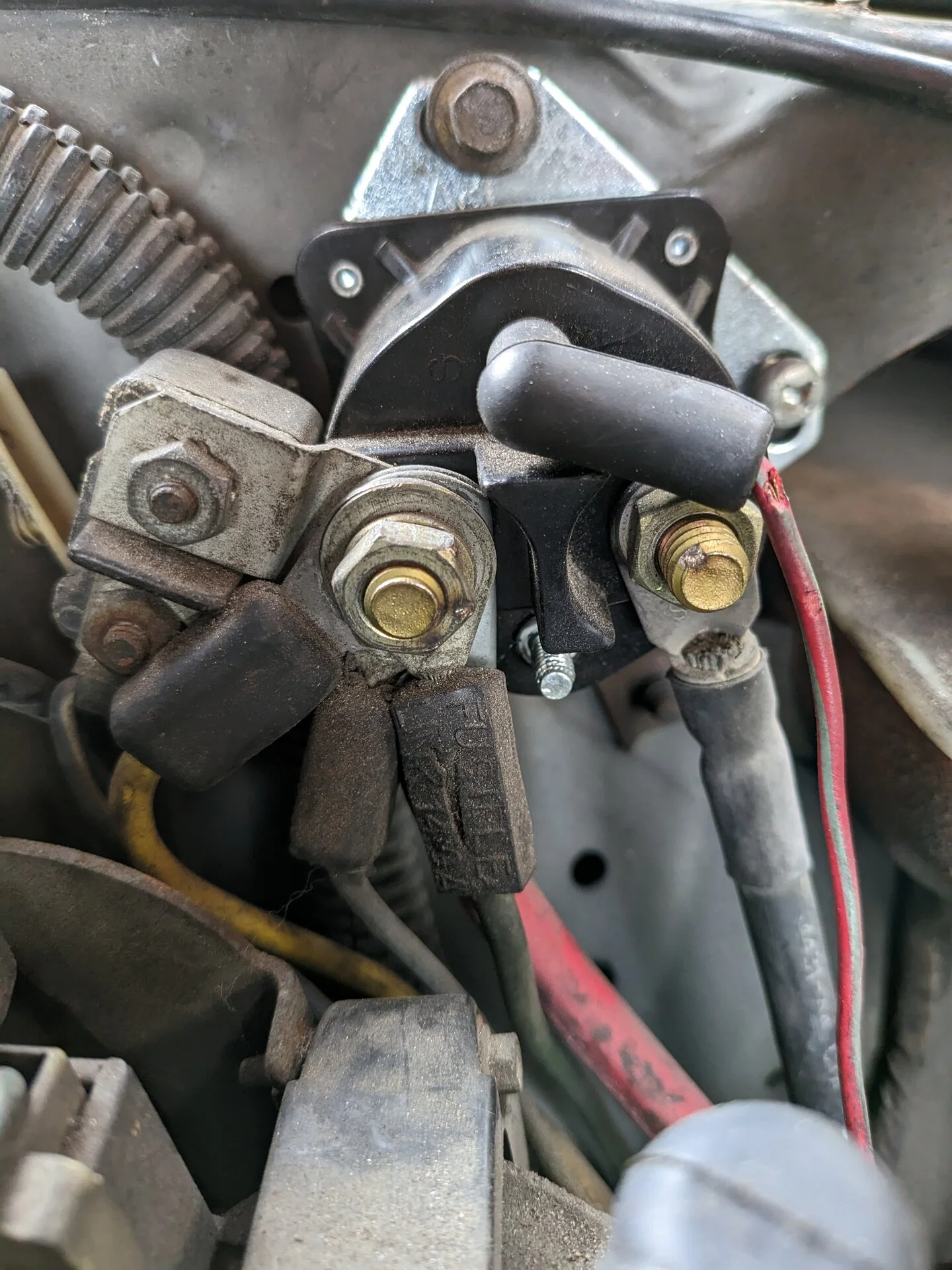

Some progress today when I threw the fully charged battery back in. The interior power worked for a bit and then it died. I took a look again at the solenoid this AM and I did notice a possibly faulty fuseable link, but I am not sure that it's actually faulty (cracked at the fuseable link label bit). The green wire seems to be the one I'm suspecting is faulty.
Voltage at the battery is looking good, going to try to see why I am not getting voltage to the interior, but I'm going to debug this wire and a few others further.

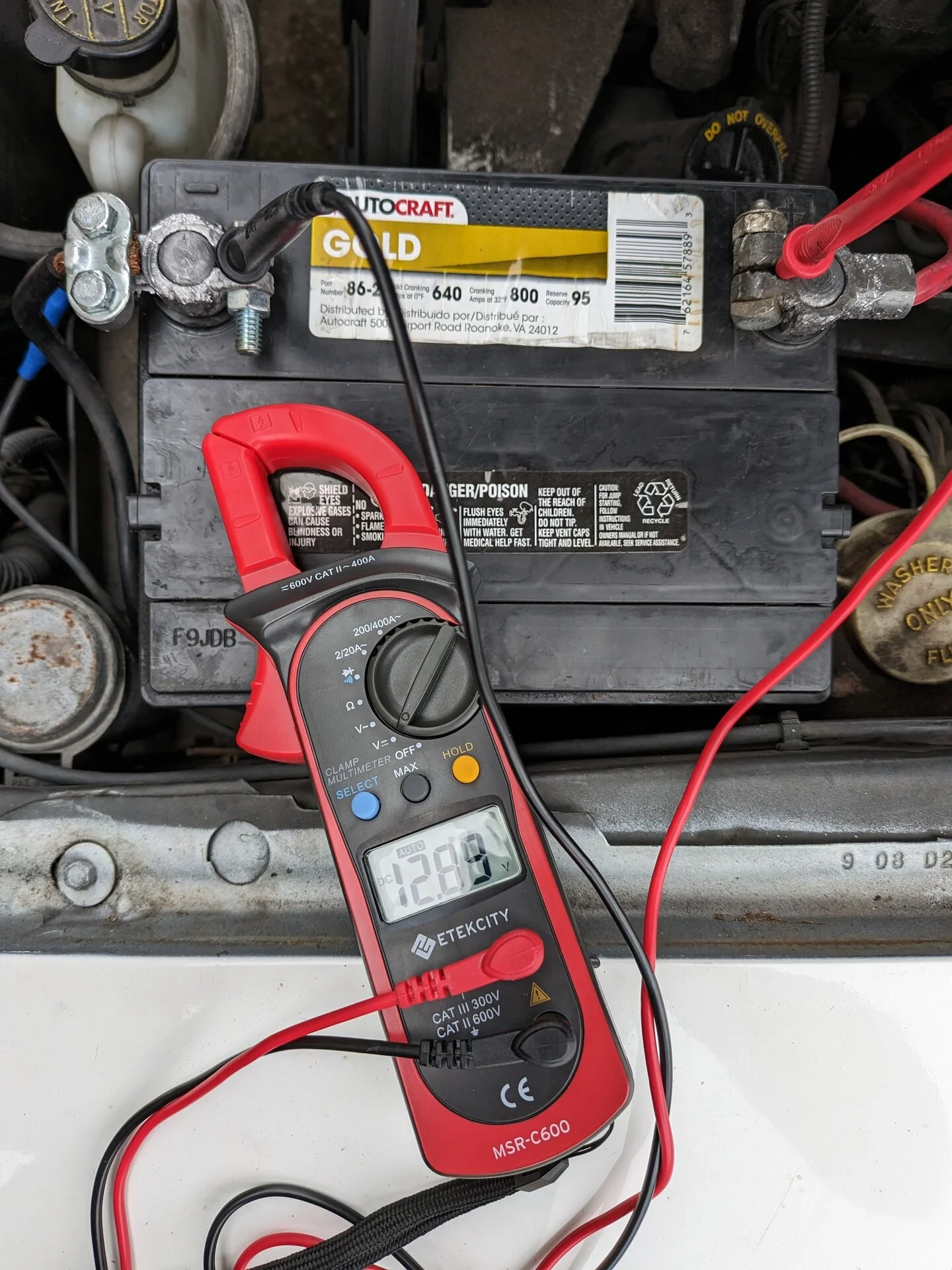

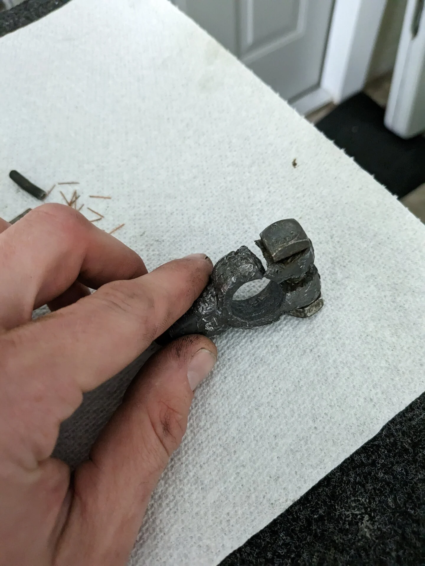

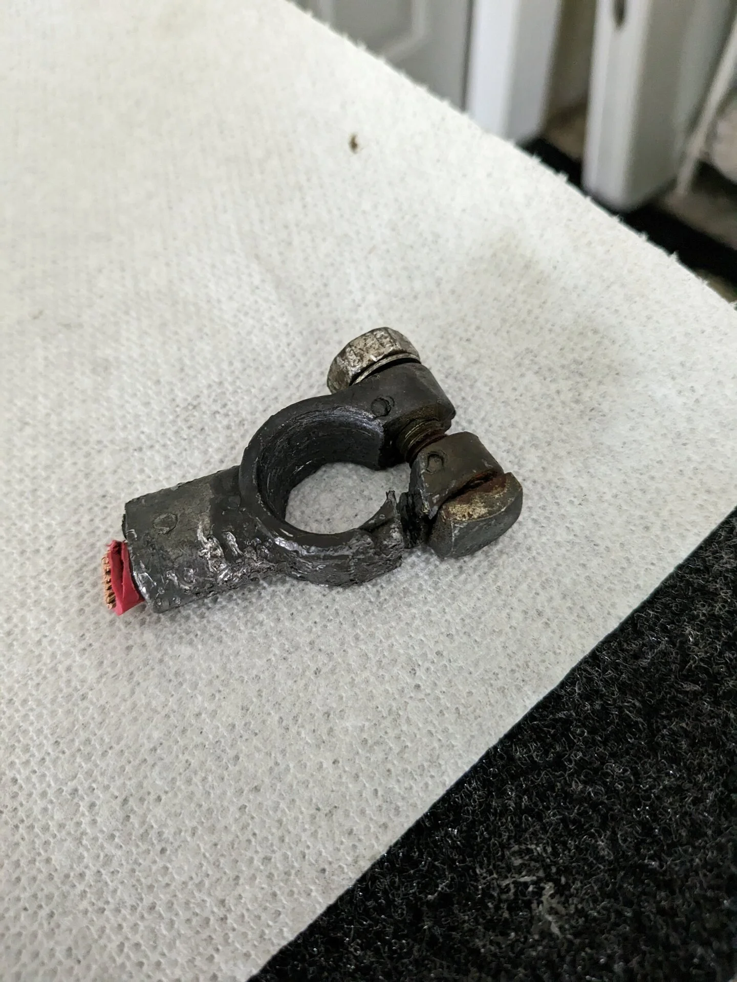

Y'all are gonna think I'm an idiot, but I noticed after swapping both those fusible link wires that it was still intermittent. Needless to say my father in-law and I noticed the battery terminal for the positive side is cracked at the bolt when we troubleshooting further.
I guess it really is always the simplest of things. It makes sense that I was seeing the voltage with the multimeter at the battery, but not down the line really.

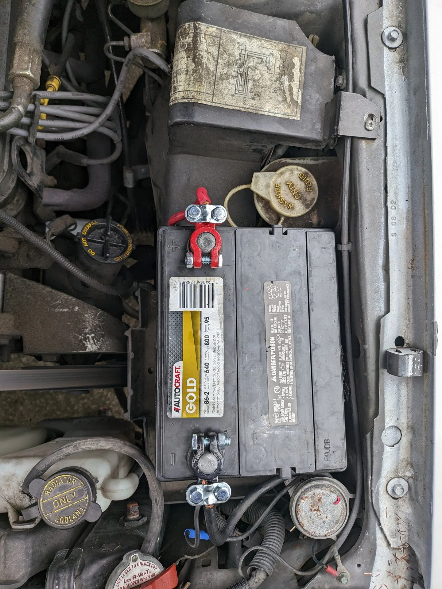

It's fixed!
New terminals for both (just to be consistent) and we're back to everything working as expected. I feel like a fool for missing this initially, but I guess my multimeter was just consistently hitting the battery posts, so I missed the lack of voltage going consistently down the line.
If anyone is feeling like they're having this issue, don't skip this check like I did. Seems like something I should have checked thoroughly off the bat. Lesson learned haha.
