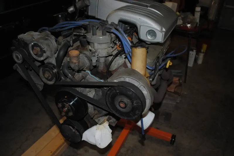

Here's with factory A/C delete brackets, identical to Ford Racing.
exactly what I have.. Get rid of that huge a/c bracket.. Don't add another idler pulley... That just makes no sense in my opinion..
