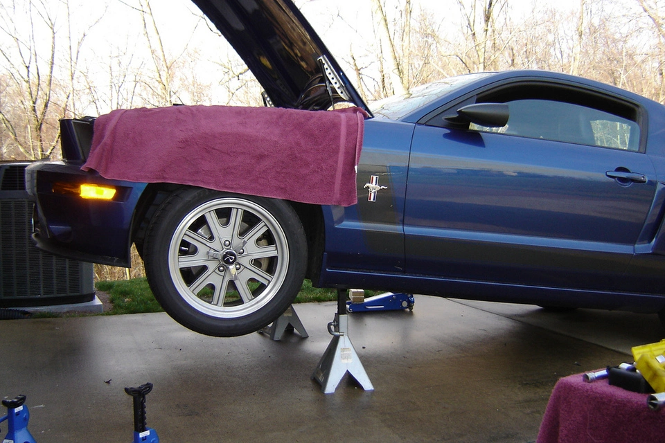

Use the frame supports with a floor jack on the front side of both doors. You can't miss it. Place your jackstands according to what you will be working on. Hopefully you know to put them on something that won't break :D

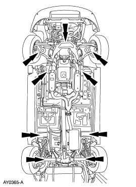

Yep, for an oil change, just lift the front. Our drain plug is at the back of the oil pan. Here's a diagram of jack points. Enjoy.

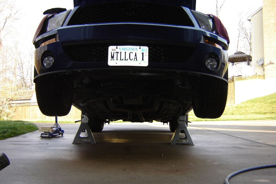

While doing any front related work, I use the frame rails (third arrow from the top) to place the jack stands.
That is where I had them for the LT install and it was up in the air for over 9 hours and the car never budged. Of course we used ones that were rated at 6000 lbs/each!

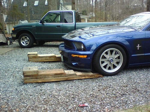

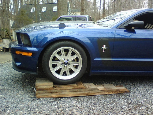

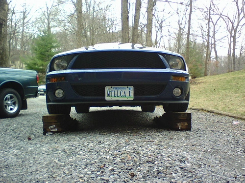

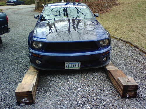

For minor work, such as oil changes, I made a set of ramps. It puts the front end up 7.5".
I had to add a scrap piece of wood near the top as the GT500 front wouldn't clear my double stop block as my GT w/ CDC Classic Chin Spoiler would.
+1 on the ramps if the car is not lowered those big black plastic ramps from wally world I had worked great! just drive up there and change the oil that simple.
