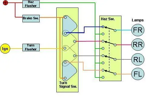

Need a solution for a non stock emergency flasher switch for a Painless harness. I'm not going with a used stock switch or a replacement stock switch...too expensive. I want a 'kinda' stock look, toggle switch with bracket. This is my next project on the Painless installation, along with finishing the instrument pod. I've gotta lead on a Digikey switch that should do the job, (DPST) Double Pole, Single Throw switch.
1. Has anyone successfully done this and if so how?
2. Where was the original switch installed on the '66 Coupe, I think that this was the first year for this option. I would like to install mine in the original location if possible....mine is a '65 Coupe
More soon............
