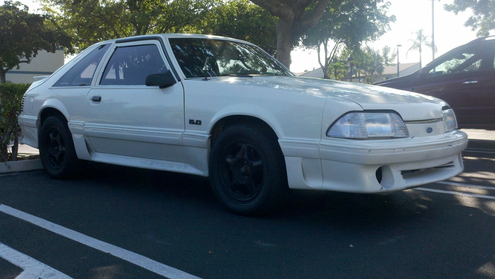

PLEASE post pics of this work of art Skywalker, er troll. Entiendes?

Its just a foxbody not too bad at that. Project car stage right now. This cars older than me by 3 years. What you dont like mustangs?

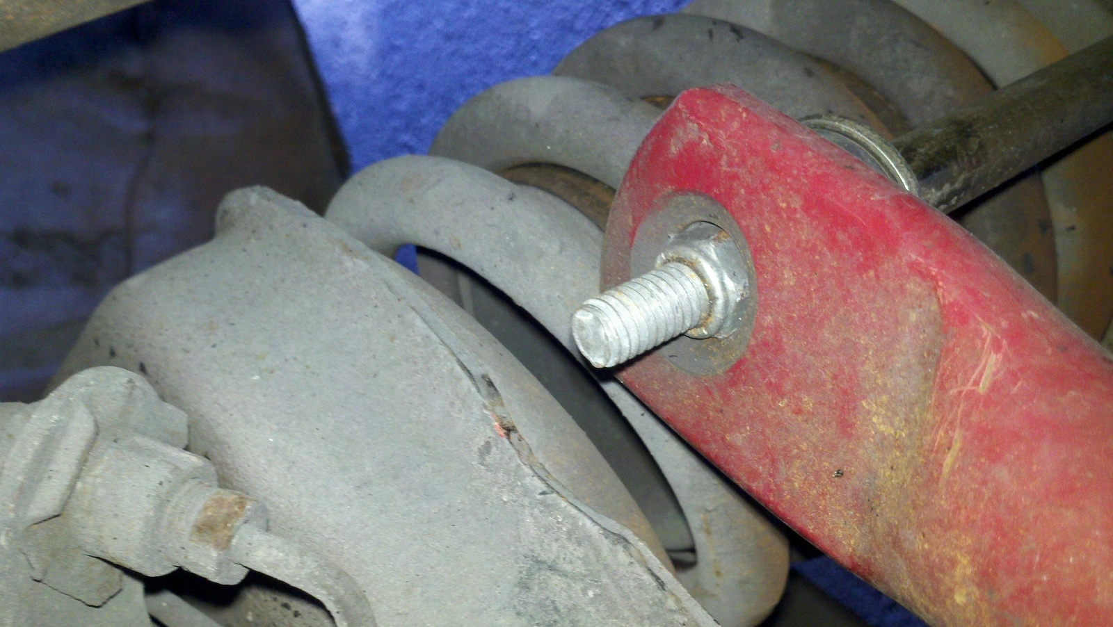

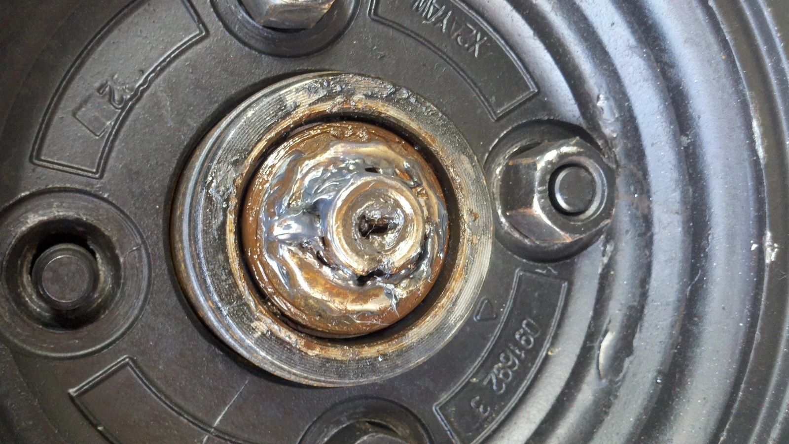

That sway bar is FUBAR. What's with the camber on that wheel? You also have the wrong style lug nuts for that rim. See how the holes are chamfered and your lugs are square. Spend $2 and ut a dust cap on that spindle en or you will eat up your outer bearing and have more problems.
Do you have spacers behind that rim as you don't have much thread exposed.

that swaybar should have a rubber isolator and cup washer between the bolt and the bar

WRONG NUTS!!!! ...should have the round edge, it's a start.

Ok good!! Spacers no. I took off the dust cap to take the pic i put it back on. As for the swaybar the endlink was too short. I got other ones, and still it wouldnt fit with the bushing. But the other side is all good
