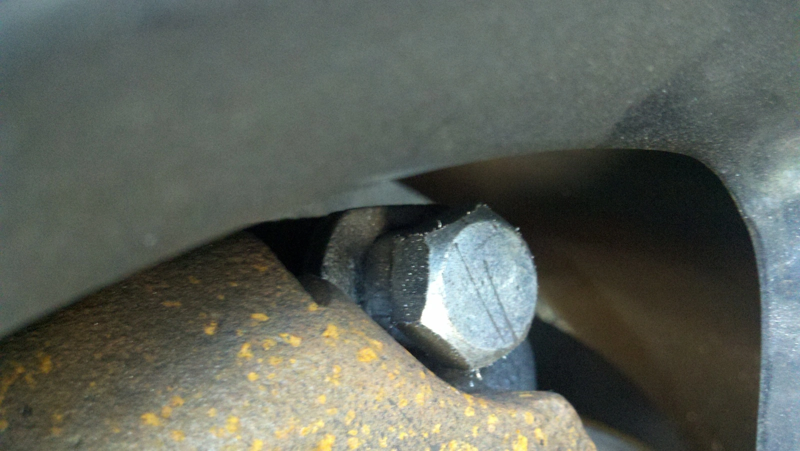

Ok so i was driving to work today. I didnt even get to the corner when i realized that today its undrivable. I called in carsick and now i have all weekend. I was driving when all of a sudden i realize the car was drunk... ok so i looked at the wheel the center cap was loose again .. and the grease was hot. To compare i also took off the center cap off the good wheel and it was tight af and the grease was cool. More importantly i noticed that the bad wheel was NOT STRAIGHT i could tell by looking at the center bore and spindle and the lug threads.
pull that wheel, unhook caliper,
center nut - pull out the cotter pin remove nut and pull the hub. clean everything and post pics.... need to determine wear
how are your tie rod ends, are the ball joints tight? try and move wit ha pry bar.. dont mess up the rubber housing..
Lower caliper bolt loose

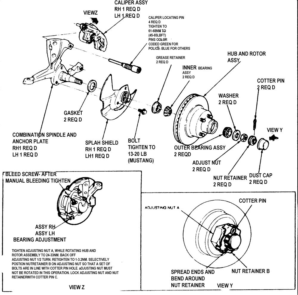

when you did the brakes and resintalled the rotor, after you reinstall the inner and outer wheel bearings and put the washer and castle nut on. before you install the cotter pin, you needed to adjust the preload on the wheel bearings. If they are too tight you will burn them out- too loose and the rotor will wobble and the bearings will get torn up. You need a torque wrench- if memory serves me right you torque them to 15 then back off and then to 5- but do not quote me on that. Do some homework and look it up.

Go back over eveything you did. Get a manual- go on the net. lool up the torque specs for every bolt- buy, beg, borrow a torque wrench and tighten every damn nut down to spec- including the lug nuts.

Edit: just saw that caliper bolt- you snapped it off- the other half is in the spindle now.

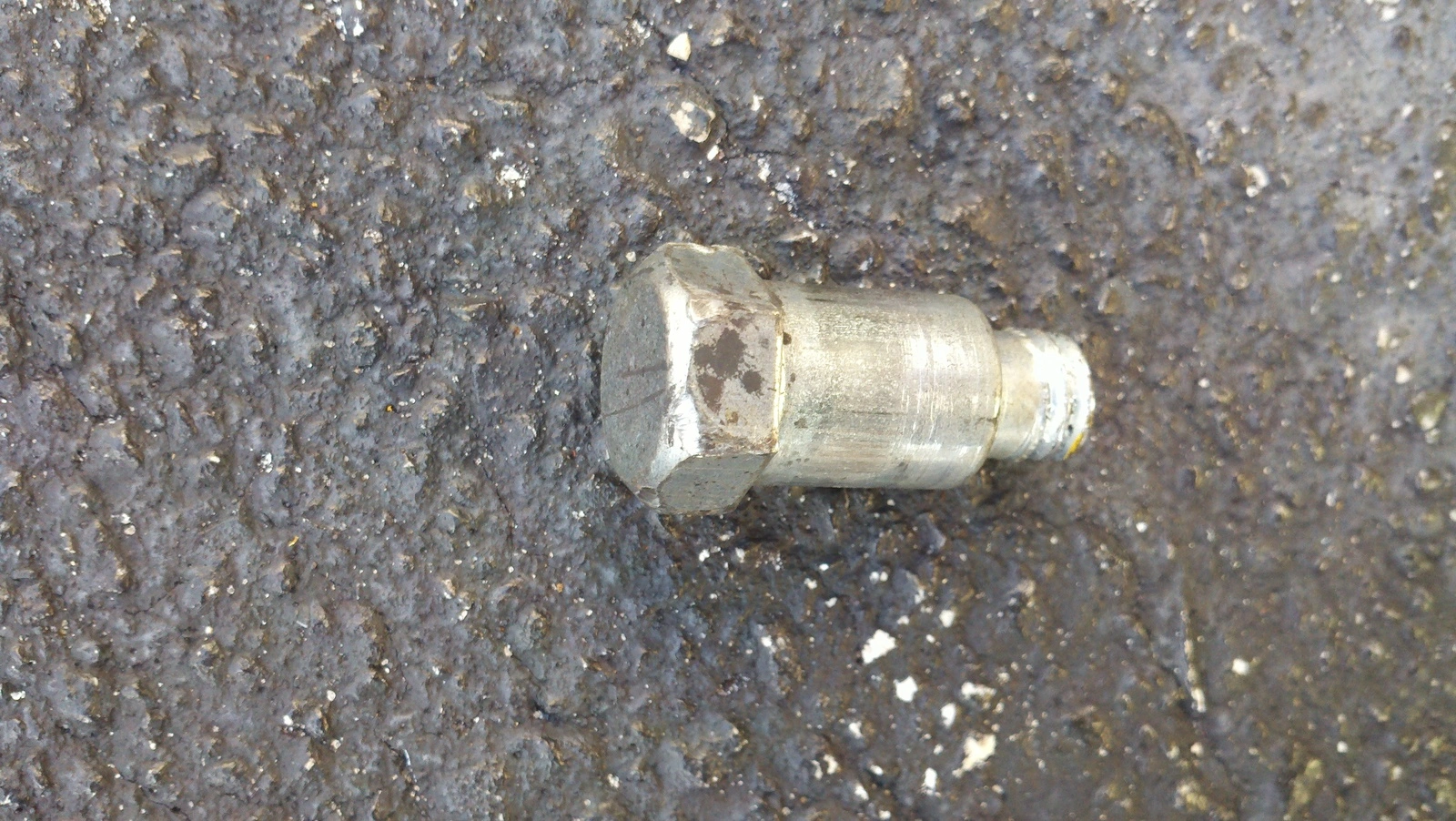

Yea it broke. But the other wheel seems fine guess i got lucky there? I just used simple tools
that bolt must be crossed threaded in there,now you probably have to drill and tap it?....never mind the original problems....good your trying to do the work yourself but buy a manual and read it carefully before you do anything else to your car!

Far from hit...lol He just reminds me of that character. 99% arrogance and 1% knowledge. At least he's starting to listen. That car is outright unsafe to drive and now he snapped off a caliper bolt in the spindle- time to get the easy out and pray he doesn't screw up the threads on the spindle. Judging by his mad skills so far, I'm not too optimistic.
Oh oh oh OReilleys, Napa or your salvage yard when you get the other little things, the right size drill bit (I would use a left hand twist one, but standard rotation is OK in this case) and the easy out.
