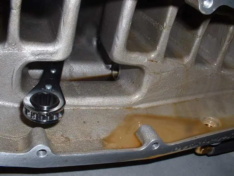

The car is also hard to start, and idles like crap now. I pulled the side of the edel. performer's upper intake and seen the light brown oil we all dread (see pic). I drained the oil and it actually looks pretty good, but you can just tell that there is some coolant in there, but it is still dark brown. I was able to drain out about 4 quarts, so there is not excessive coolant in there. I'm guessing that it is a upper intake gasket leaking coolant into the lifter valley and getting sucked up into the intake making the oil in the intake look very white, since it is so concentrated right near the PCV valve. :shrug: Maybe that's why the oil in the pan wasn't very white (or light brown).

definently something wrong with the cooling system. my money is that it ISNT a head gasket. the overheating of your car at an extreme rate is the first sign of a blown head gasket. also, when a head gasket is blown, the color of burned antifreeze coming from your tailpipes would be a sight for sore eyes. in a way, you can sleep easier, but not that much easier.
Looks like the ports on the Right are the problem cylinders...the Left is nice and Black or normal...she's definately getting water somewhere...

I'm thinking that it is sucking it up through the PCV and coming out the hole right there in the plenum. The rear ports had a slight coating of this oil mix while the fronts did not. I'm guessing that it's from the oil coming into the intake at that rear hole and thus getting sucked up into the nearest runners, which happen to be the rears. The oil I drained was had much less concentration of coolant, as it was much darker in color. Perhaps the intake gasket is leaking into the lifter valley and causing a higher localized concentration (lighter brown) then what the rest of the oil was.
Do you think that the oil mix is coming up the runners in reverse?

The chocolate milk colored stuff in your intake is a sign of oil and coolant mixing. Looks to be coming from 5,6,7,8 runners. Do a compression test tomorrow. If the lower intake did not seat there would be leaking by the PCV (back) or dripping onto the timing cover (front). The fact coolant is getting up this far means there is a bigger problem. Coolant will foul out spark plugs. When I blew my head gasket 7 and 8 fouled out quickly.

The blue rubber ends suck but if they were leaking oil would be running out where they go. By that picture clearly oil and coolant is mixing which is making that coffee looking liquid right above the PCV connection line. It must be getting sucked up. I would do a compression test first thing. This is an internal issue. Coolant in the cylinder walls equals damage.
