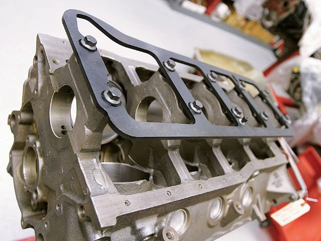

Some people might suggest a girdle, while that might seem logical. It doesn't really help the mains from splitting, more or less just holds them together while they split. The Darts are good due to thick cylinder walls, better oil flow, and four bolts on the #2, #3, and #4 mains.
Hm a girdle huh, that's a new one for me. I see the concept though, pretty much holds the "shrapnel" in?
*waves magic wand on above post to fix the quote*
They help spread the load caused by piston/rod deflection as the crank rotates. This is nice for you high compression solid cam types that like to turn a lot of RPM or folks who have a turbo that's builds gradually.
Torque is what breaks these blocks. Making HP very quickly. It's starts in the lifter valley and if allowed to continue proceeds right through the mains.
Not long ago main stud girdles were all the rage. Trouble was that people were using them for the wrong reasons. Drag cars need to make a lot of HP quickly. Torque... Take a small cardboard box and twist each end in opposite directions slightly. A girdle will not stop this. The thing would have to be two inches tall even to begin.
It does help keep the two halves together for sure. hehe I don't think that this was its intended purpose either. :rofl:
Stud girdles do have a purpose but it wasn't supposed to keep the block from twisting.
Where'd you learn that?
Ha nah about the girdles and sht
Some trial and error, a few magazine articles, discussions here and other forums, but mostly from a white paper that accompanied the girdle that I bought from CHP many moons ago.
It's what started me into looking to see what they were actually good for. I'm pretty sure I still have the girdle. I was going to use it right up until the point where I ordered a Dart Sportsman.
Pretty sure I have a set of lifter valley girdles lying around somewhere too.
Reactions: 85rkyboby
I'm gonna have to do a google image search. Were they pricey and have you heard of anyone using one recently?
This thing? Looks a lil hokey. Not what I saw in my minds eye.
