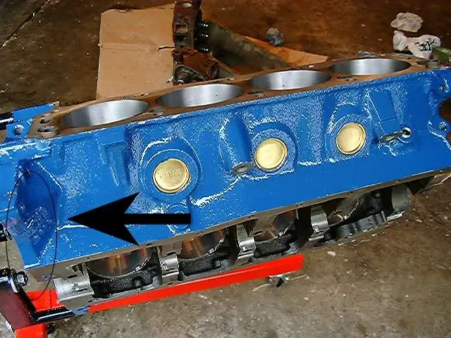

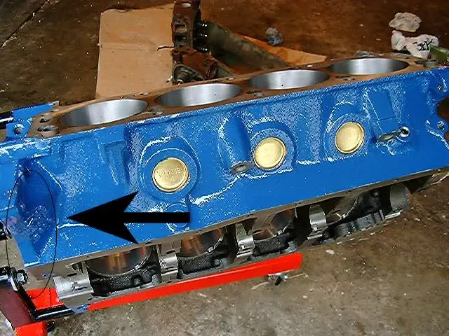

here is a pic of where the casting numbers are. you don't have to remove anything to see it, just have to be under the car.
Sounds like a '79 or older block. That particular oil pan was used only for '78-'79 Fox body 5.0's and '80-'81 255's in the fox line. The dipstick was moved to the bolck in '82, along with a new oil pan without the 'stick provision.
If my memory serves me correctly, there should be a number stamped on the lower side of the block near the rear freeze plug on the 79 and older blocks. If thats the case the number will start with a C or D with a number directly following it, D for a 70's block C for a 60's blocks. Like mine had a C9 which is a 69 block. Since you don't have a dipstick provision in the block, Its definatley a pre 79 block.
