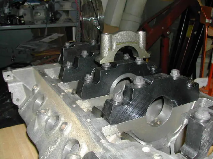

I split my stock block clean up the middle right through the cam bearings with all forged internals. I was at about 400hp to the tires then. Even had a main girdle on it. The thing is if you try the stock block like I did what if those nice forged parts get spit out onto the road when it lets go? I was lucky when the block went it lost all oil pressure and I shut it off. The pic is my stock main cap on top of my new block when we built the motor last year. By the way 89 to 91 came forged from the factory before the bean counters stopped them. Mike
so my california 88 doesnt have stock forged internals i was under the impression that the 88 cali stangs had the same stuff as every other 89 stang btw what kind of block is that in the pic is it a modded stock block with 4 bolt caps ?
