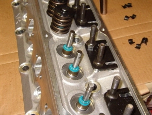

Rick 91GT said:
I use a 12mm socket, to push the Viton seals I swap onto the AFR's I use on customers cars.
Do you have a picture of the viton seals? I have white plastic ones with a metal band going around them and they don't seem to stay in place(rides up and down the valve). These came with the comp cam "package." I also have some black rubber with a metal band and the umbrella ones mentioned that came with the summit rebuild kit. I'm not having luck with the plastic ones so I'm wondering if the ones I have are good enough or should I try these Viton seals?
Fred
i'm assuming these are going into a stock head. I would use the rubber ones instead, they should be pretty snug around the valve guide. i went ahead and used the rubber seals with the metal ring around the top and a metal band in the middle which is open to allow for expansion for the intake side and the regular umbrella like black seals for the exhaust, i wanted to use the intake ones on the exhaust side too since they were pretty snug ont he guide but some people mentioned i shouldnt use them in another board. before i bolt the heads up for good i'm going to ask a local engine builder see what he thinks/has done before about using the intake seals on the exhaust guides, i dont like the way the exhaust umbrella like seals ride up and down with the valve, it seems like they wouldnt protect as well as the intake ones.
