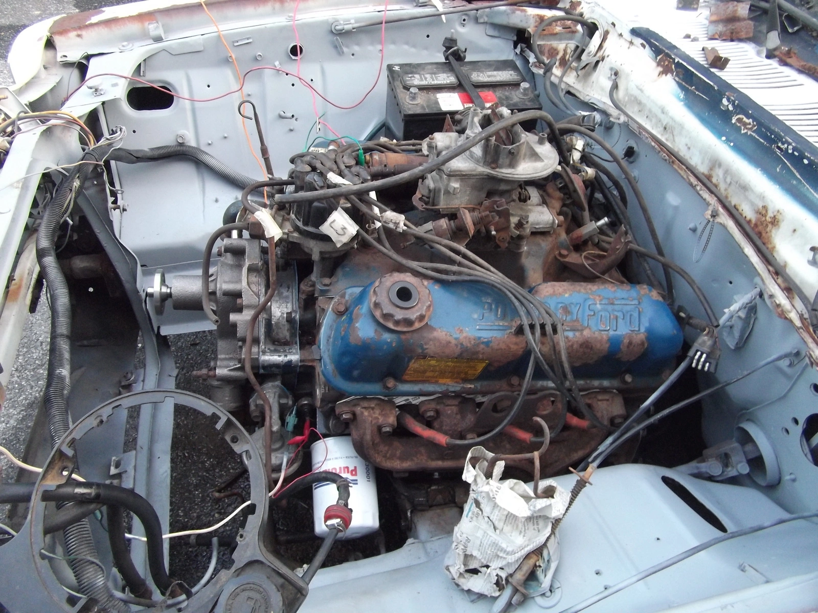

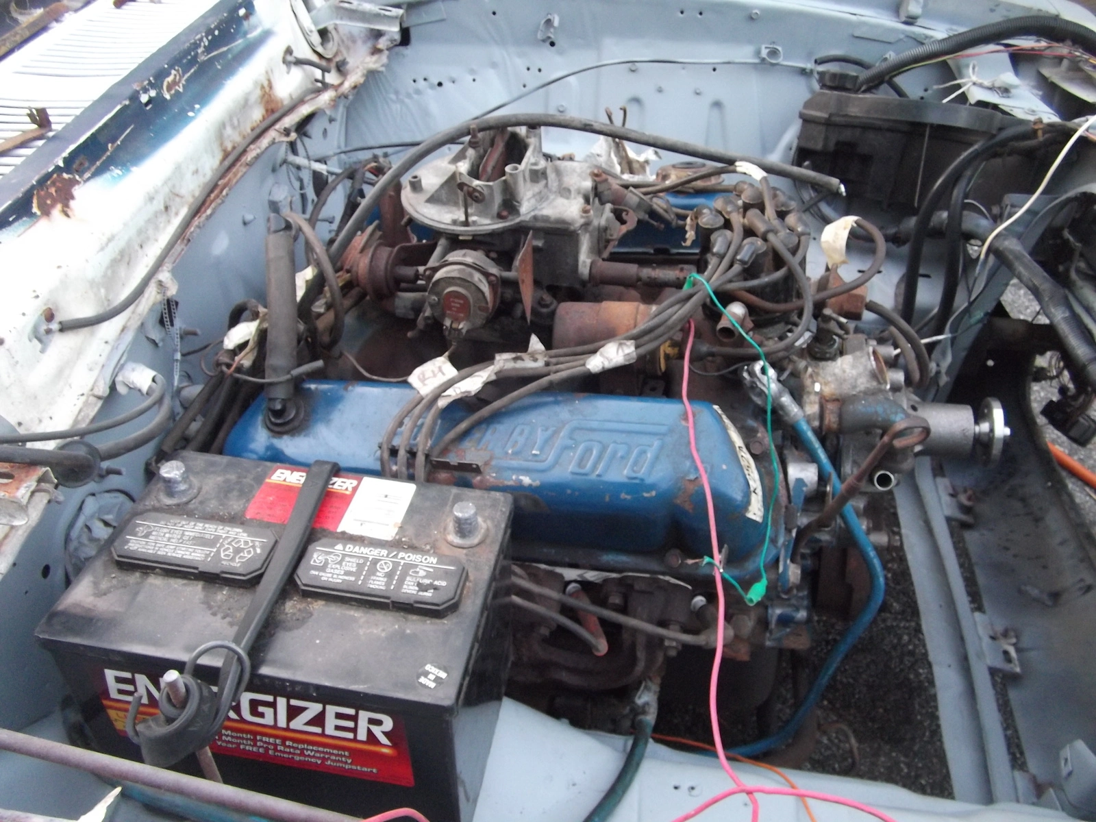

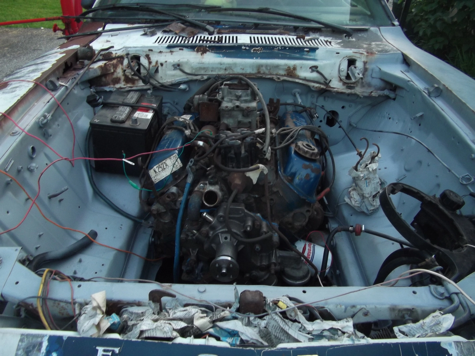

Hey, finally got the 302 in the car! but, it seems as if it is leaning toward the back and it is pointing off in one direction. the front shoots towards the front right headlight. Check out these pictures and tell me what you think. We are using 302 MII specific motor mounts that are shimmed up about 1 in to clear the oil pan. Also a larger bell housing, although no modification was necessary. The transmission is not hooked up yet but I got a bad feeling something is not right.
Thanks for any advice on this one!

so question, are the motor mounts and frame supports on the correct sides, if they are offset for some reason this could be your problem, I don't know this for sure as I still don't have my motor in, but just a thought.
At first we had the motor mounts on the wrong sides, we thought about that when we had to grind to one down to pass the manifold. after we switched them if sort of falls right on the frame mounts (v6 mounts). After taking a good look I am thinking the bell housing is hitting the passenger side part of the fire wall. this weekend I will take it out to put the converter and trans on, I will also bang that out a little. Now it is off to wiring....

From what I understand, the lower mounts are also v8 specific which may be your issue as far as looking twisted in the engine compartment. Although they look right from what I can see in the pics, they may be slightly different. Getting the transmission into the tunnel and attached may straighten your issue out though. The transmission cross member is also non-symmetrical, so it will affect everything as well.

The frame side mounts are different on a V6. You need both frame mounts and engine mounts from a V8. I found out when I did a V6-V8 conversion 25 years ago.
Also, the crossmember under the bellhousing has to be notched for the larger bellhousing. Better off with a Mustang II smaller bellhousing. I found this out the hard way also. :)

Thanks! Yeah, I figured out if I keep the passenger side frame mount in it's place and move the drivers side mount back 1 inch then it will straighten up. I replaced the key switch and it I am able to start from inside the car now. Just need to get to the fuse box... Thanks for all the help on this so far!

Good, sorry I forget to do updates... I mean I was building suspense, yeah that's it. Well ever since I posted this question I fixed the problem. They I did that was buy taking the drivers side frame mount and moving the bolts holes approximately 1 inch backward. That seemed to straighten things up real nice. After that changed the trans filter and gasket and now my wheels turn! To bad the are basically junk... Since then progress has slowed. I made a trip and picked up a well needed passenger fender for 25 bucks! Just today I got some more parts, basic stuff like fuel pump, starter relay, etc. Also i'm going to start my "high performance exhaust" tomorrow. High performance as in something other than open manifolds. So before I put the exhaust on I will make a video before and after and do an update of the car. For now i'll post a link to a video I made a while back before winter right after we got the v6 out! Thanks for asking!
