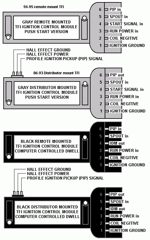

High speed miss on a warm engine
Revised 24 June 2019 to add new source & part number for TFI removal tool .
The TFI module mounted on the distributor is one of the culprits for a high speed miss on a warm engine. The other suspect is the PIP sensor inside the distributor. If the problem does not occur when the engine is cold, the TFI module or PIP is definitely suspect. Dumping the codes may help determine which one it is. You may need a special socket to remove the TFI module, but most auto parts stores will have one for $5-$7.
It is not uncommon that the replacement parts may be defective; TFI modules made by non Ford manufactures seem to have a high failure rate.
Be sure to use plenty of the heat sink grease on the new TFI and clean the old grease off the distributor.
Lisle P/N 64650
See https://shop.advanceautoparts.com/p...Z0kH8DTh2LmTcgnmc_E4aAuCIEALw_cB&gclsrc=aw.ds
attachments\.586550
diagram courtesy of Tmoss & Stang&2Birds
tfi-module-troubleshooting-gif.586550
