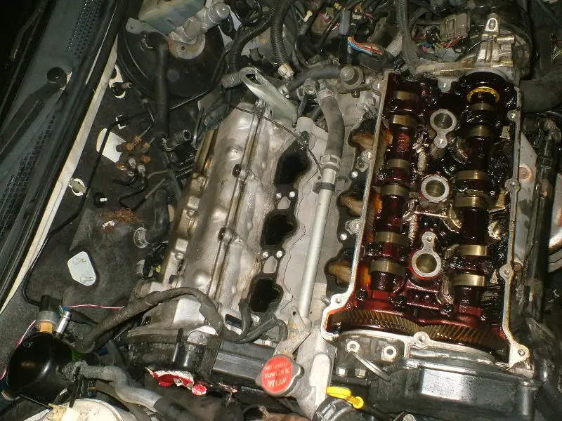

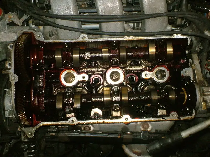

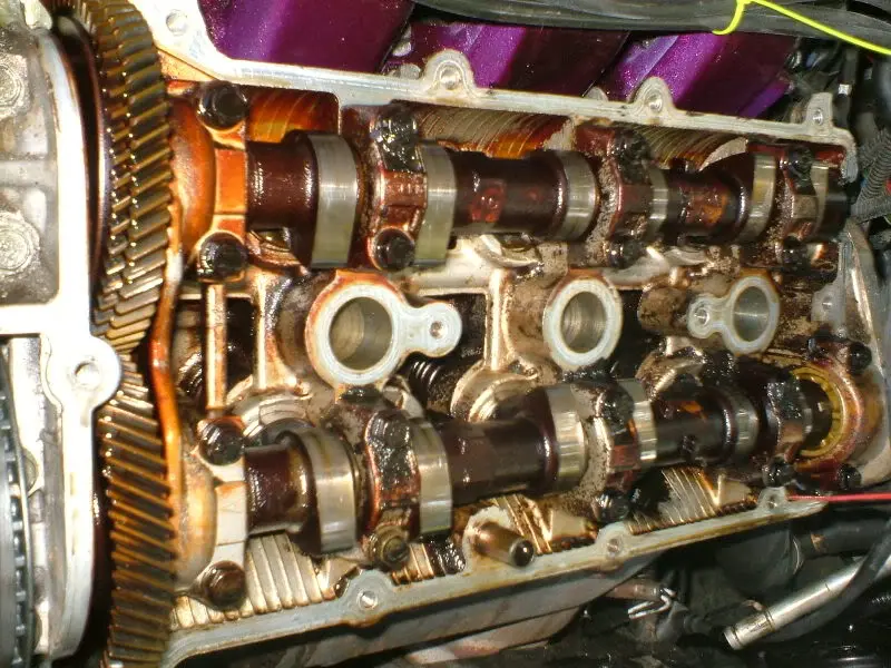

once i find an oil that works... i dont change...
Ive been using the motorcraft synthetic blend in my focus and my g/fs focus... my grandfather uses it in his honda and f150... My cars never burned oil or started to even after putting 40k on the focus... i dont lose a drop..
The only oil i have ever had problems with was quaker state and i think Pennzoil
I was using quakerstate in my probe... and look at it...
cleaned out gunk... flushed and used gtx...
I think thats much better...
My mustang had 225k+ on it when i pulled the engine to clean up my bay... you should of seen how clean it was under the VC's

Adam whats the history of the probe and the timeline for those pictures?
Adam95GT
Aug 14, 2006
2,564
Burlington, NJ
Jan 9, 2010
#19
  • Jan 9, 2010
  • #19
3 months in between pics about... Engine was a low mileage JDM KLZE.... but from my understanding the people in japan dont change oil often... but i looked under the VC and it wasnt that bad when i got it...
