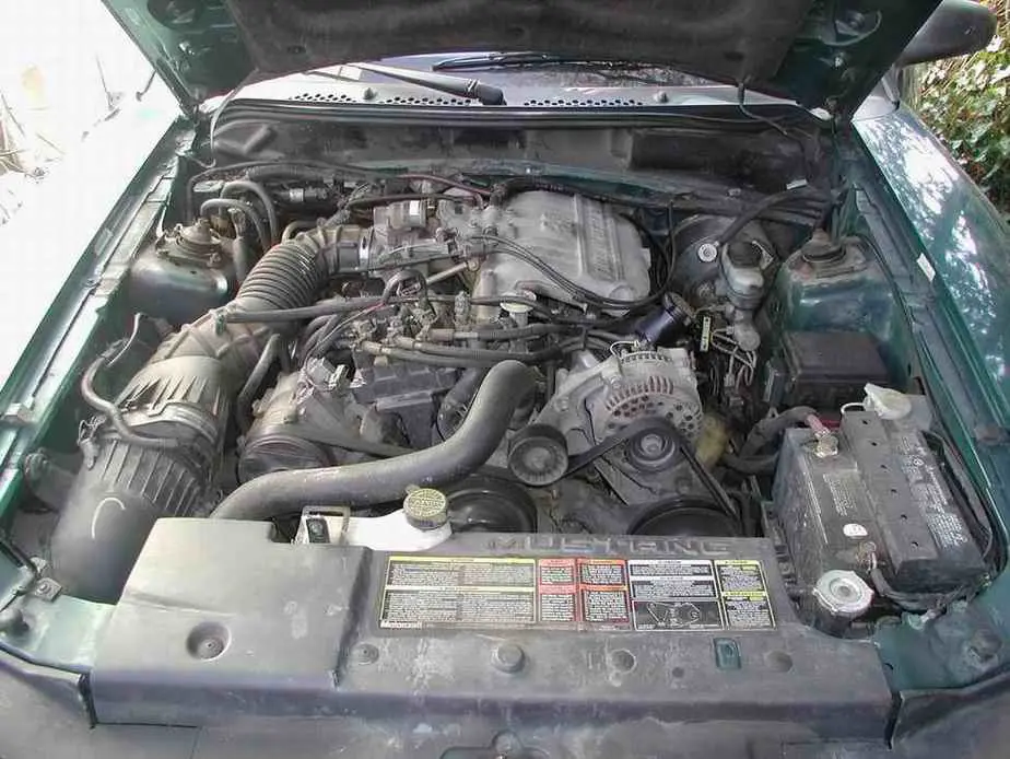

engine picture, how to get more HP?
asdad
this is as big as i can get it to fit the picture max size
synizm said:
whats an underdrive pulley?
im told im not getting more than 5-10hp out of coldair-exhaust
That's right. CAI + exhaust will net you 5-10ish. Each one on it's own is good for no more than 5hp at best.
An underdrive pulley is basically a smaller crank pulley. The smaller pulley turns all of your accessories (water pump, AC compressor, alternator, PS pump) slower, which frees up a few horsepower that were previously being leeched from the engine.
Of all the boltons (exhaust, CAI), the pulley probably nets you the single largest gain. You'll probably see 5-7hp at the wheels from the pulley.
Most people generally don't observe any ill effects as a result of driving the accessories slower.
If you're looking for big gains out of the 3.8L, you are going to be sorely dissapointed. The 3.8L is a pig. I've just given up on the power-adding mods because they are a huge WASTE OF MONEY! I have MAC CAI, MAF, TB, and true dual exhaust and the thing still moves like a slug. I'm just saving up now for a 99+ Cobra
