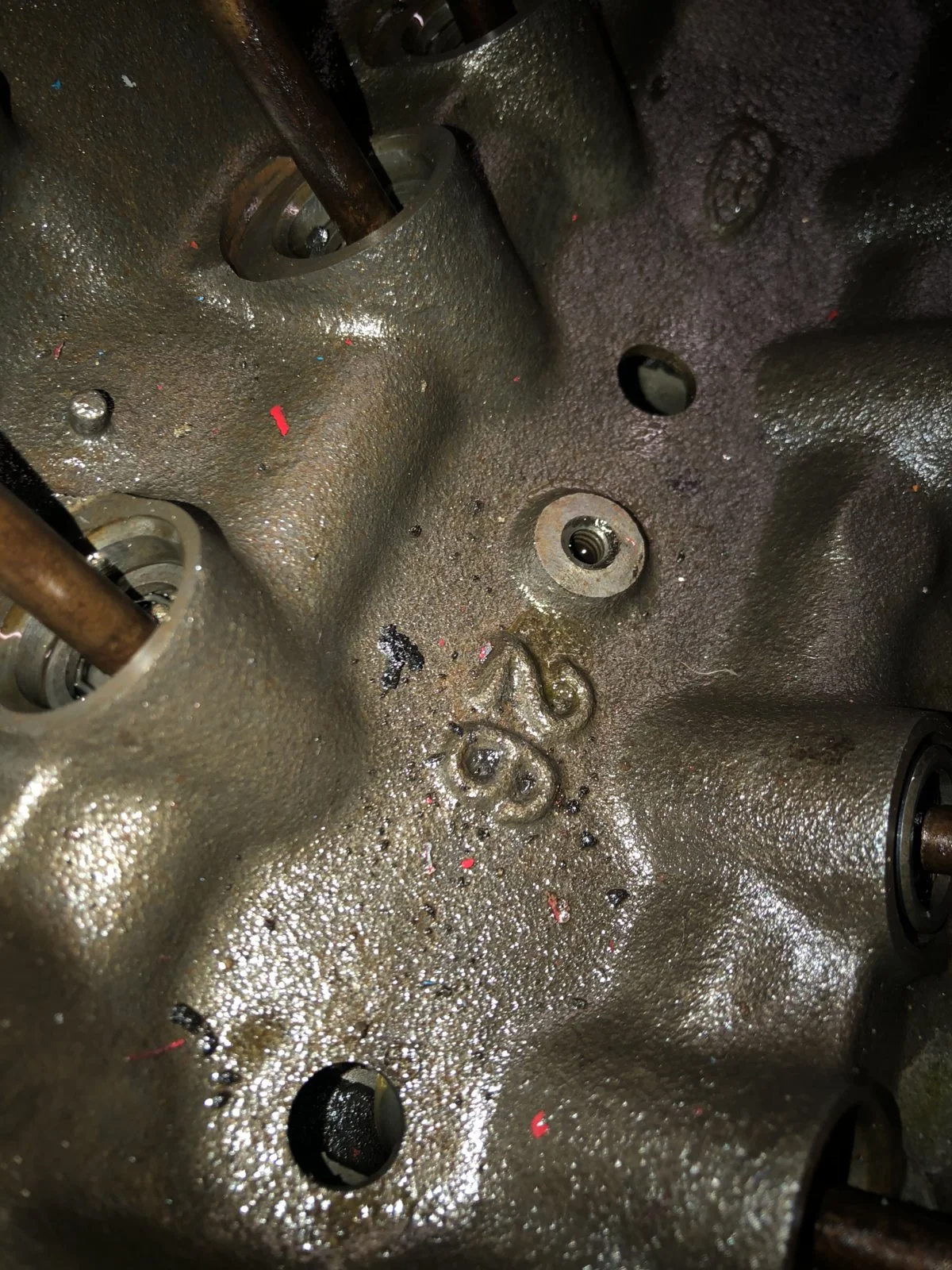

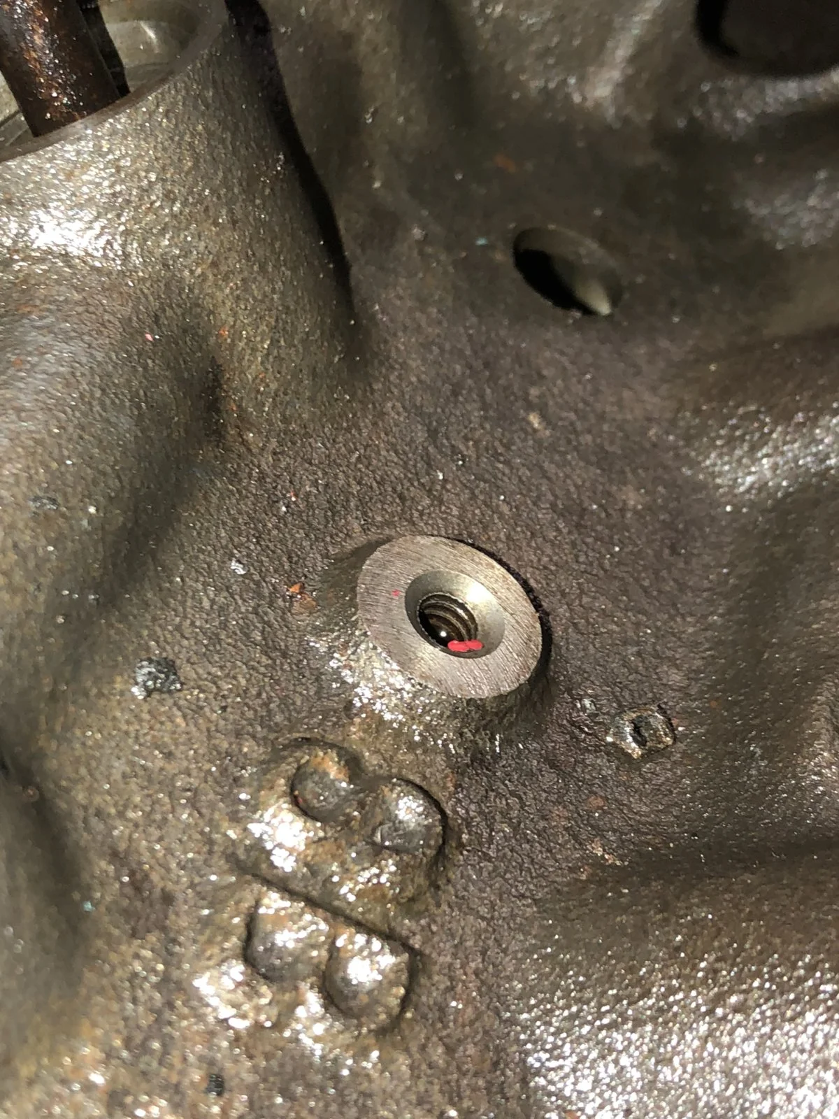

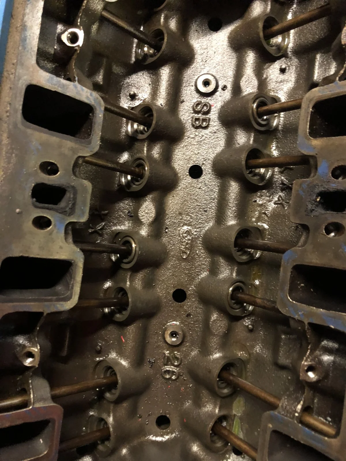

1. What are the small threaded holes and non threaded holes in the top of the block used for as there was nothing in them when I removed the intake manifold (pics 1,2,3)

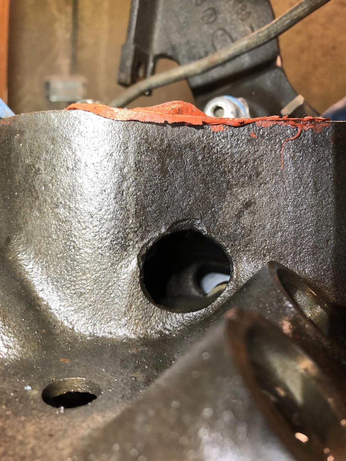

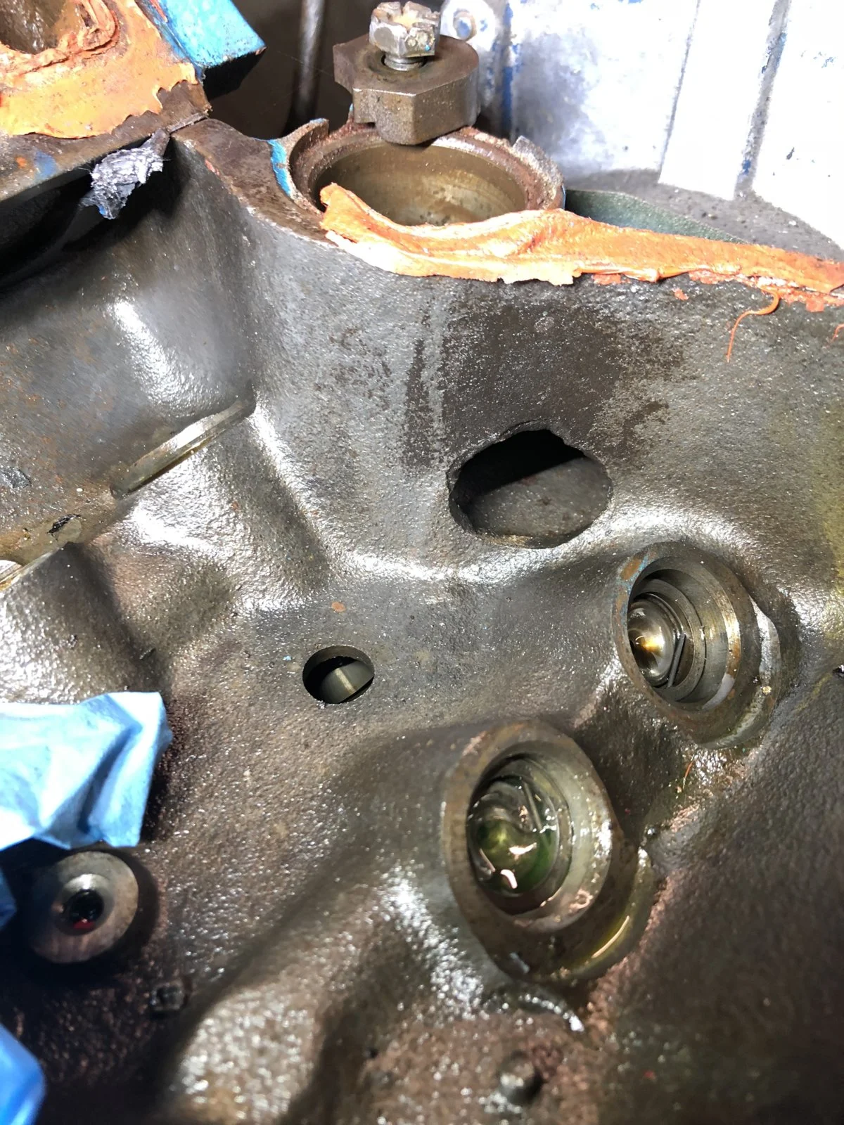

2. Why is there such a large hole at the front of the block by the distributor (pics 4 and 5)

it looks to me like those drilled holes were for a roller cam setup, as far as that hole in the block im not sure but it is supposed to be there. id say get the heads ported then throw a performer rpm intake and that carb and sh will have a little pep. if you want more power swap over to a roller cam and gt40 heads, the heads you can get at a pick n pull for 35$ each. they will bolt to the 302 block and will add 30hp ish.
That hole is to relieve oil spray to keep distributor / timing chain from seeping.
