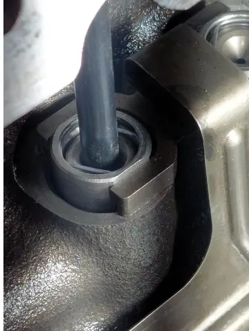

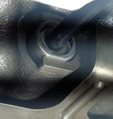

Here's where I'm currently at. The comp cam 6.300 pushrod arrived. It actually measures 6.320". The original pushrods that were in the engine measure 6.240" and the long one I bought from local autozone is 6.395"
Currently, I"m fighting 2 things at the same time-- finding the right pushrod length and getting the lifter preload correct. If I understand it right, both are related-- if the pushrod is the right length, the preload will be at the correct torque within a 1/4-1 revolution of the torque wrench between like 18-22 ft lbs.
The lifters have no oil in them. Just the spring as they came from the factory. Rockers are OEM stamped rockers.
With cylinder number 1, both intake and exhaust valves closed and the lifters at their bottom, I tried different pushrods again. One thing that is still subjective is 0 lash. Some say move the rod up/down and tighten rocker until it stops moving, that's zero lash. Some say tighten until the pushrod stops spinning.
What I discovered is, since I have my lower intake off, I can see the lifters. In fact, since they don't have the oil, I can easily press on them and see the spring within them move up and down. So, to get to 0 lash, I just tighten the rocker until I can see the lifter cup that holds the pushrod go down. Once it goes, I bring it back to the top-- which is zero lash, correct?
Given the above way of finding zero lash, with OEM pushrod at torque, I can still move the rod up/down-- so that one is out.
With the long one from autozone, the 6.395", it takes me like 2 revolutions of the torque wrench to get to 19 ft lbs, so that one is out.
With the Comp Cam one, I seem to be reaching 19 ft lbs consistently at about 3/4 turn. I've tried it on 3 cylinders, on both intake and exhaust on each one. 3/4 turns is within spec, so I should be good ordering those pushrods, correct?
Here's how the lifter looks at 0 lash:
Here's how it looks after 3/4 turn preload of 19 ft lbs:
Sorry, it's late and those are the best photos my phone would take.
Thoughts on getting to zero lash with my method? Seems more repeatable then feeling the pushrod.
