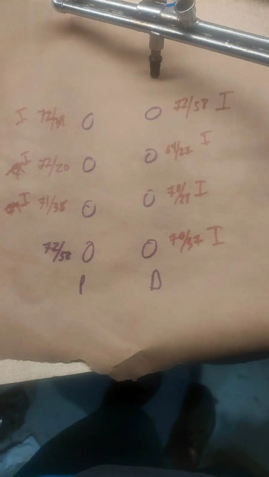

Really want to add oil and prime the engine, but wanted to do a leak down test (and try my new set) first. Did not expect it would be this hard to find an adapter that screws in to the P heads highly recessed spark plug holes Got one more trick up my sleeve. Hope it works soon
JulianR
Jun 13, 2016
182
46
38
May 23, 2024
#314
  • May 23, 2024
  • #314
So here are my latest troubles in paradise. I bought some "spark plug non-foulers" from autozone for the explorer and was able to hook up the leak down tester hose to the spark plug hole.
Testing about 4-5 cylinders, most of them were at about 50% loss and I think they all had air coming out of the Intake runner. (I haven the intake manifolds off) I did make sure that I was on the compression stroke and at TDC. When the hose was hooked up to the cylinder, I rotated the crank until air came out of the hose, then on to TDC from there. The most input PSI I could get, for some reason, was about 65-70, though at the compressor it showed 100. The output from the cylinder would show 30-45psi. Only the first cylinder had decent numbers, the rest, I could feel the air gushing from the intake runners. I plan to re-do the test and actually write down the readings on all cylinders, but that first crack at it didn't look good.
Doing some research, people suggest these readings could be because the valve could be burnt, bent, or the timing is off. Now I did get these heads of marketplace, but they were advertised as bolt-on and go.
I rebuilt the heads as you recall myself, cleaning the valves and lapping them. Springs are the TFS stronger springs as well. Although the lifter preload is set, I still don't have oil in the engine, so the lifters aren't keeping the valves open. Obviously, none of the valves looked bent visually, or I would have caught it. There was no damage to the valves either. Although I don't think I took a picture of the timing chain I put on (new), I do recall making sure the timing marks lined up. During the leak down test, the long bar on the crank did try to move and I had to hold it-- so there is compression.
What are the chances both heads have issues with valves not sealing, especially intake. Also, I tried turning the engine over by hand, at low psi, to see if the air in the intake runner would stop hissing and seal (i.e. timing is off) and there was no point when it'd seal.
Any idea what's wrong?

You are cranking the engine over with the starter when checking the compression right?
You do not need the intake manifold on there to do a compression test, but is it on there, or off of there?
Are you trying to start the engine or just looking it over or testing?

The engine is still on the stand. I'm not doing a compression test. I'm doing a Leak Down Test. Cranking by hand until TDC of the cylinder i"m testing.

Just tested all cylinders with the Leak Down Test and here's how the values came out. The picture is looking at the engine front-- so left side is passenger, right is driver. The top numbers are the input PSI, bottom numbers are the cylinder PSI. All of the cylinders leak air from the intake runner. I was able to roll the engine over just enough to seal the Intake valve fully, but right away the exhaust would start letting out air. I am running the TFS stage 1 cam. Maybe it's designed to seal for a split second. I'm going to give them a call next. What thoughts do you guys have?

If it were me I would back all the rockers off and retest. This way you know they are supposed to be closed.

Well, had a moment to play with it. Backed out all the lifter preload, still can't get the intake valve to seal at the proper time.
I ended up hooking up the leak down tester and running only like 20 psi of air in to the cylinder. Enough to hear it but not enough to do the actual test. I then slowly spun the engine around by hand, several revolutions, both listening to the hissing and, since I don't have the intake manifold on, watching the lifters raise and fall. Also, I decided to try it on the the worst cylinder. The one that had the previous leak down test of 72psi being put in and only reading 20 psi staying in.
As I turned the crank, very slowly, there is one very small moment where the intake valve seals and no air comes out of the runner, but, instantly, the exhaust opens and the air starts coming out of exhaust. Even looking at the 4 stroke animations, it seems there should be a good amount of time that both intake and exhaust valves are sealed as the piston compresses the mixture. I don't have that.
Here are some things I'm thinking-- before I pull the head off.
1. The heads came from marketplace with the TFS stronger springs already installed. I took them off during cleaning, re-measured the height and re-shimmed as required. If I recall, most places required 1 more 0.015 shim then they previously had. Could I have messed something up here that would cause my issue?
2. In the TFS spring instructions, it said the keepers for the springs come in 2 bags-- 1 for exhaust, one for intake. The keepers were already on the valves when I got the heads. Could the previous owner have mixed them up? Would that cause my issue?
3. Can the cam be so much defective that it doesn't open/close the valves at the right time? Does that even happen?
Any other ideas? Thank you!
