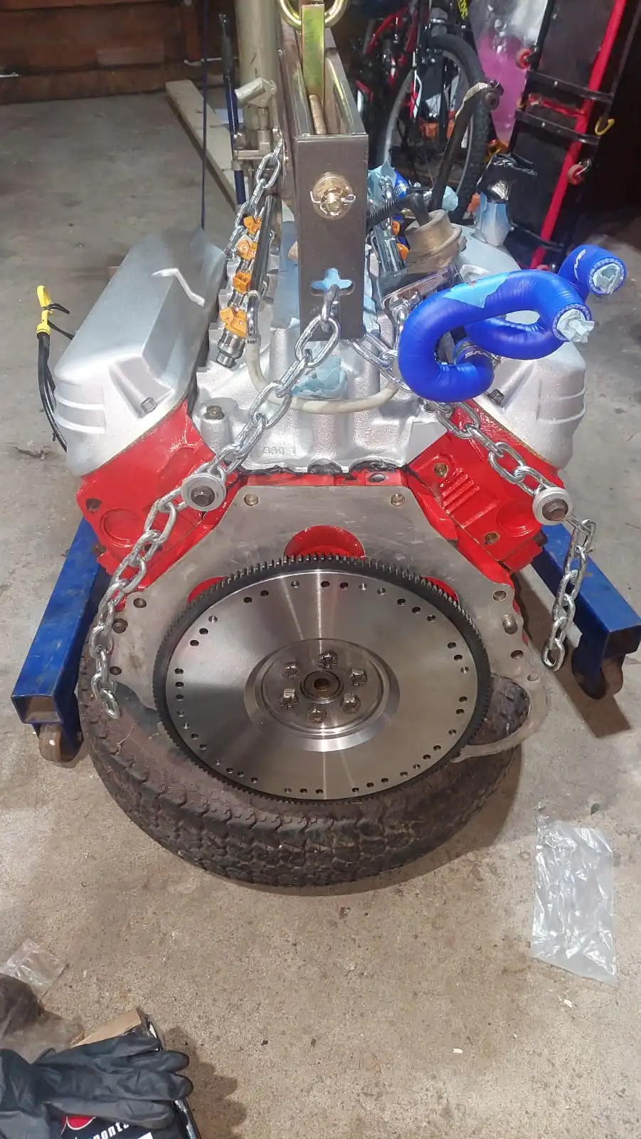

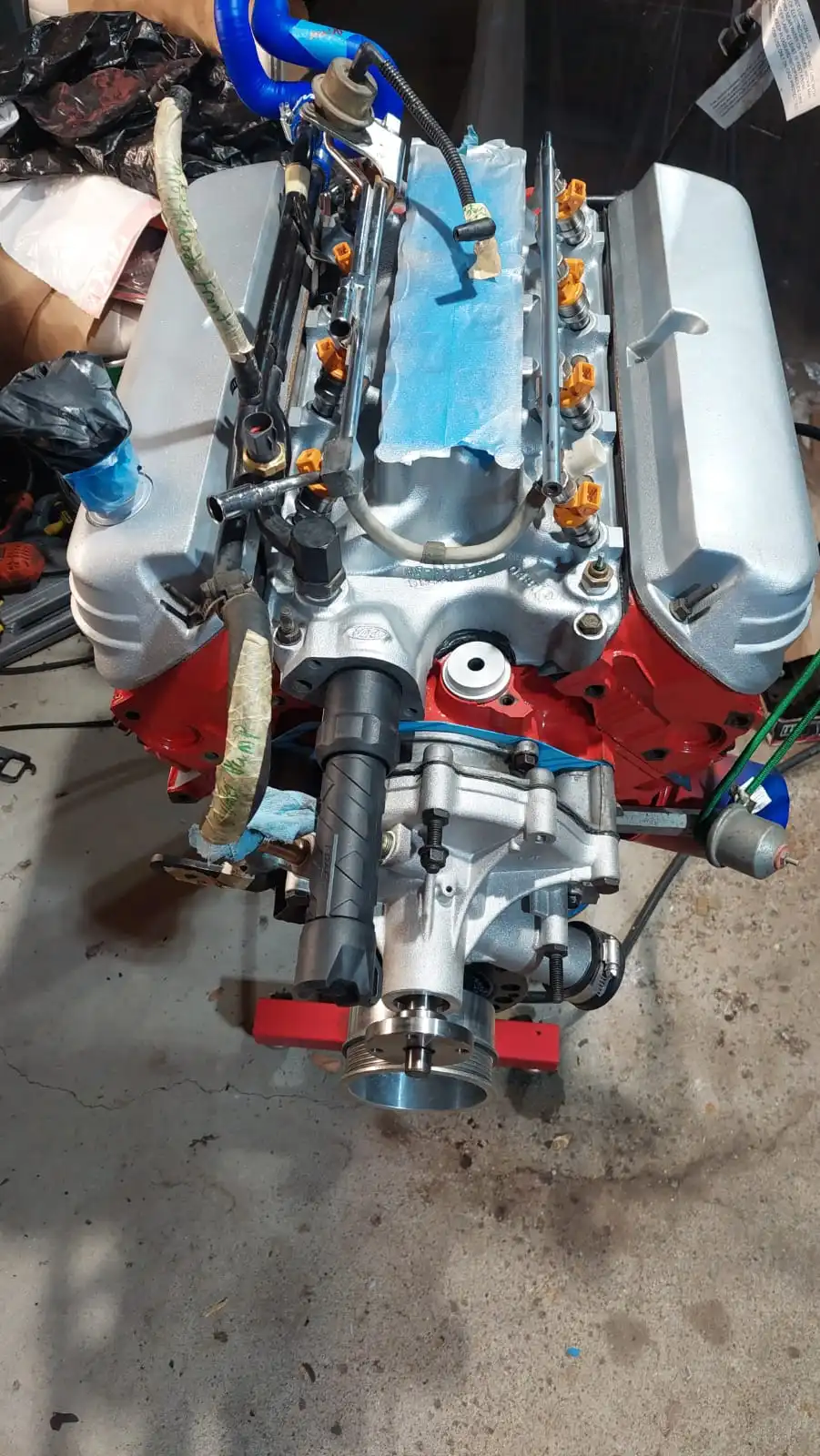

More progress being made. Received the rebuilt fuel injectors with the 4 nozzle spray from eBay. Looked good. Tested each one and the solenoid clicked. Installed in to lower intake.

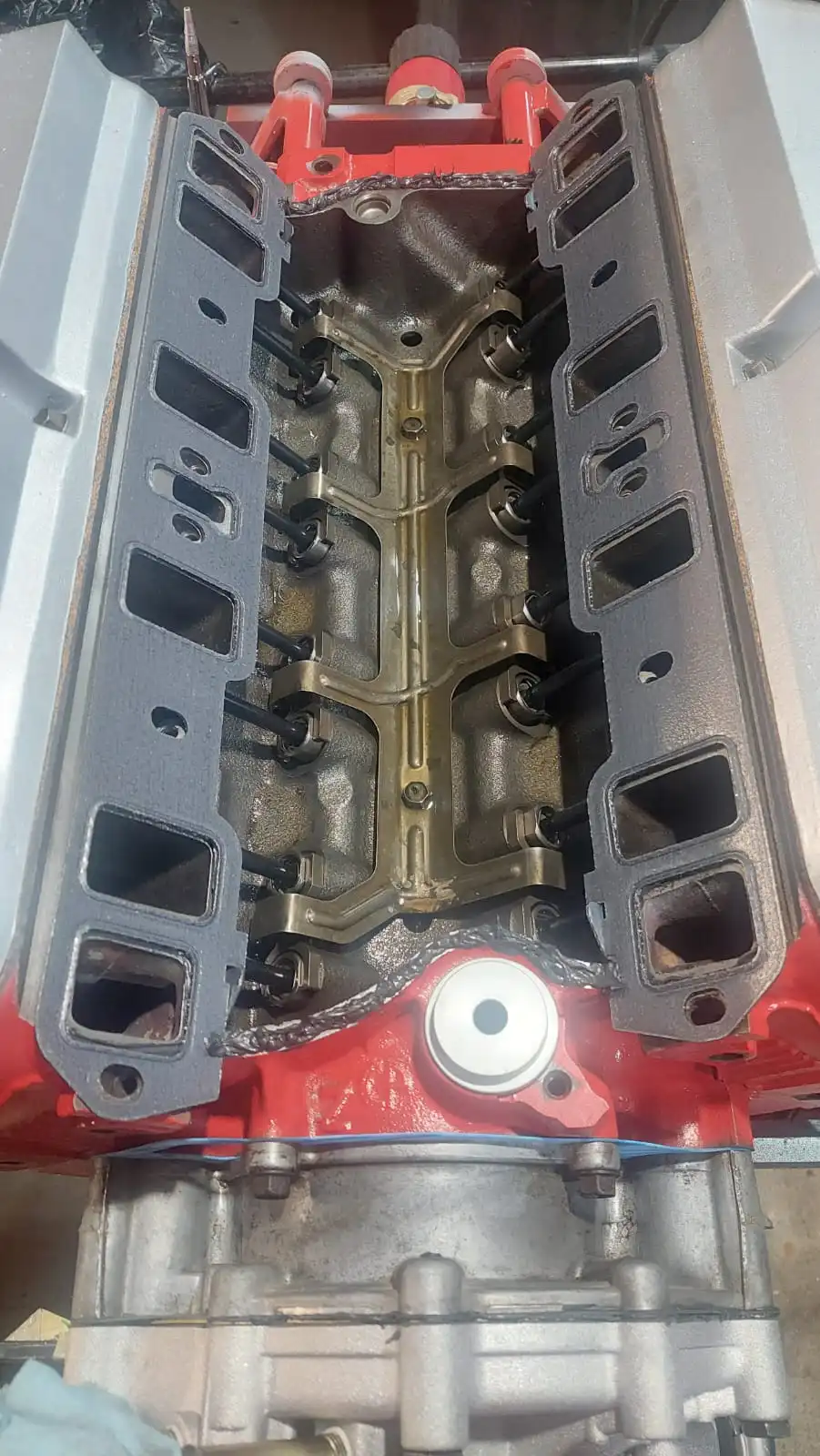

One question I do have-- I decided to go the route of Black RTV on the China walls for the lower intake. I did a 1/4" bead on the block like I've seen online somewhere, placed the lower intake down and it seemed like there wasn't enough RTV. Lifted if off and in fact the bead didn't get crushed. Went over it again making the bead thicker-- maybe 1/2" from bottom to top. Put down the lower manifold, hand tightened bolts. Came back about an hour later and torqued the bolts in 2 steps. About 23ft/lbs on the 2nd round. The question is, the lower manifold is curved and hard to see the full bead. Does the black RTV expand? How do I verify it's sealed well before I install? I stuck a flashlight in the coolant elbow port and turned all the lights off-- didn't see the light, but I don't know if I trust it.
Another question: Just want to be double sure that the fuel system is all well sealed. Can I run like 35ft lbs of air in to it to check that all is well or is that a bad idea? Would hate to learn I have a leak when the actual fuel is running?

If you laid a 1/2" bead of RTV down it will have made contact all the way across. I usually use about a 3/8" bead and have zero issues. I good telescoping mirror works great for getting under the thermostat area of the lower intake to see if the bead squeezed out. And no, RTV does not expand.
Drop the motor in and turn the key to the run position. Fuel pump will prime for about 3 seconds. Do this a couple of times and check for leaks.

You can get little rubber pieces that help take up that space between the lower intake and the block. Not a necessity but I like to use them mostly for peace of mind.

A little lipstick on the pig

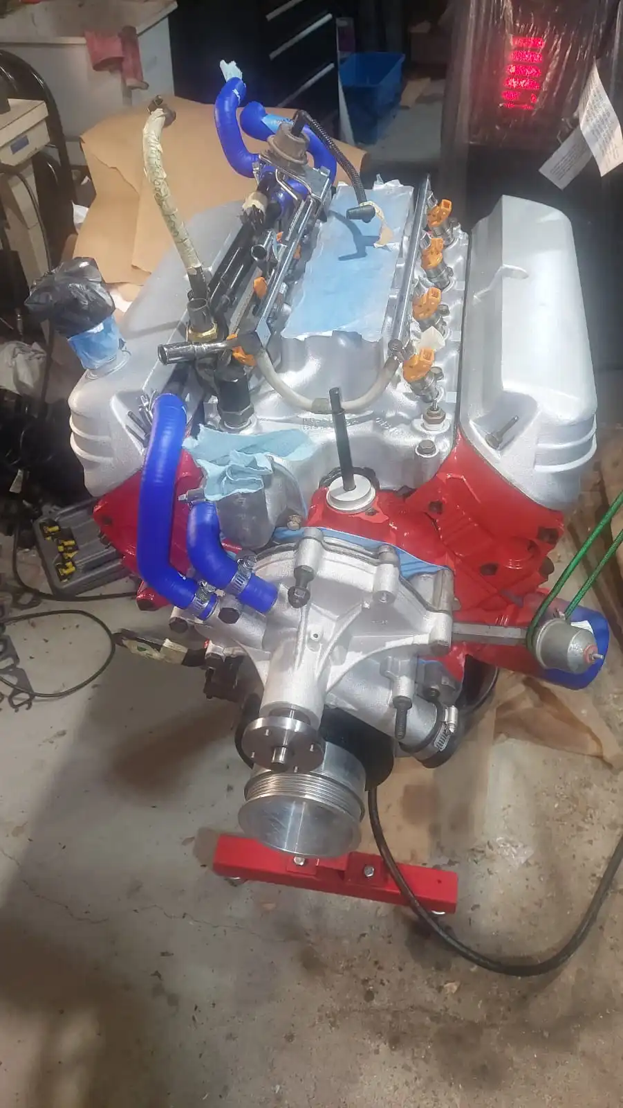

Now that I'm getting really close to the point of putting the engine in, I can't wait to test out and see if I did everything right.
Looking for advice-- do I need to hook everything up, once the engine is in, as though I'm going to drive it. Or, do I hook up just the minimum where I can turn the key and hear it start? Or, is there any other way to make sure it will run? I'd hate to hook up the radiator and add antifreeze and such if there's a chance I'll have to drain it all and pull the engine again. I'm pretty confident in my work, but it's also my first time rebuilding an engine. There could be mistakes.
