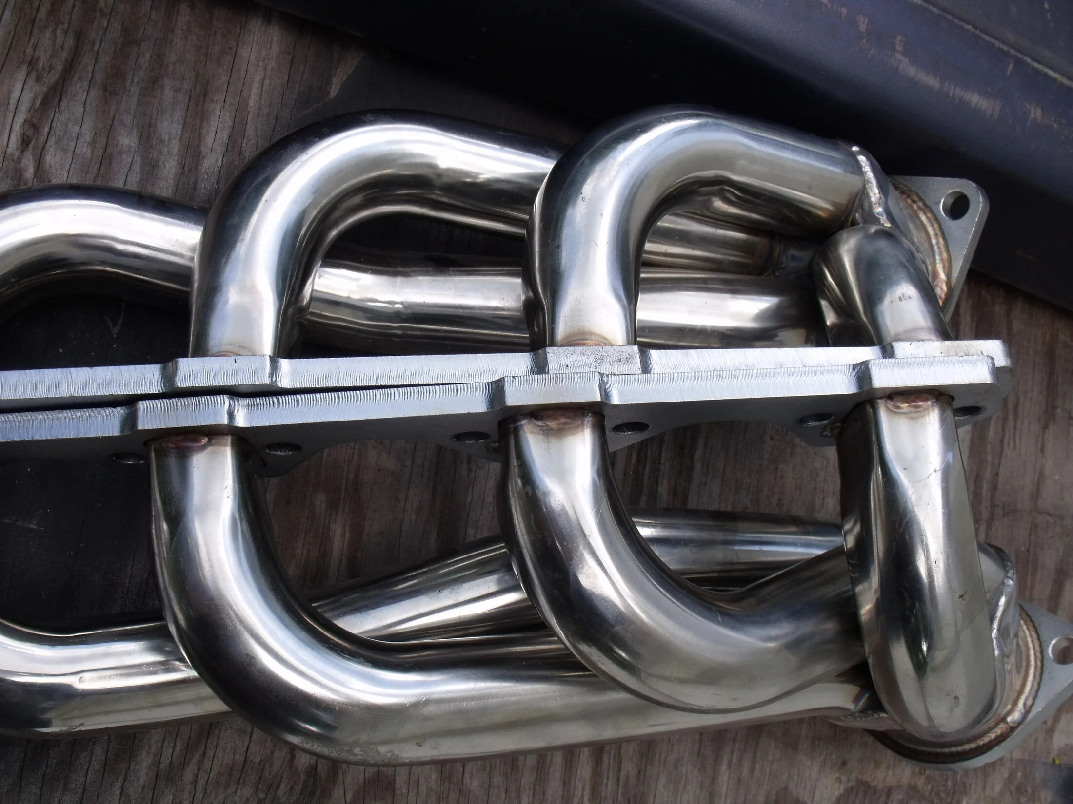

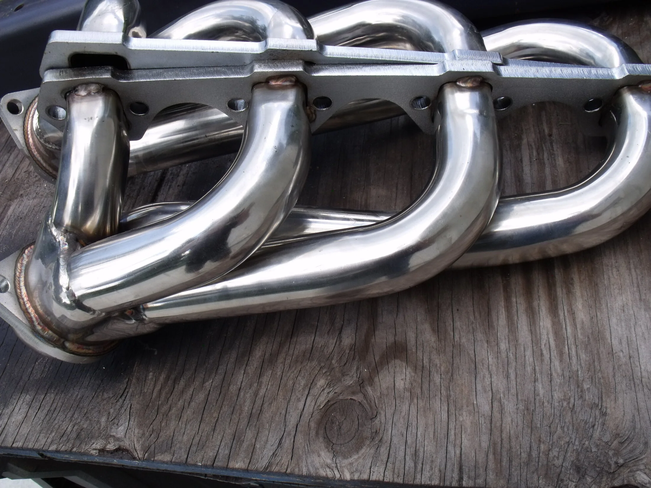

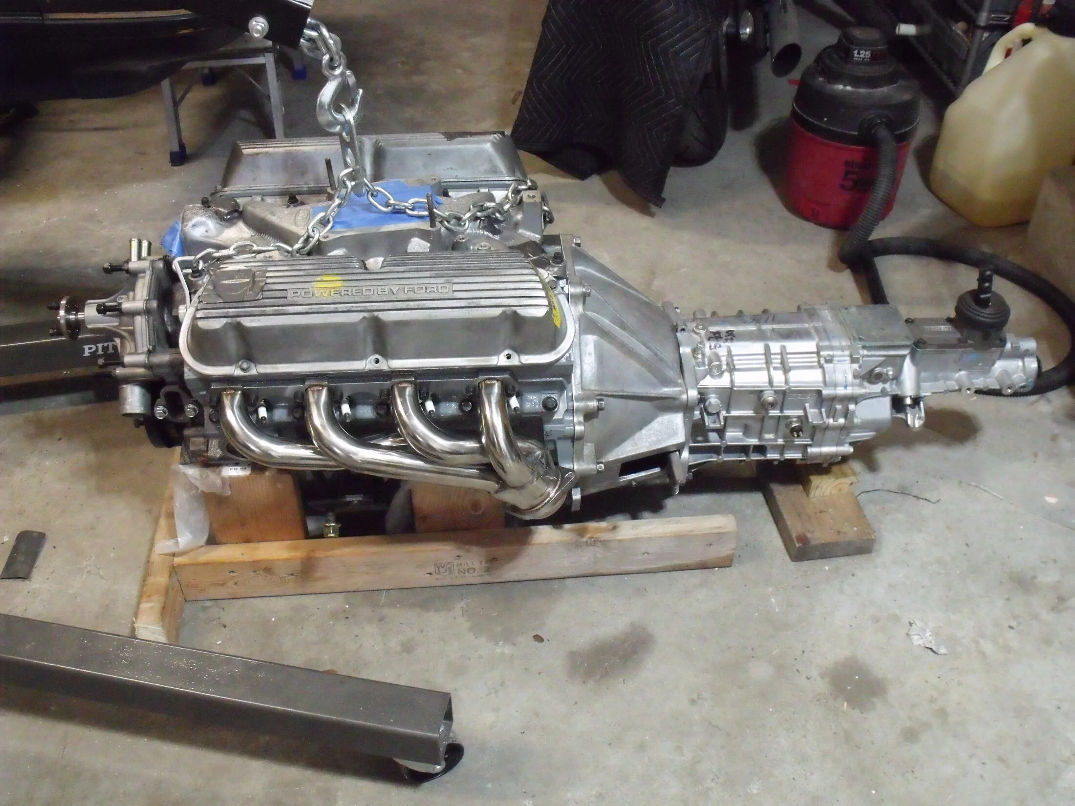

OK, so I just took these pictures of my cheapy shorty headers..... I am new to this Ford stuff so I do NOT have the experience that some of Guru's on here have.. So here is my experience being a newby with this stuff.....
I installed a junkyard Explorer engine in my 83 mustang.. First thing I noticed is you HAVE to buy some aftermarket exhaust as the stock explorer exhaust manifolds are truly some engineers wet dream..... I did NOT want long tube headers, I wanted the simplicity of shorty headers.... I do NOT care about going 0.0001 second faster at the strip.... If I could of installed the stock exhaust headers from the car I would have...
All I read about was how hard it is to get " P " head headers that fit well and allow you to get the spark plugs in and out easily... I saw these headers on Amazon " that work with P heads ", and felt that for $82 bucks with FREE shipping they were worth the chance .....
When I was young the only headers were long tube and were no where near as nice as these shorty headers are in " my opinion" ...
I guess you can cut a deep spark plug socket if you want, but I purchased the TF spark plug socket, which is a must...
With P head headers you can hand install the spark plugs right up the the snug point, but you need something for the final tightening.. You cannot get a a full size spark plug socket on and you cannot get an open end wrench on the spark plug...... The TF tool ( will try to attach a link) does this with help from open end or crescent wrench.... I have seen cars from my past that were a nightmare to install new plugs in... Personally with the TF tool on these P heads it was pretty simple...

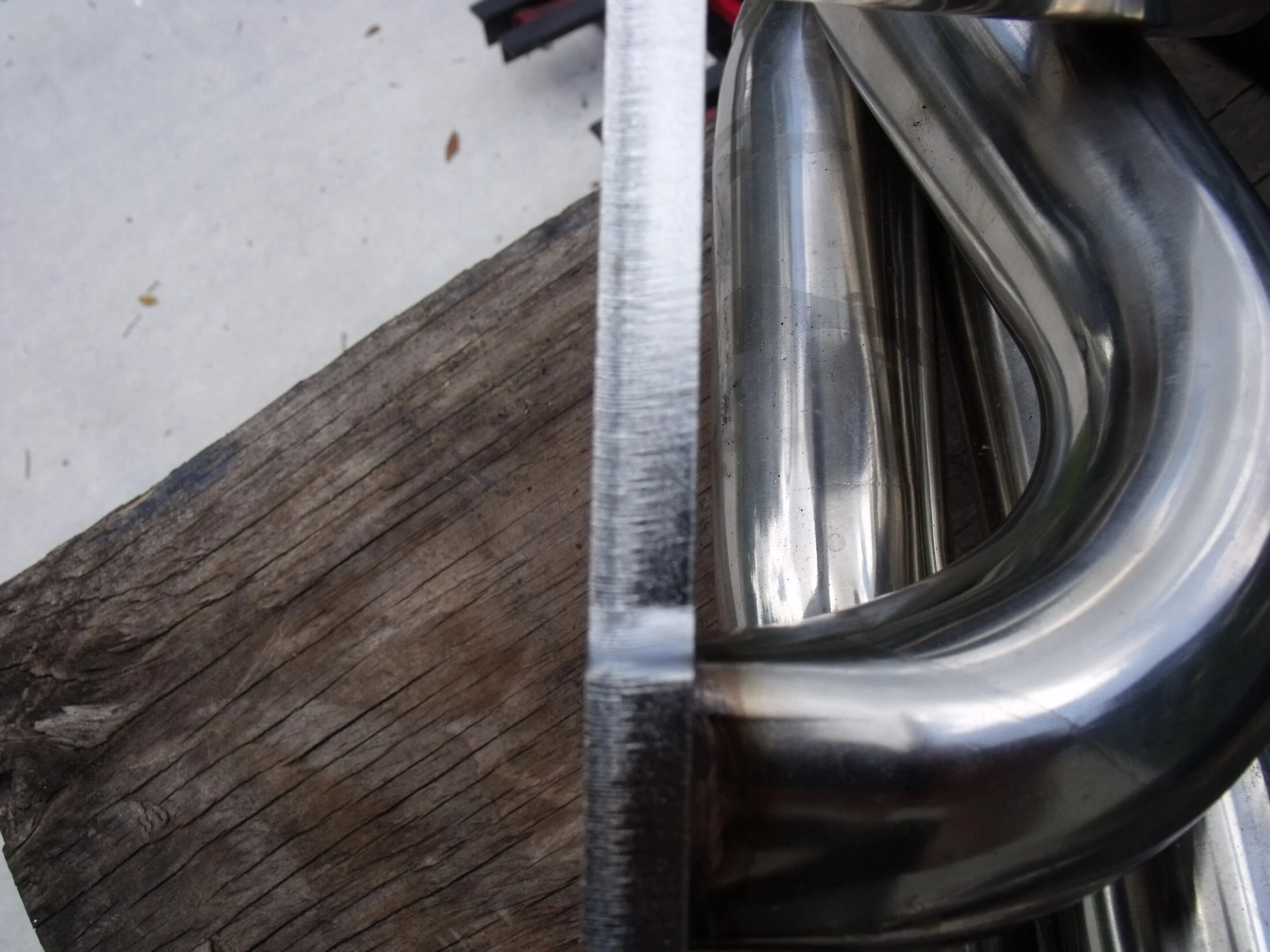

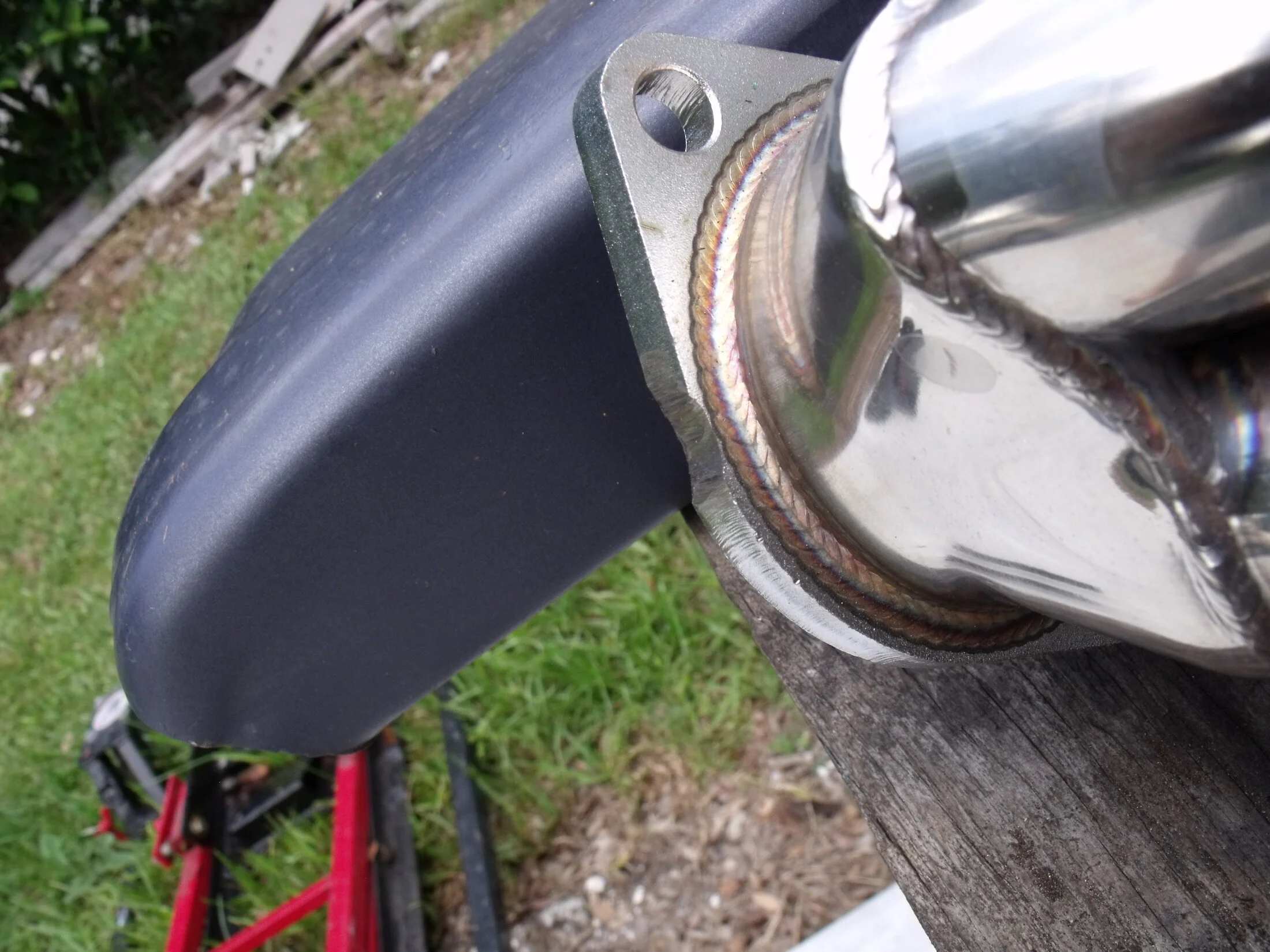

Using Remflex exhaust gaskets and some locking header bolts....
I did have to grind off a very small amount on the collector to fit... See attached pic..
I can't remember what wires I bought, seems like they were 90 degree boots and I purchased 3 or 4- 135 degree boots if needed....
These headers were installed on the car in the engine compartment and the ONLY reason I am not using them is I came across a set of FRPP headers for sale for $300 I purchased and installed on the engine/car... Remember, I am spending my kids inheritance.........
Personally I don't see much difference between these two sets of headers, but I did not start or drive the car with the Cheapy headers in the attached pics..... The flange seems plenty strong and thick to me and the tubes look like they are machine welded the entire perimeter on the inside....
NO, these are not for sale, I might need them down the road.....
I hope my personal experience helps......
