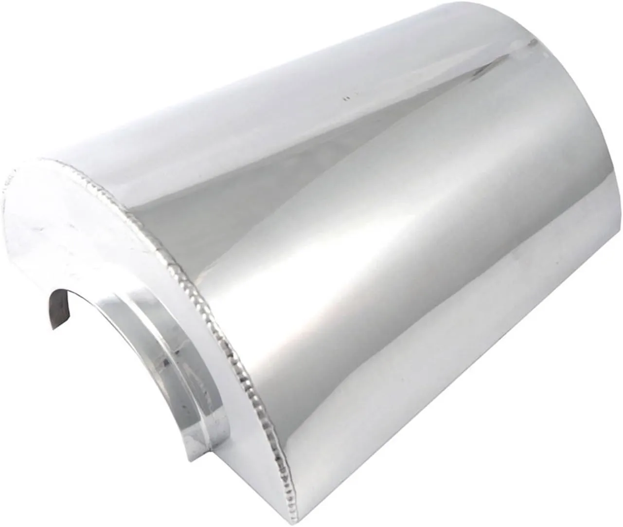

You may want to put a shield on the filter element. This is mostly due to fan wash and upsetting the MAF readings. IMO the best place is to move the filter inside the inner fender but you may be able to install a shield and be just fine. Something like this:
