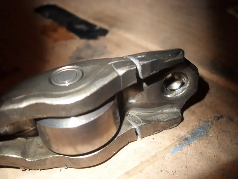

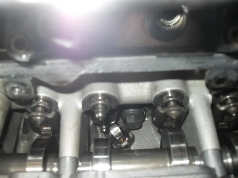

Haven't been in for a while, but finally got into the stang and here's what I found:
left side had a rocker(?) laying down at the bottom of the head with a small crack in it.
Right side was sporting 3 rockers dislodged and 1 wedged quite nicely between the cam and the hydraulic lifter. this was one that had fallen into the bottom, 3 of the 4 had cracks.

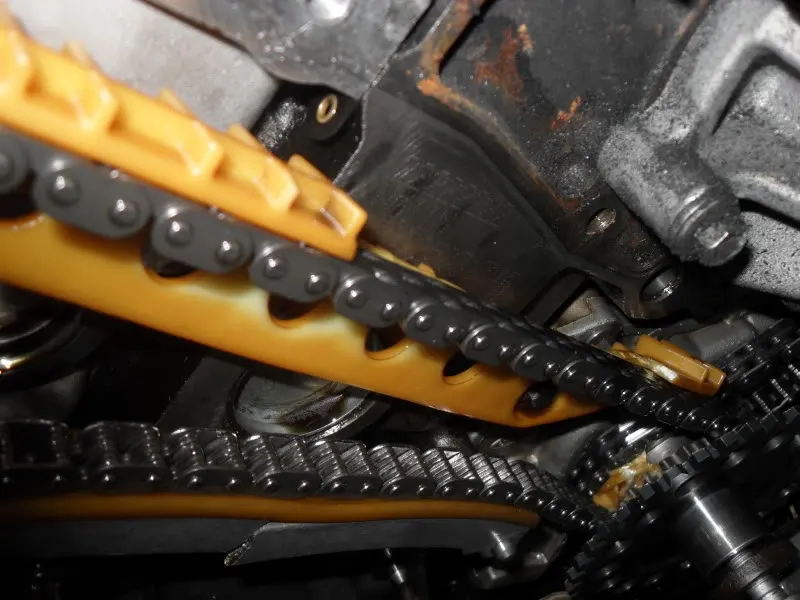

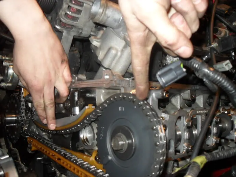

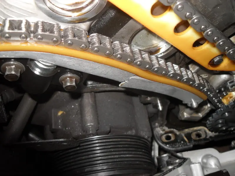

Got the timing chain cover off and boy did we hit the mother load ----
Timing mark on the cam compared to the timing mark on the chain.
The remnants of the guide...
those chains are sinched tighter than a gnat's ass!
Early next week we'll be pulling the heads and checking for piston damage. Since they're forged, they might have stood a chance. valve/heads/cams on the other hand...
Any recomendations on where to go from here?
