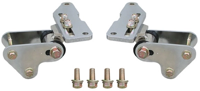

The motor mounts you're probably thinking of are from Ron Morris Performance:
Here's a link: http://www.ronmorrisperformance.com/
