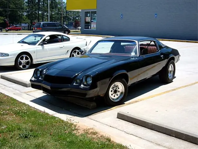

:nice: Well I finally got it!! I changed the spark plugs, wires, oil, coilpack, belt, hoses, relays, etc. Just went ahead fixed it all and it runs better than EVER. No bs. It was my coil pack after all. But doing everything myself was a ******!! I would have it all fixed, go for a test ride and if I got on it, I would loose a cylinder. I was getting so pissed. This is the 3rd day under the hood. So, I finally found out what the problem was. When I installed the new coil pack, the rubber orange band for the connector/adapter was wedged up in the connector. So with both orange bands on it was backing out and would cause it to run like crap. But it sounds and runs soo much better!! Thanks for all the comments they really helped narrow it down. Was kinda glad though after I had fixed it. I must have read the Mustang repair guide at least 15 times front to back. So I learned alot about my car and next time I'll know what to do incase something like that happens again. I wanted to take the engine out and bring it in and clean it but I guess I'll wait. Just bought another project car yesterday. Got a 1979 Chevy Camaro with a 307(305 w/ heads bored over). Check out the pic. On my way to have the tint done. Hope you like the new pics below. If anyone is near Atlanta and ever just wants to go for a drive or race, let me know. Looking for other Mustang enthusiasts!! Here's my email [email protected] Would love to find a club for the weekends.:banana:
