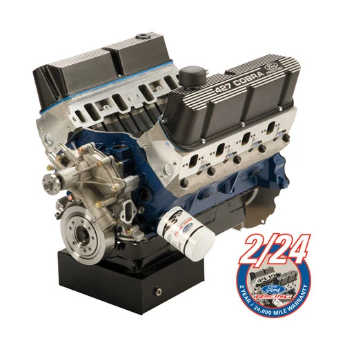

The 351W and variations are a tight but workable fit in the 65-66. If you really wanna get crazy, one of the guys at Scott Drake has fitted his 65 with a Ford Motorsport 427.
