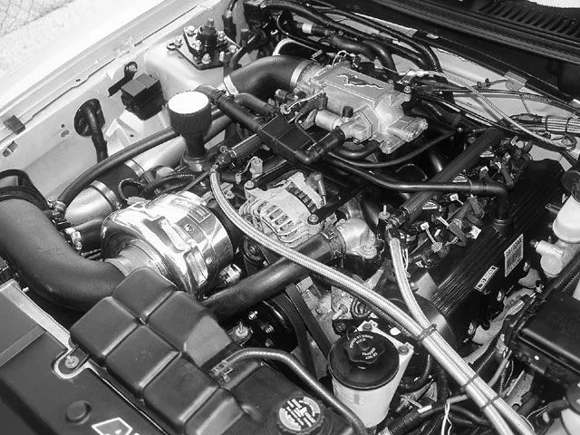

The 01 Bullitt Edition Mustang came with a different intake than the run of the mill GT:
This would be a bit different under the hood than the standard GT manifold:
I don't have the measurements though so I don't know which is lower-profile. As well, finding the parts for a Bullitt intake -- the manifold, the throttle cable etc will be far more of a challenge than a standard GT intake.
