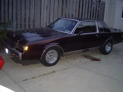

ok well this is kind of mustang tech,i have a 86 regal that i had put a 350 chevy in,well just like a chevy its broke now lol so i got an extra carbed 306 my question is anyone know where to get motor mounts to swap my 306 in?any help would be greatly appreciated also any trouble that you might see with this swap please let me know.im hoping it will be pretty straight foreward the 350 went in perfect.

well all im really worried about is the motor mounts,i have a fluidyne alluminum radiator for the 306 and i also have all the gages and senders from my vert,as far as drivveshaft goes i have 3 from fox body stangs and i have the one for the turbo 400 thats in the regal so i can take the yolk and switch driveshafts or have a driveshaft cut to the size i need pretty cheap,im just wondering if anybody makes correct motor mounts for this application or if im gonna have to weld the topside stang mounts to the bottom regal mounts and if i gotta do that is there a system to see what angle the engine should be sitting?:shrug:
