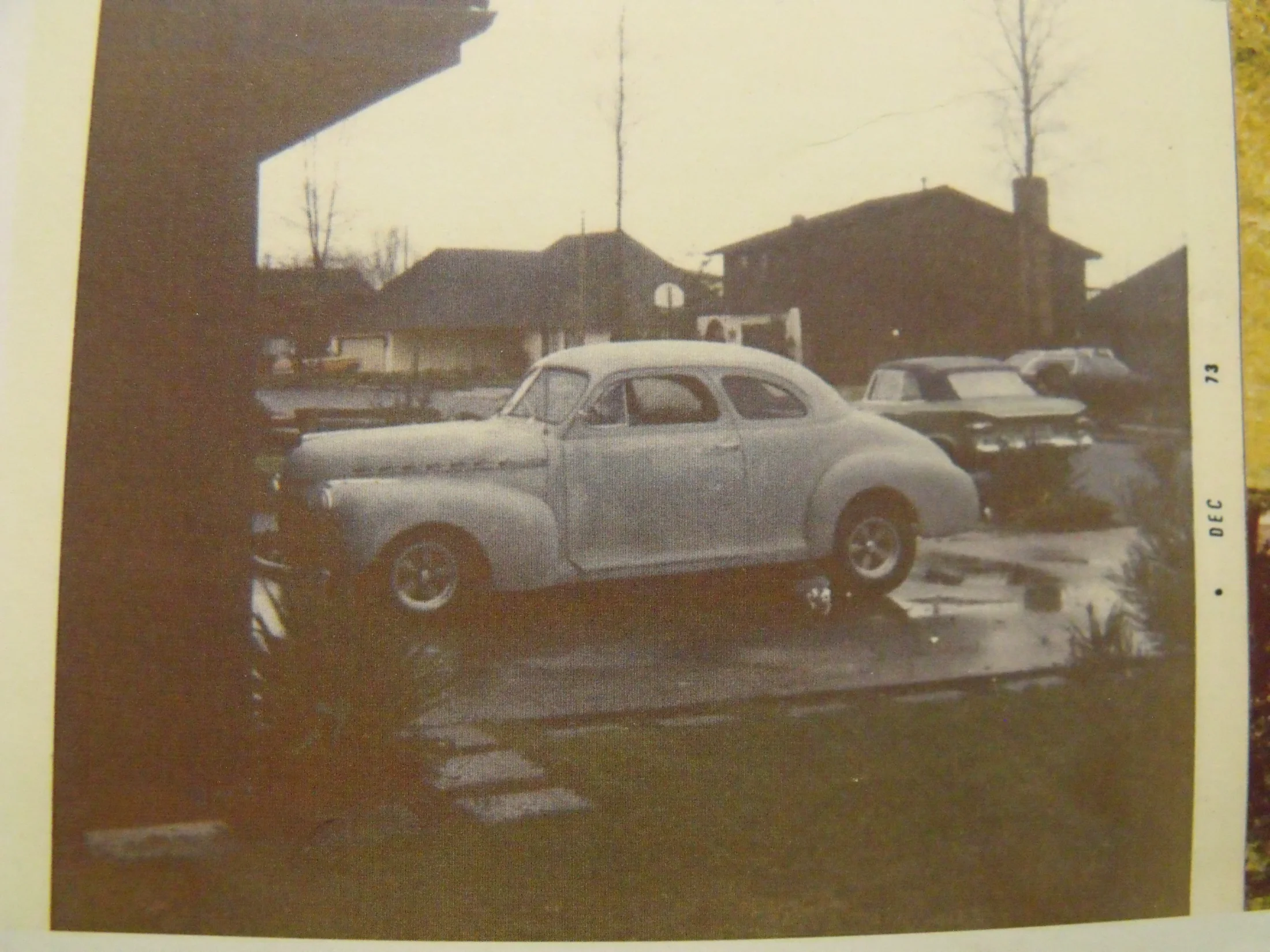

Too much car for a first car........ Just an old mans opinion....
My 396 BBC/4speed 41 chevy was probably too much for me...
