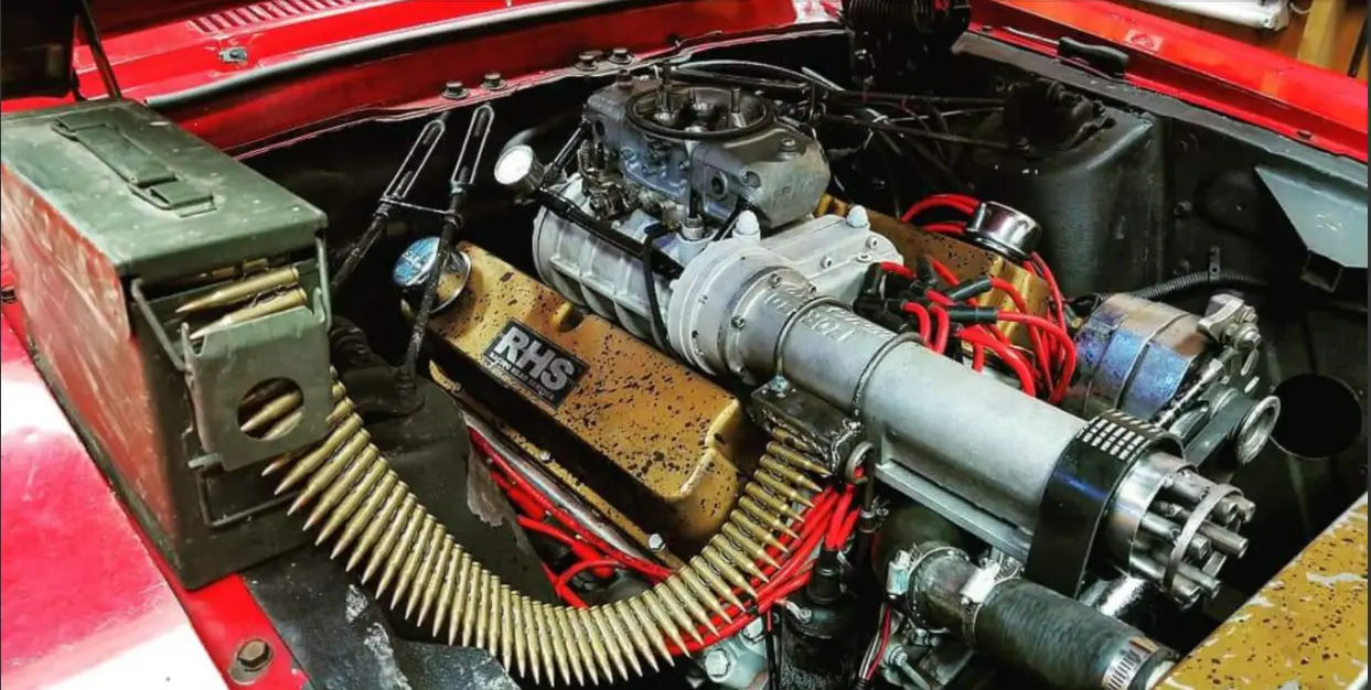

CarMichael Angelo said:
I'm talking about the red car with the fake mini gun Jeeves...
It's ALWAYS mustang goobers like this guy that being a "Ford guy" meant you were part of a freak show...
No detail in the engine compartment, turnbuckle strut tower braces, dirty, scroungy looking accessories, a " what the hell was he thinking" exploded rattle can treatment on the valve covers and radiator....
And that wanna be mini gun barrel shooting straight into the radiator....
Some guys are meant to just leave their sht alone..
Considering he has all thread with turn buckles for tower supports and the Mad Max style engine bay I'm pretty sure he doesn't care if other people think his car is "pretty" or not. BTW, have you won any best pumpkin awards with your car? People and opinions, gotta love'em.

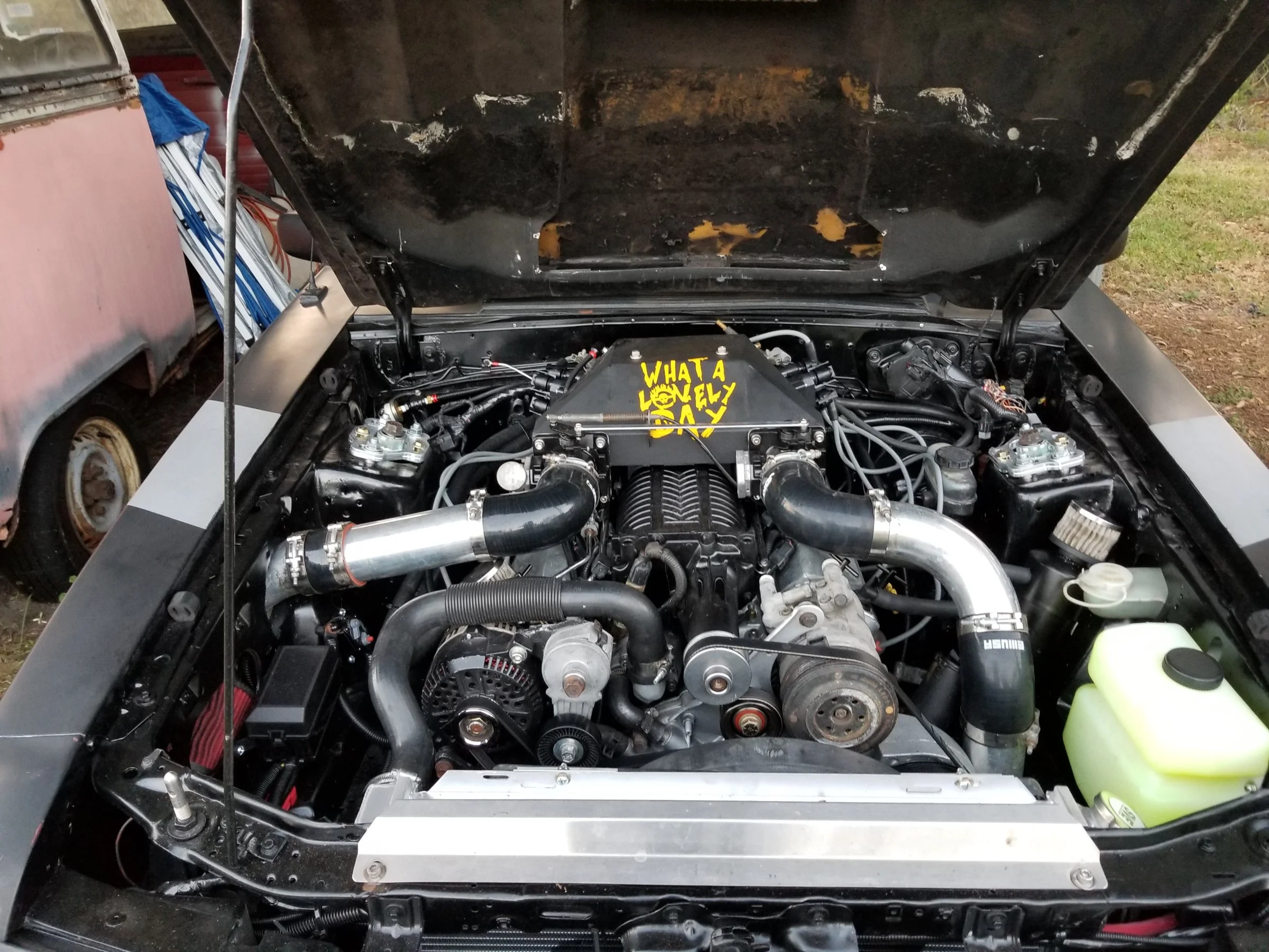

a91what said:
306 ci
Gt40 heads 2.02 1.6 valves full port
E303 cam (I hate this thing) pulls hard from 3k to red line
Intake is obviously non standard it's a m112 blower from a jaguar makes 10psi
Water methonal 17gph to keep temps down
Unequal shorty headers to 2.5" exhaust with cats x pipe and 40 series flows
EDIS8 ignition
W/o wmeth 20* timing
W/ wmeth 26* timing
Bar none, your Fox is favorite car right now! Great job Steve!

the small m90 I did before made 400 rwtq at 3k rpm and only 290hp at 4.8k

a91what said:
Maybe it's the 3.08 gears that make it much less violent. It will still hopelessly spin the 275 nitto 555 tires in first gear and most of second but i had to ditch the 3.73 gears as it made cruising painful with the t5 i think a 3.23 gear would have suited me better
I agree the 3.73's are a bit much with a T5 and a screw type blower. When I was planning on staying NA and got the IRS built and removed the factory 3.27 gears and had 3.73's put in. That was fun while I was NA but now it's just too much. Now I'll have to pay to go back to where I was and waste more money on it. I don't think I can fit a big enough tire out back to make up for it and it still look good
My new prediction based on your latest info
10 psi @ 26* I will say 400hp/430tq. Sounds like a killer street car with a broad power curve
remind me what did yours make on the dyno???
The max I made was 380rwhp, then we pulled a couple degrees out and the final romp produced 365rwhp. I'll be installing my meth kit once I'm done with my seats and I'll be taking another trip to the dyno and might add a little more timing back in depending on my IAT's with a 10gph nozzle pre-blower (inlet). Even if I don't add timing, I'm happy where I'm at. My car is quick on the street, fun to drive, and very reliable. Couldn't be happier
You mean Public opinion......
You can take that "He doesn't care what people think" line with me all you'd like. I'll call bull on the next line.
This guy wouldn't have went through the trouble to build his fake radiator shredding minigun if he didn't care what people think. Every time somebody opens a hood to reveal their over the top this, unconventional that, or mega shiny the other, did it to get a rise out of anybody that happens by. The reason that all 37 fox mustangs in a row at a large mustang event have their hoods up isn't because none of them don't care what people think.
Everybody cares what people think. Excepting the occasional clueless slob,.....the rest of the world puts the right shoe on the right foot, and the left shoe on the left foot,... and would want to know if they had them on backwards, or If they sat in gum, or had something in their teeth.
Whether or not Radiator Rambo wants an opinion of what he thinks is cool, changed the minute he put that ammo can on the fender, raised his hood, and posted a pic on Facebook.

a91what said:
306 ci
EDIS8 ignition
W/ wmeth 26* timing
That's just awesome.
You will need at least 14gph nozzle. Pre blower.
I didn't even see a temp drop from the 10gph nozzle.
Pay attention Mike. I said "I don't think he cares if people think his car is "PRETTY" or not. I'm sure he cares about people thinking if his car is cool and unique. Not everyone cares for a perfect paint jobs, SS braided hoses with AN fittings, chrome, blah, blah.
I'll have to go to my garage and check what size nozzles I have. Thanks for the info

Ah success I finally saw a reduction in intake temps with 17gph flow from the wmeth system plumbed in before the blower. Temps stayed below 150* in the manifold that is about a 80* drop from before with 10gph....
I could probably go 20gph with my current setup. You have to remember that I have to cool the entire blower case down before it affects the air temps.
The new job is pretty cool I like the classroom atmosphere, i have been lucky in my 8years in the field I have seen some things and installed equipment many of my counterparts have only read about. This includes alot of legacy equipment like a Cincinnati millicron..... that's the great granddaddy of the PLC. I am serving as an assistant instructor to get my feet wet at the moment, my partner is someone I ran work for a few years ago. He has been in the trade for 28years and asks me to elaborate on subject matter he has never encountered in the field. I feel like we make an effective team when it comes to taking the class work and making it relatable in the field it's a nice feeling when one of the students realizes that all the theory they have to learn actually has a place out in the field.
