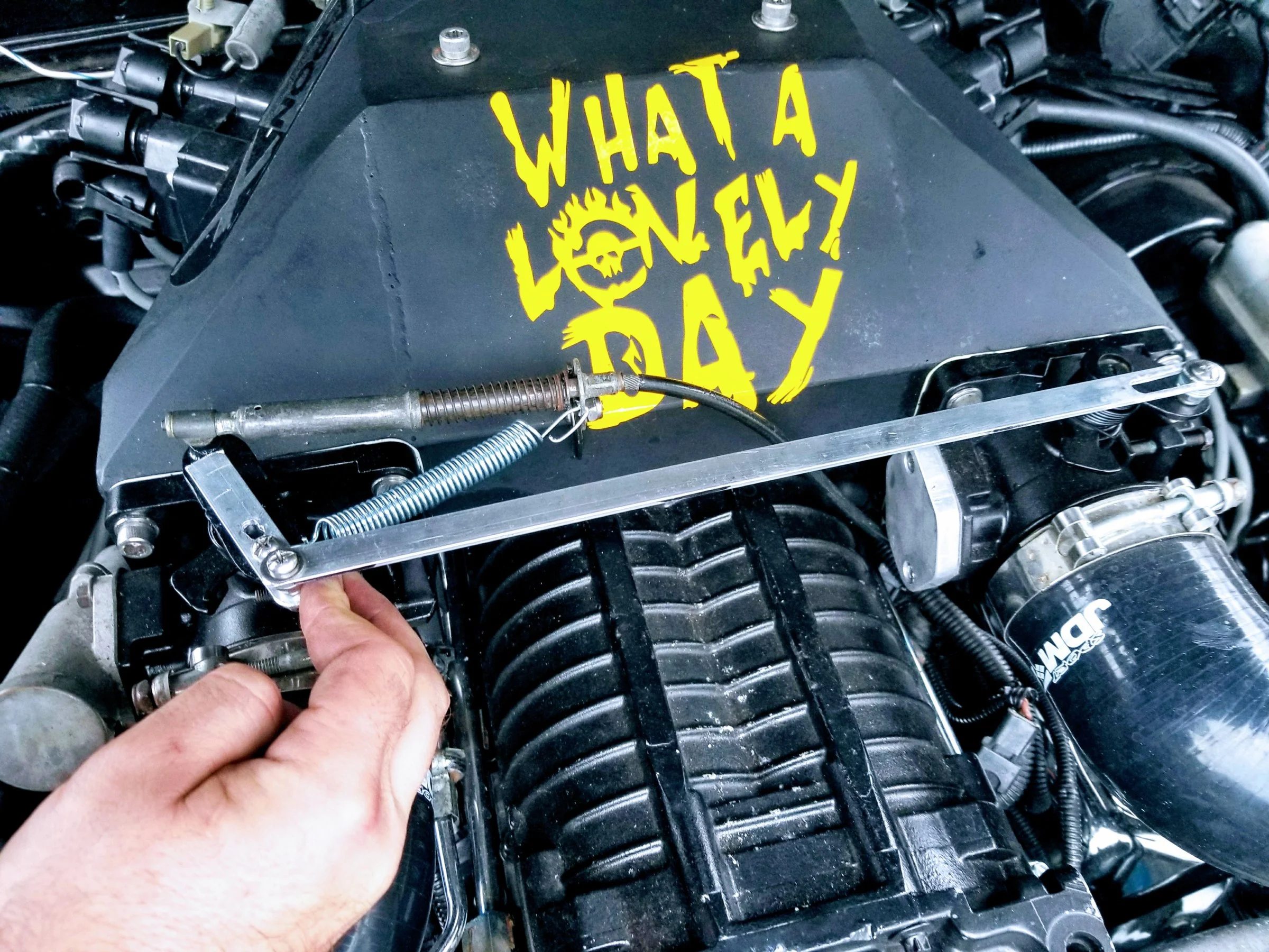

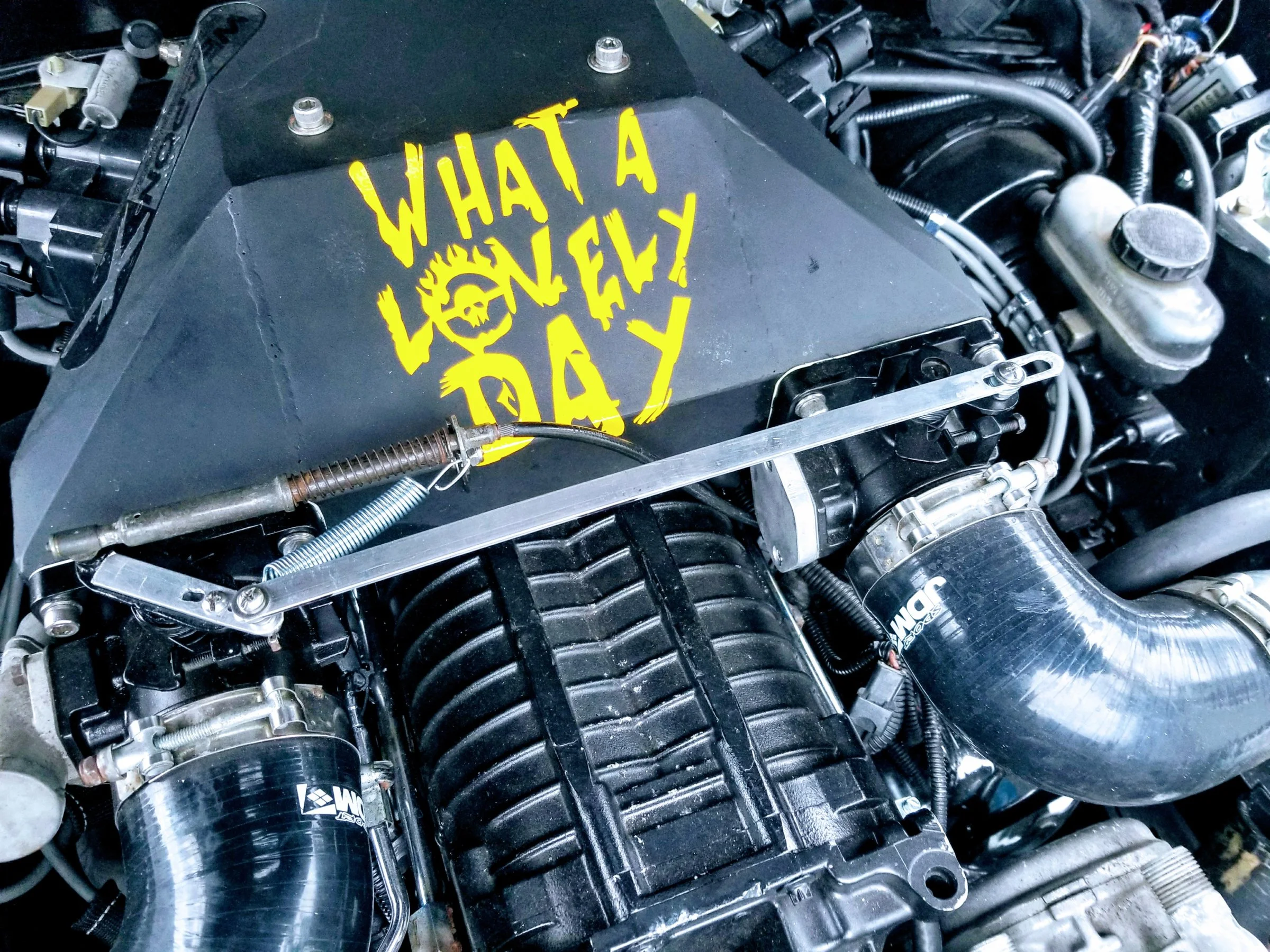

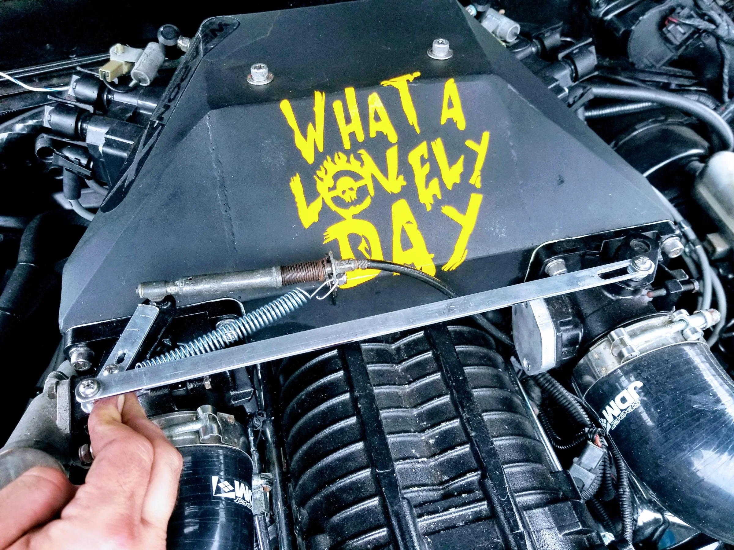

:chin prototype works well
FYI the sliding linkage while being an ugly piece together with spare junk under the work bench, works flawlessly. It solved the odd pressure surge off idle, the hanging idle, the touchy pedal feel and still has good throttle response.
It is a bit weird to feel the second resistance at half throttle when the slide meets the linkage and the second TB starts to open. But you know beyond that point boost is immediate.
This will work out great at the track, I have a literal break in pedal feel for when I want boost. Maybe this will help with 1st gear wheel spin. If I can get my 60ft below a 2.2:rolleyes: I may break into the 6s category in the 1/8th best so far is a 7.2 on the old small m90 setup.

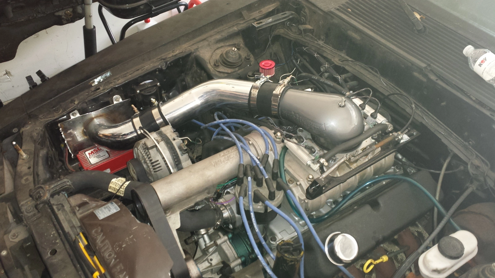

Cool build man! I also wanted a roots blower setup with EFI but since I didn't have all the fab ability at the time, I chose to use the full Weiand 174 kit with a mostly custom throttle body injection setup, all controlled by Megasquirt 2. Your port injection modification on the weiand/b&m manifold makes me want to explore the port injection route with mine again. At the time I forwent the idea due to lack of space between the blower case and valve covers. I'm wondering if there is a way to make it happen. lol

In short, it uses MS2 with direct coil control, TBI with four 160lb injectors (PWM control in MS rather than a driver or resistors), and remote mounted stock idle valve plumbed to TBI for idle control. It runs on e85 so that valve really helps with cold starts!
I built the entire tune from scratch so although it does run and drive, it's not perfect. I'm a big stickler for driveability and chose a terrible platform to achieve stock-like driveability with so it has taken me more time than my MS2 turbo port injected car. I keep cruise AFR around 15 as well, hits boost instantly if wanted, idles fine, just needs fine tuning for crisp response on/off throttle. I'm considering installing a MAF with a precise calibration curve to see if it eases my idle/cruise tuning. I could switch to MAP above 100kpa or something if needed, though I doubt the stock supercharged fords do that, so maybe it'll work without MAP.
There also aren't a lot of TBI roots blown e85 megasquirt v8's rolling around so I haven't had a lot of luck finding experienced help. Lol Just a lot of self-teaching and trial-n-error.
