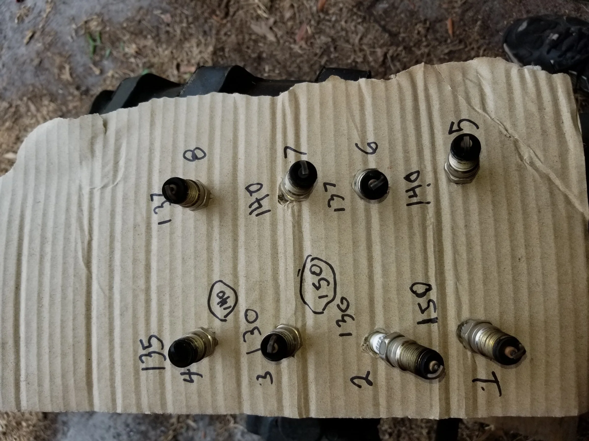

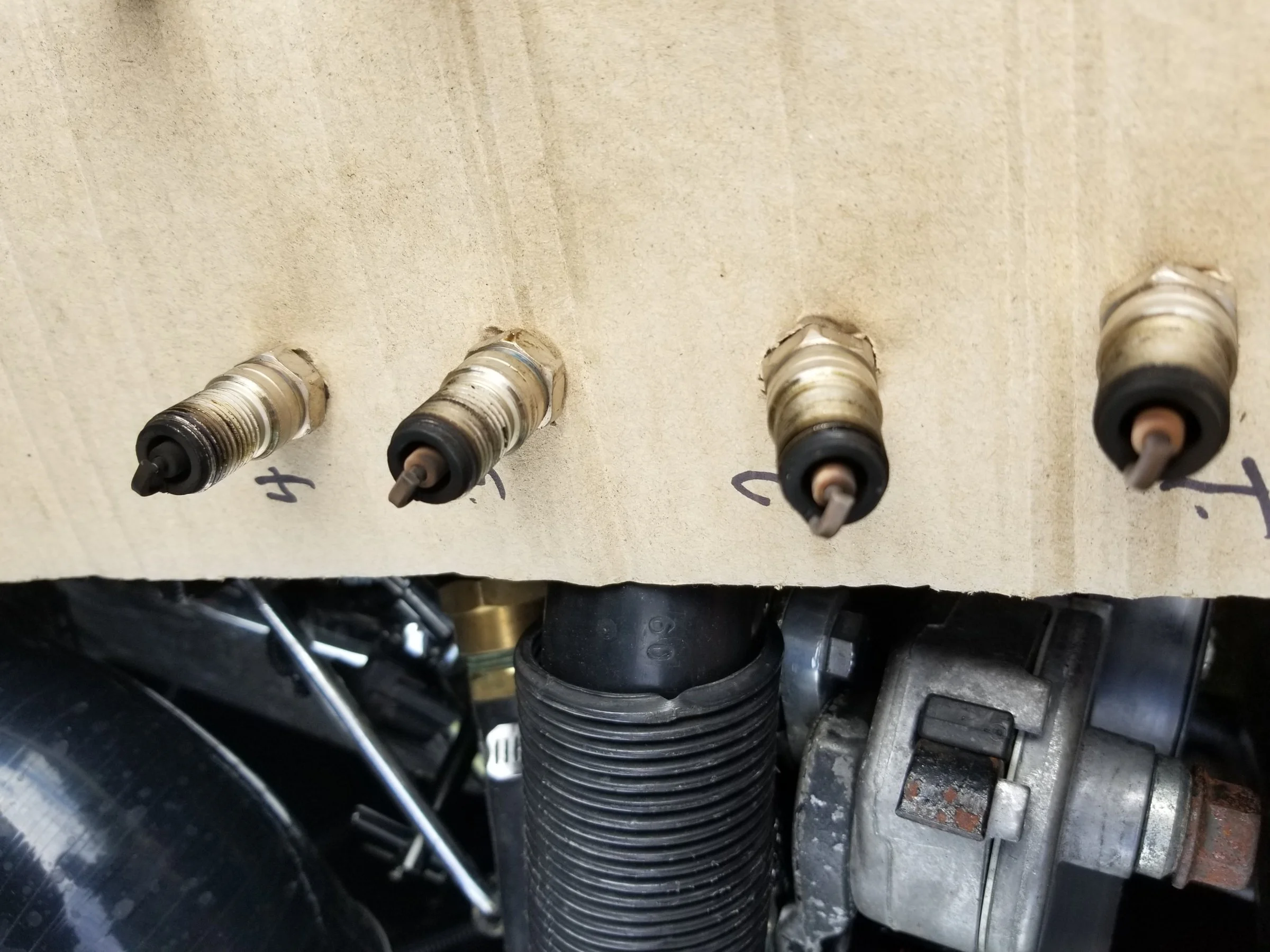

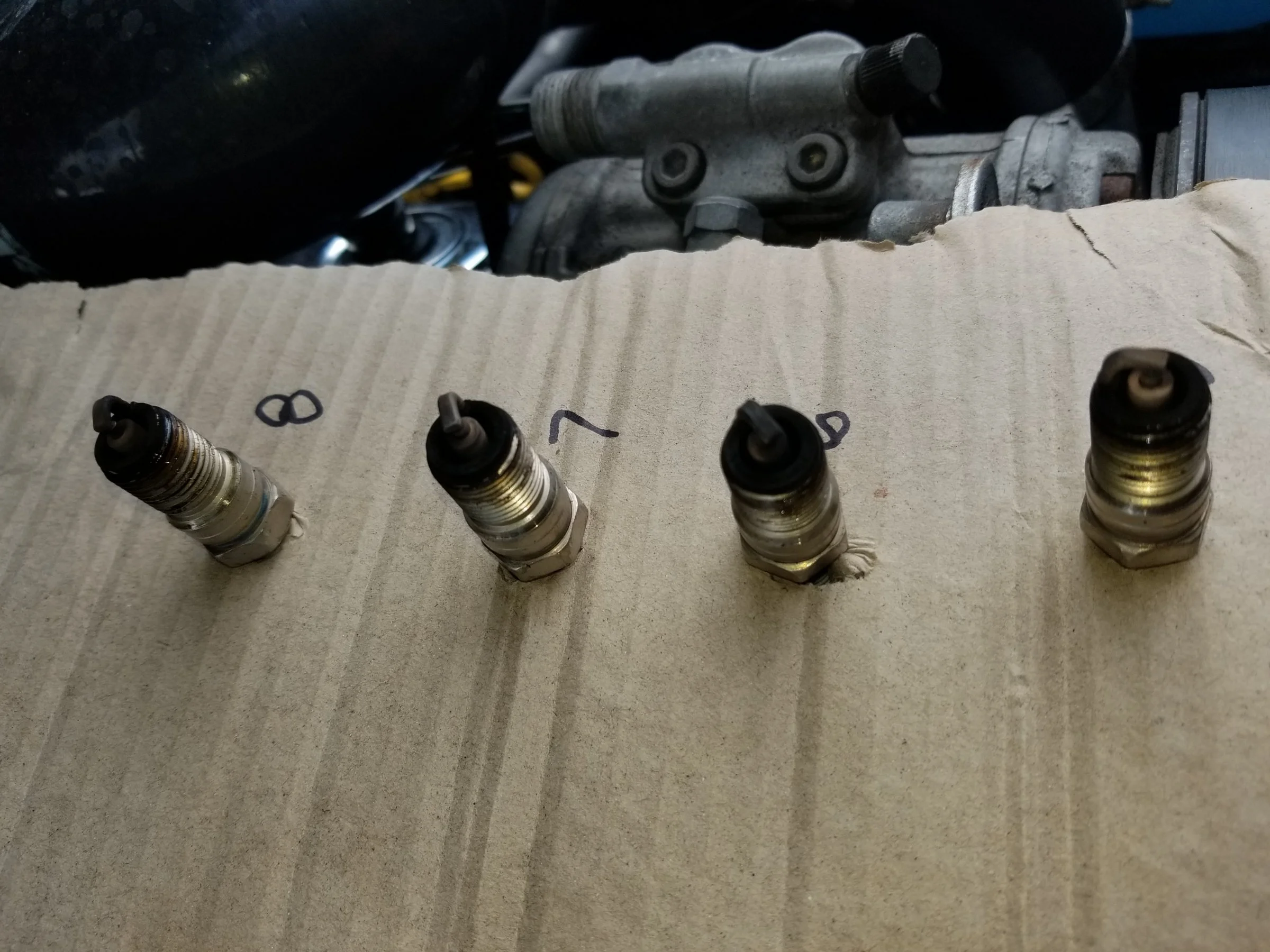

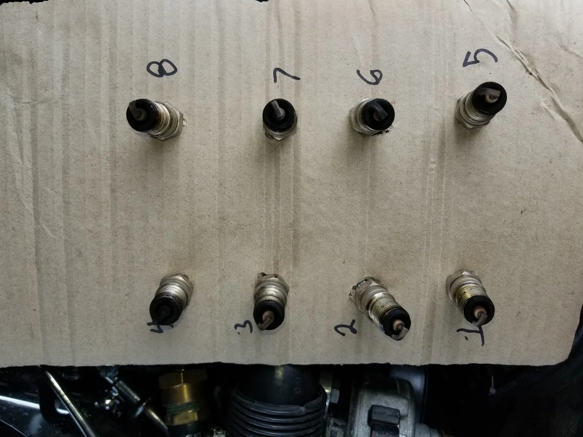

Pulled plugs and the first thing I said was WTF?!?
This thing runs lean at cruise and idle 14.7-15.5
Wot in boost 12.3......
Why do the plugs look so damn sooty? Either the wb is reading incorrectly or I'm burning oil. What do these plugs say to you guys?
I know it's not a intake gasket leaking I am able to see them when I pull the blower but I will check again when I have it off the car.
The oil has to be from inside the engine there are no gasket leaks on the outside.
Compression test in a few minuets

compression numbers by cylinder, I went ahead and tested the lowest 2 wet and it concludes the rings are toast. This was all done cold if it matters.
The low compression and bad plugs may be the cause of the backfire issue with a wasted spark setup.??
Either way I think my fun is over.

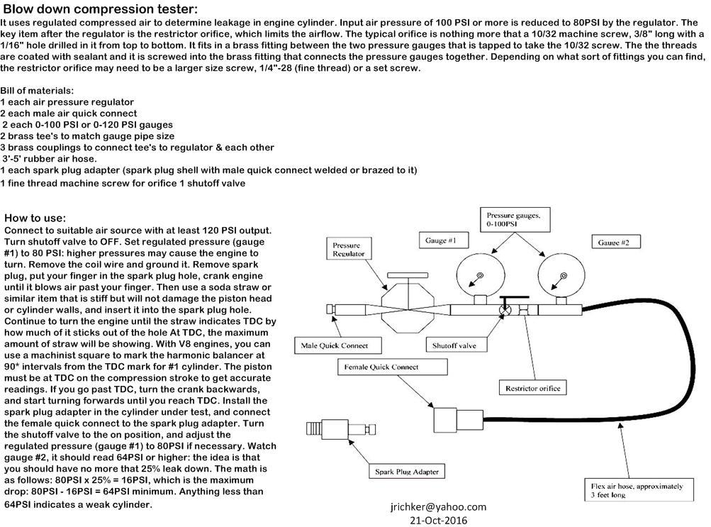

I don't have a leak down tester So I just put compressed air at top dead center I got a lot of air coming out of the valve covers even on the good cylinder
Here's the answer to the blow down compression tester problem...
Click to enlarge the tiny picture.

Anyone have an opinion on that #4 cylinder? Plug looks really carbon fouled, injector maybe?
