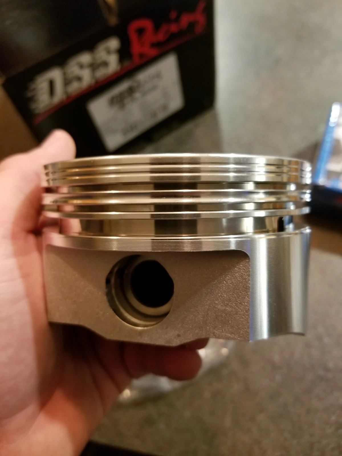

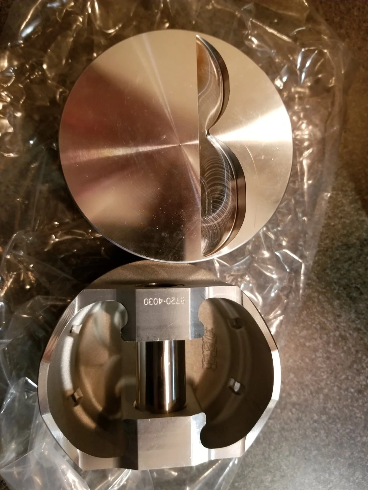

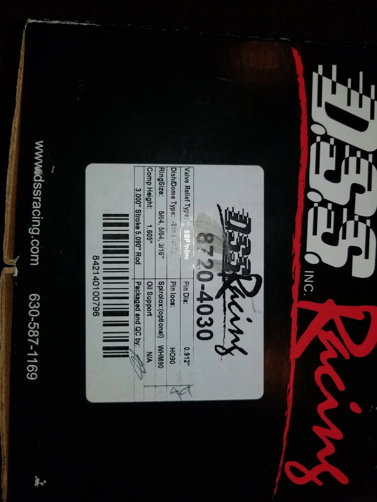

I had a care package waiting for me today:rock:
Don't think I have to worry about breaking these.
