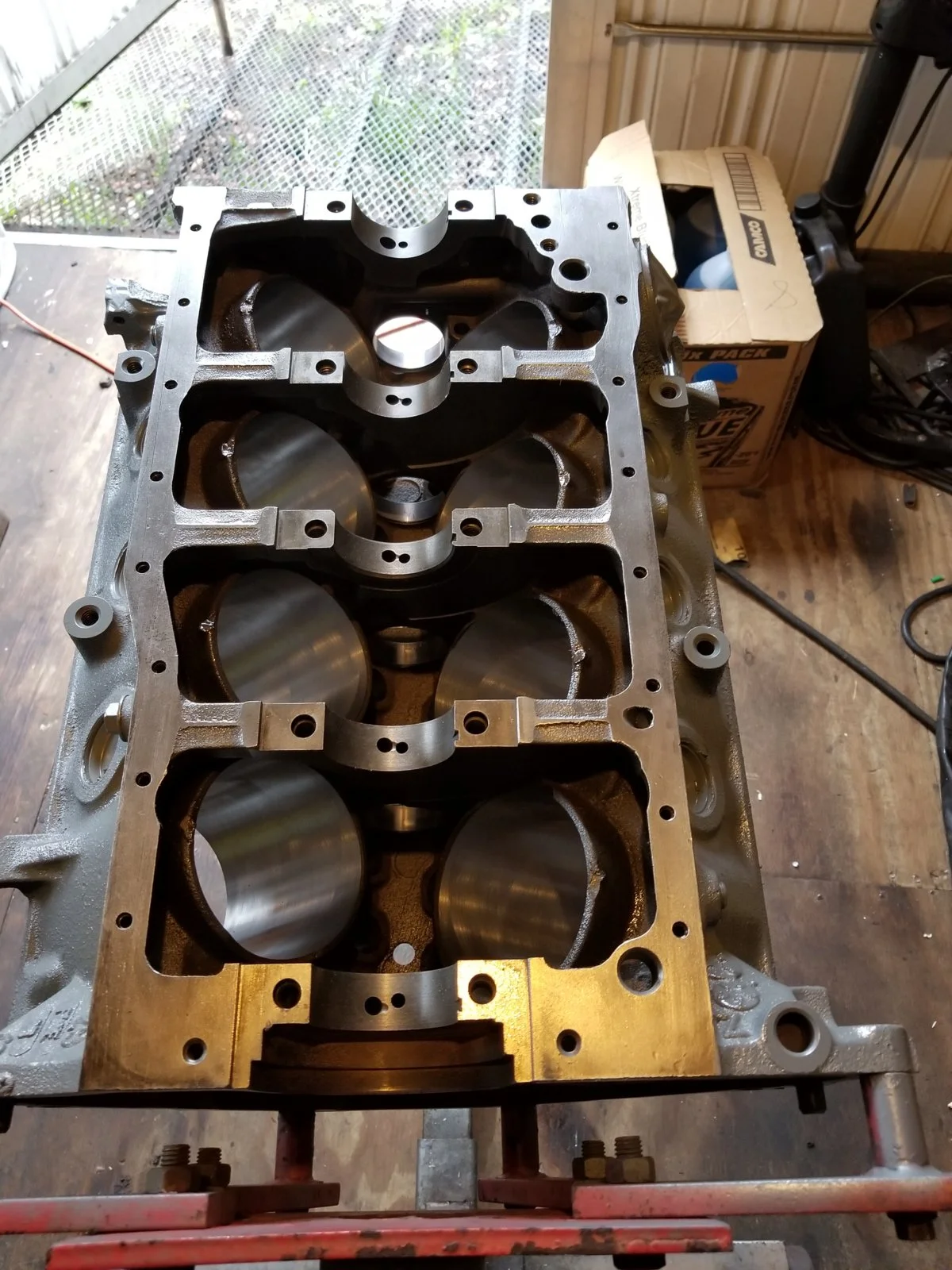

So after appeasing the powers that be I was able to get out to the shed and clean the block up. I did not want to make the same mistake I did a few years ago (did not clean well enough)... This time the engine got a good wash down with soap and water, then brakeclean, then all the cylinders got wiped down thoroughly with paper towels and penetrating oil. After all that washing and cleaning the penetrating oil kept removing debris, I cleaned until the towel showed no discoloration. Almost went through an entire role of them. super clean.

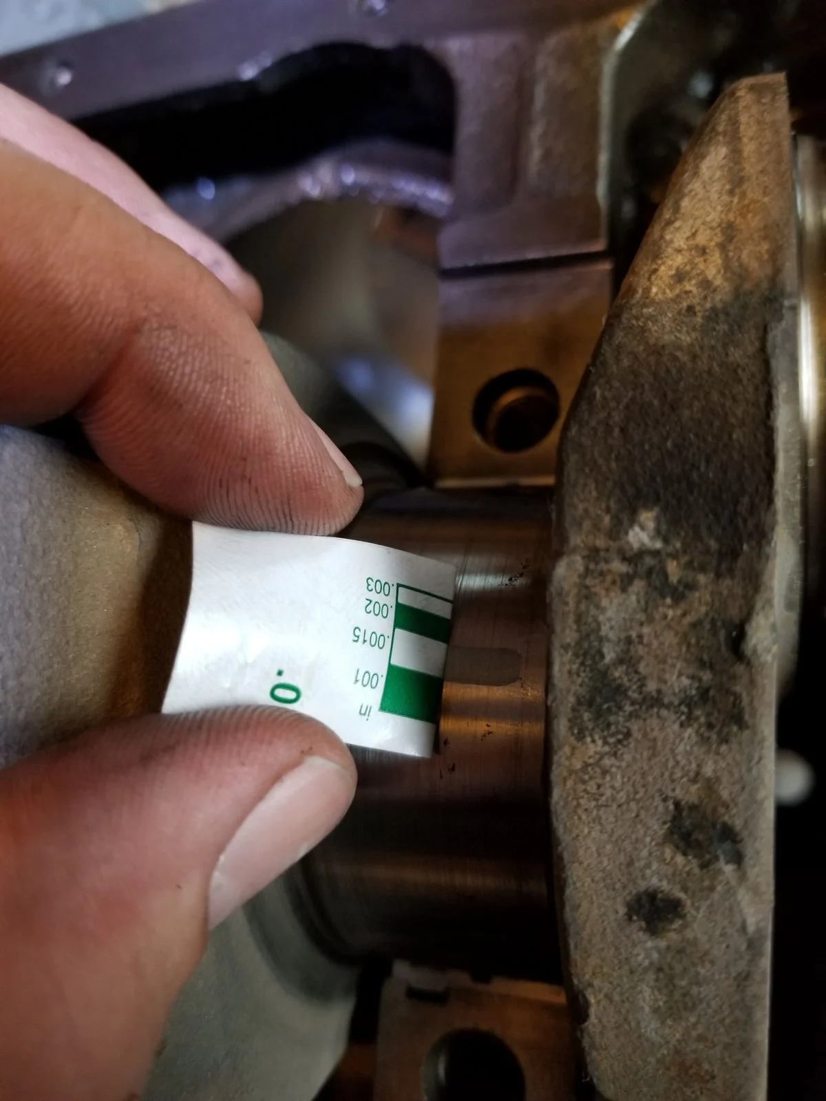

Next I laid the bearings down in the block and cleaned the crank, it went in dry. I am checking for clearance after all oil will throw the reading off. After cutting and laying the plastigauge down on the crank I placed each cap in its spot (after installing the bearings into them) then torqued to 65ftlbs. After removing the mains I checked the plastigauge thickness against the ruler on both crank side and bearing face. that's howwe like it nice and tight... 15 thousandths is a nice number. This was uniform on all mains, we polished the crank and went with a clevite P1 bearing. I'm happy with the results.

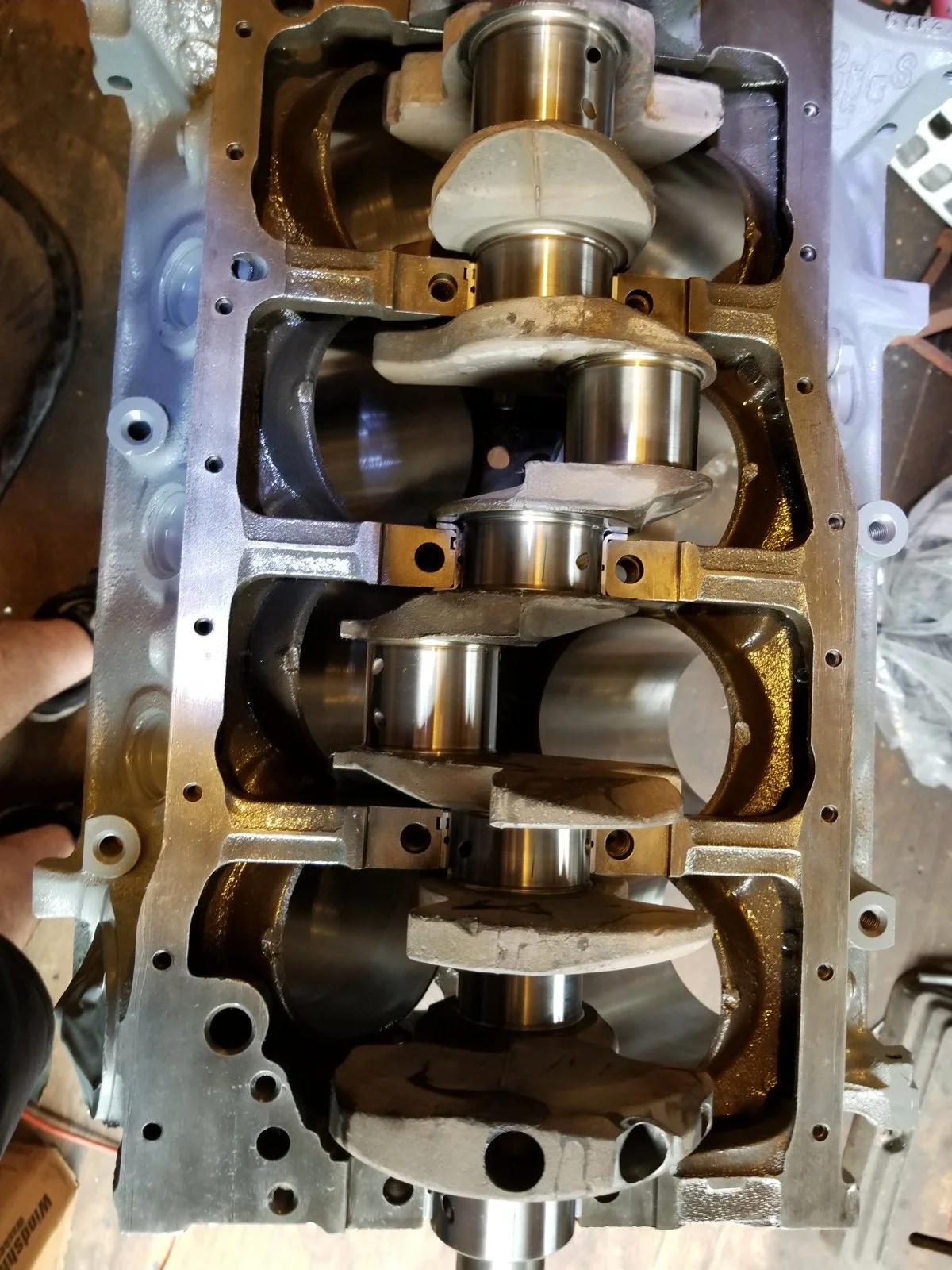

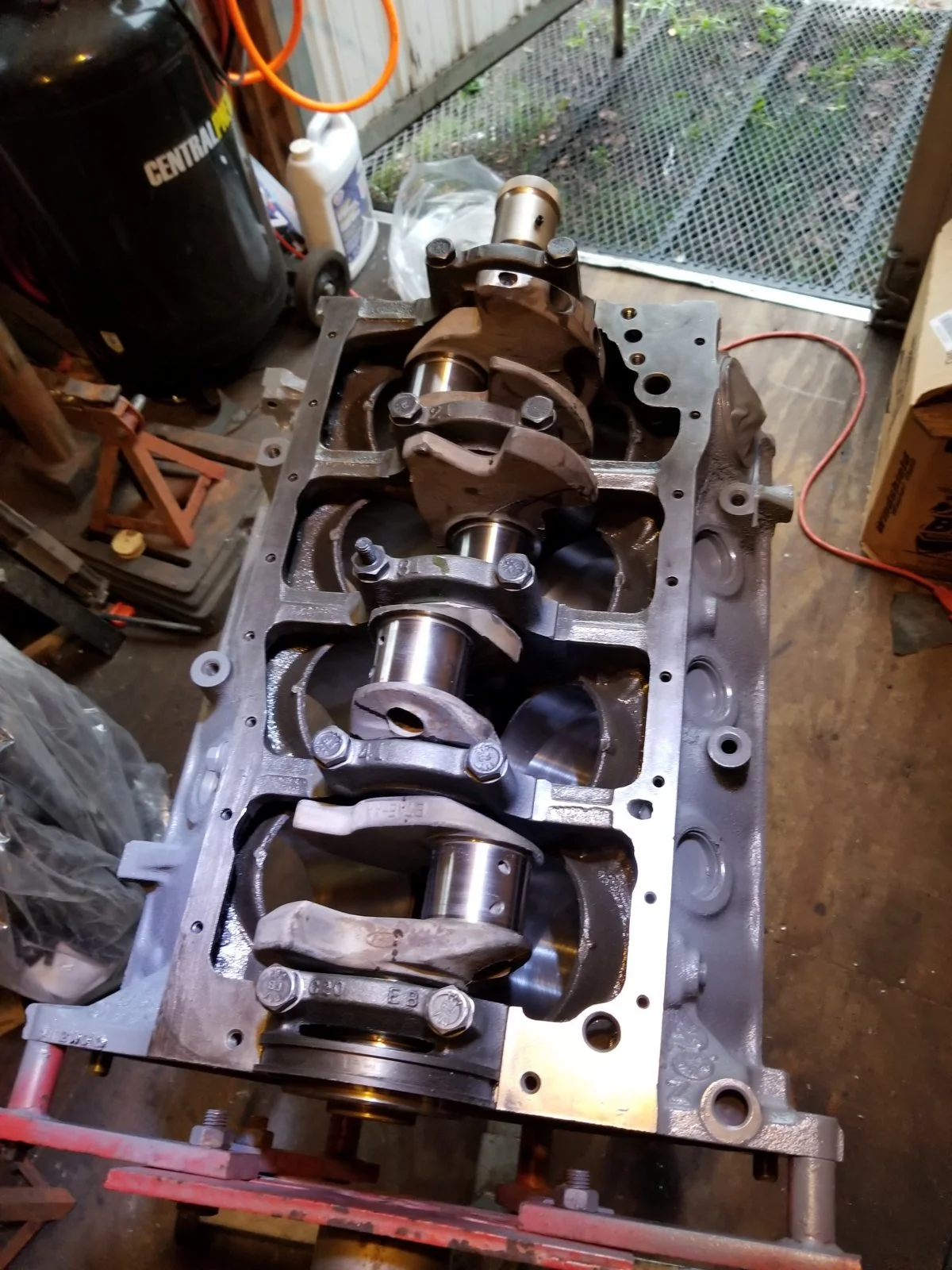

I removed the crank and after I applied a nice dose of assembly lube reinstalled it. The crank spins over very nicely with little to no effort.
This is all I had time for today, next I will gap the piston rings.

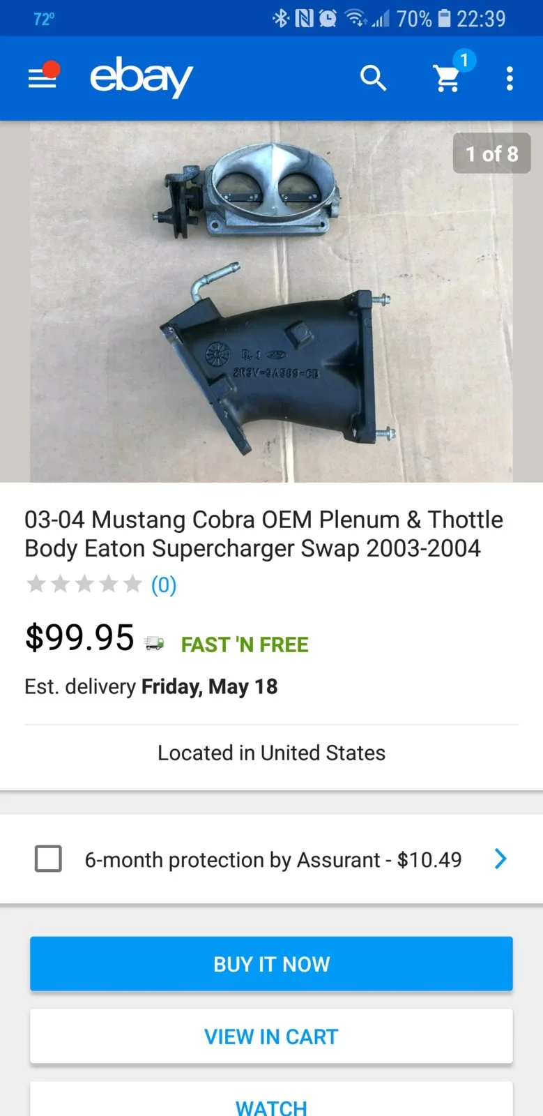

Ok so trying to come up with ideas for the new intake for the blower. I want it to look good and flow well, what I made last time wont fo. While searching for a reasonably priced TB that flowed well enough I came across this.
what do you guys think? I would still have to make a plenum yo get this attached but it would look the part I think.
Or.... who thinks I should do the dual Tb thing again.

I'm confused as to why you think you need this much incoming air, and two tb's when there are scads of guys making hundreds more horsepower than you plan to with one big one.
I made over 1300 with a single 100.
What's the equivalent circumference of that dual blade unit you're considering?

One and done

Equivalent to a 80mm single blade. I dont want to create a restriction before the blower, any kind of restriction will create extreme iat temps.
All that aside I do have a single 75mm that will most likely get the job done and I can upgrade that in the future.

@CarMichael Angelo you win I will use the single 75mm TB I have sitting around and we will see how the car responds. My goal is only 400rwhp the 75mm TB should support that.

I wasn't trying to "win",.....I was trying to appeal to the rational side of your brain. (This coming from me................................I know, right?)
