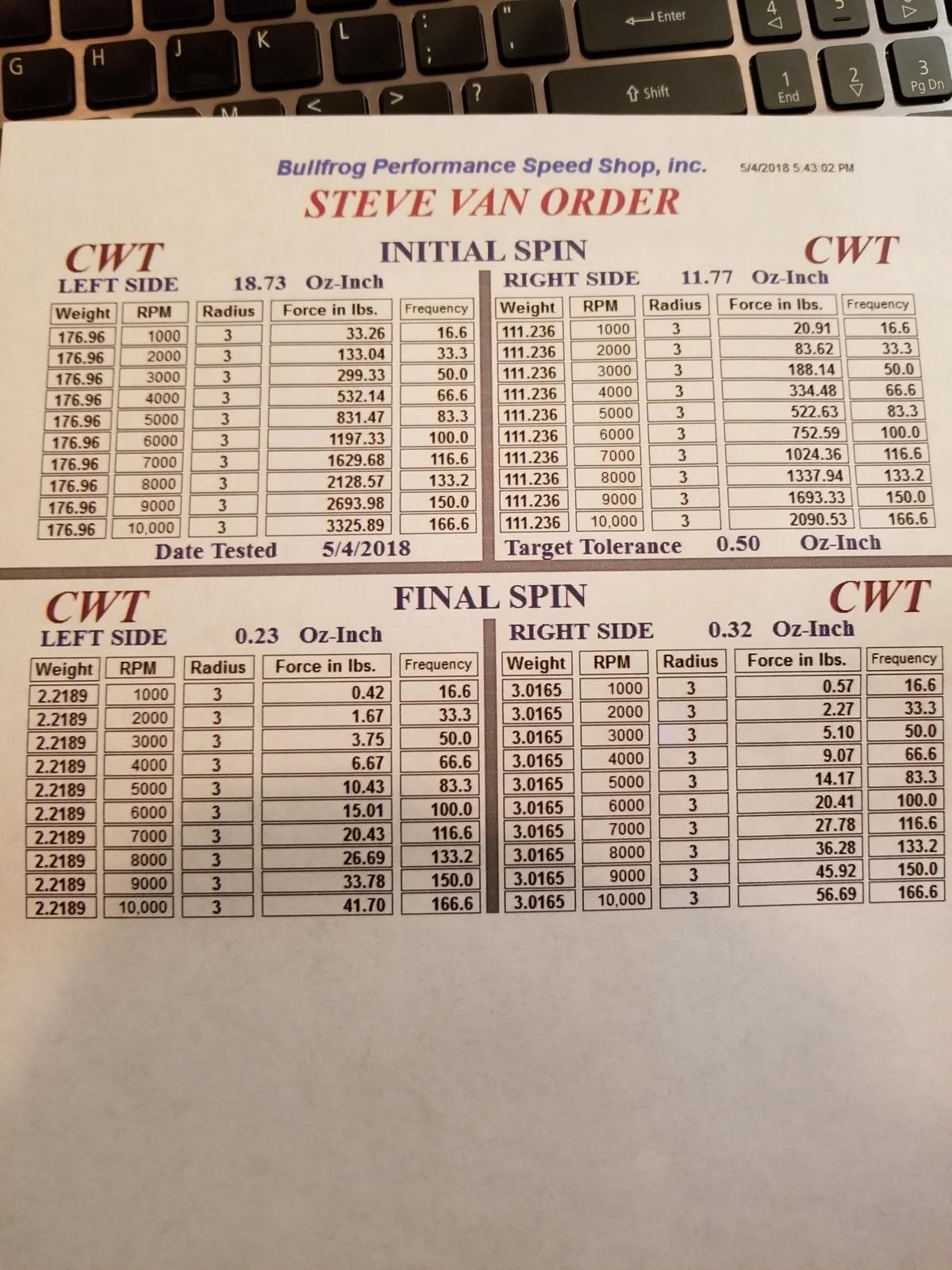

Waiting to pick the block, rotating assembly, bearings, rings, cylinder heads up from the machine shop....
