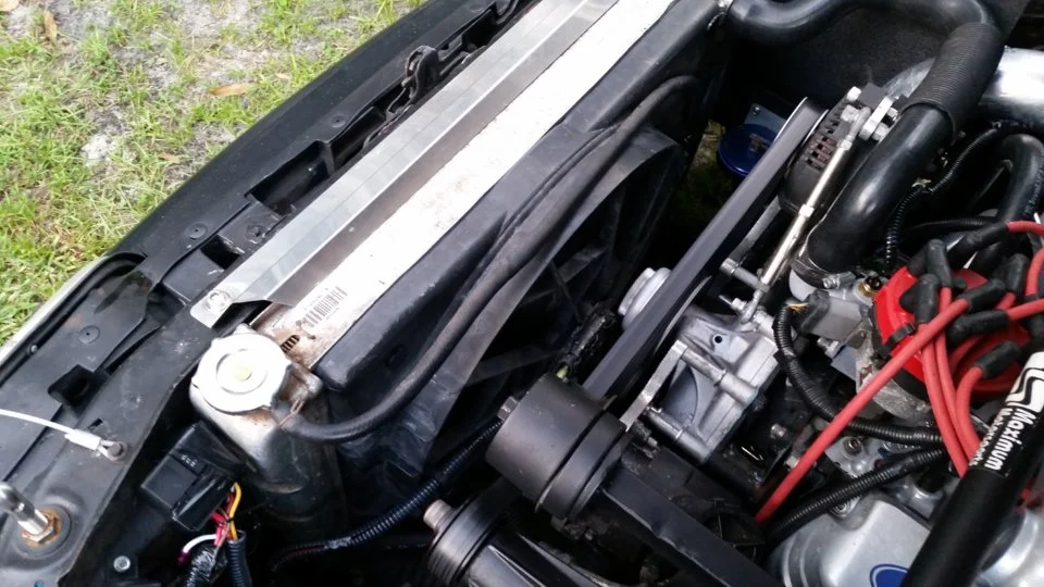

Car is running hot.... very hot. Went and got gas on the way home did some wot pulls. Drove maybe 6 miles, by the time I got home she was 230*!!!! The temp just slowly creeps up the entire drive....
Idles good until she hits 200-210, once she gets that hot it dumps a lot of fuel.
Mishimoto dual fans with shroud.... 1800cfm!!!:eek: that's it??? That's nothing! There is likely my overheating problem!
Found in the shed on a back shelf covered in two inches of dust.... a mark viii fan! It even has the black plug on the motor wich means it should be a two speed fan, as soon as it stops raining I will find out!
The mark viii fan works great! It even has the Canadian motor on it.

What do you guys think of the out come of the fan?
now it never gets above 195 even on back to back pulls. Also put the rubber flaps back on that go next to the radiator I stapled some extra rubber matting to them to get more coverage. That fan moves enough air to pull in small children.:D
