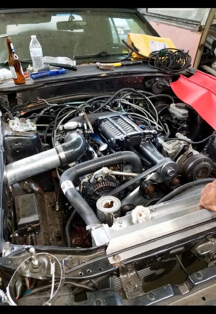

Aww yeaaaah! Old engine out, new engine in, unforeseen obstacles overcome, delicious bbq consumed, and good times hanging out with Steve and JR. Today was a good day! :D
The motor looks so great in there and sounded even better. @General karthief JR, I wish you had gotten that nap in and got to hear her purr ;) Congrats on a truly unique and awesome build Steve, I'm so glad I got to be a part of it and see the Frankenstang in person! :cheers:

This is not an engine swap, this is a custom M112 blower build on a SBF. the engine is a 306 CID SBF with a custom intake manifold made by yours truly. Why would i want to do what everyone else does? LS swaps are cool and make good power but how does that make it different from what everyone else is doing?
I like to go the road less traveled I have seen other PD blower swaps done on SBF but i dont think any of them look or perform like this one does, This has been a long road for me. The initial build was done with a remote mounted M90 from a supercoupe, it was a science project to say the least. But as time went on and I learned more about fabrication/tuning and how things work the project has evolved into what you see today.

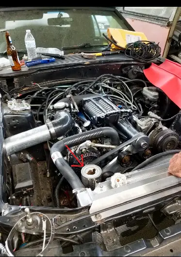

I have a way less ambitious mod idea for stock SVO's but I need to know how much space is under the inter-cooler as it sits in the engine bay to see if its possible..
