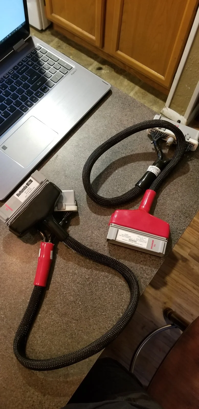

Right now I am continuity testing the rotunda harness adapter, I have a list of pins that need to be swapped to make it work. Mine came with 2 pigtails I am using the one marked (Harness-to monitor) so i have another 2' extension i am not using.
I'm using the one on the left.
and here is the pin list i have to swap, the left column is the side that plugs into the harness and the right column is the EEC. I did this very quickly with a multimeter and must verify these pins as i swap them so the list may change a bit.

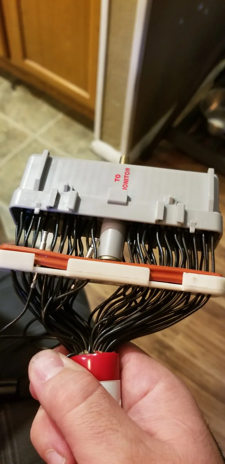

I have started to repin the extension harness, first I used a small screwdriver to remove the plastic retainer from the connector. The I pried the back off the connector and removed the rubber moisture barrier so the pins can be removed. This part requires a bit of finesse, you have to lift the plastic clip with a pick then remove the pin from the connector.
First I swapped pins 29-44

this is the final verdict for that side of the harness. now this is a problem, notice how pin #42 is empty.... that is injector #7....
I am going to move a pin that is not in use to the pin42 spot and simply move the jumper in the MS case to get injector #7 out where i need it to be. After doing a pin check on the other side of the harness i believe that you could move the pins in the reverse order that i have done above and pin #49 will be empty, thats a non issue since it is the O2 sensor ground anyway and is not used with the MS.
So i have a second cable that is not repinned if someone needs it.

Ok so I re-pinned the second harness and it will work without doing anything to the ECU... so thats what im doing.
The harness that says [Monitor to ECA] needs the pins moved as follows.
