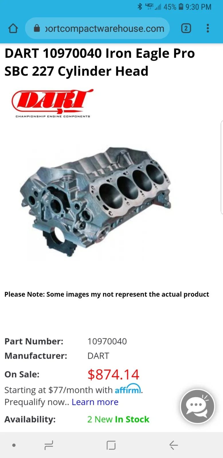

Or buy this but hurry up...free shipping
https://sportcompactwarehouse.com/dart-10970040-iron-eagle-pro-sbc-227-cylinder-head
The listing reads "cylinder head" for 877.00. Not Block. 227 cc CYLINDER HEAD.
Notice the small print that says " some images may not represent the actual product"
Like this image....that is the actual product
That's crazy...and I was a lil' tipsy.... guess I'll have to buy a 350 block now.. Should've read the heading.

I bet they get a lot of phone calls about that $877 block from people that see that block and the words 'cylinder head' doesn't register.
like me!
