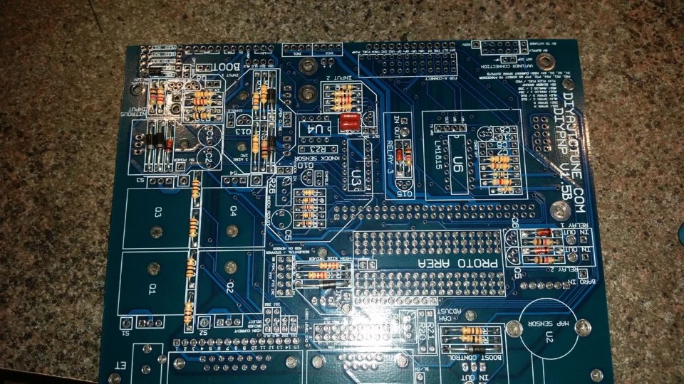

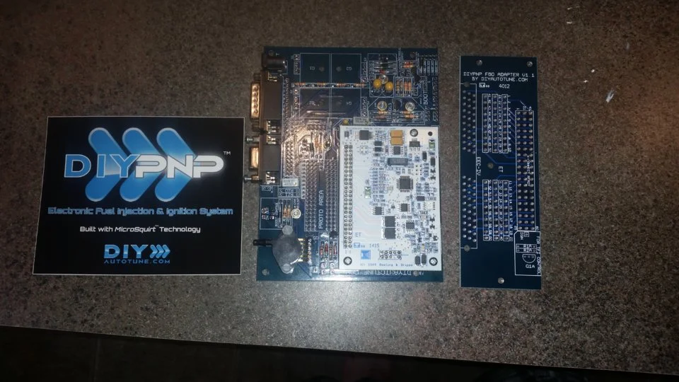

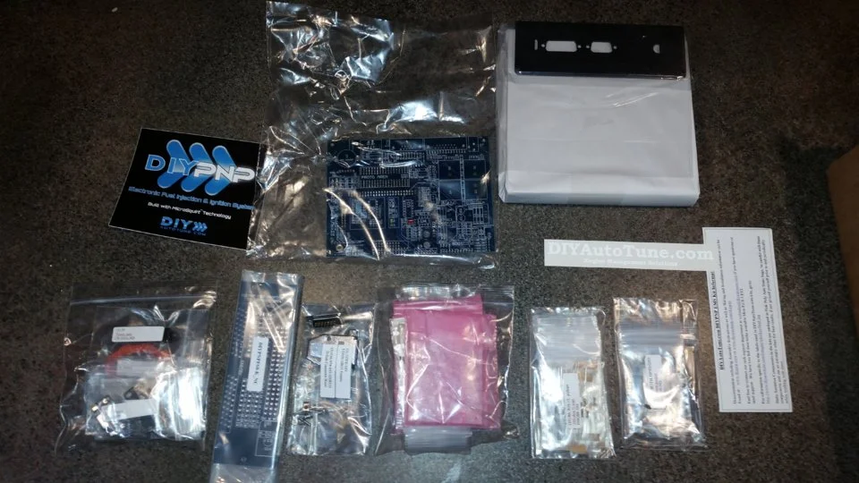

let's begin by saying the folks at diy auto tune make this idiot proof. All the parts are bagged separate and the documents are spot on.
this is where I am now, and it is tedious work. I'm not overly familiar with this stuff so the going was slow. I will say to the interweb posters that say they build these in an hour, SHINANIGANS! Lol. Much more to come I just needed a break. The soldering kit with a magnifying glass would have been worth the extra 30$.

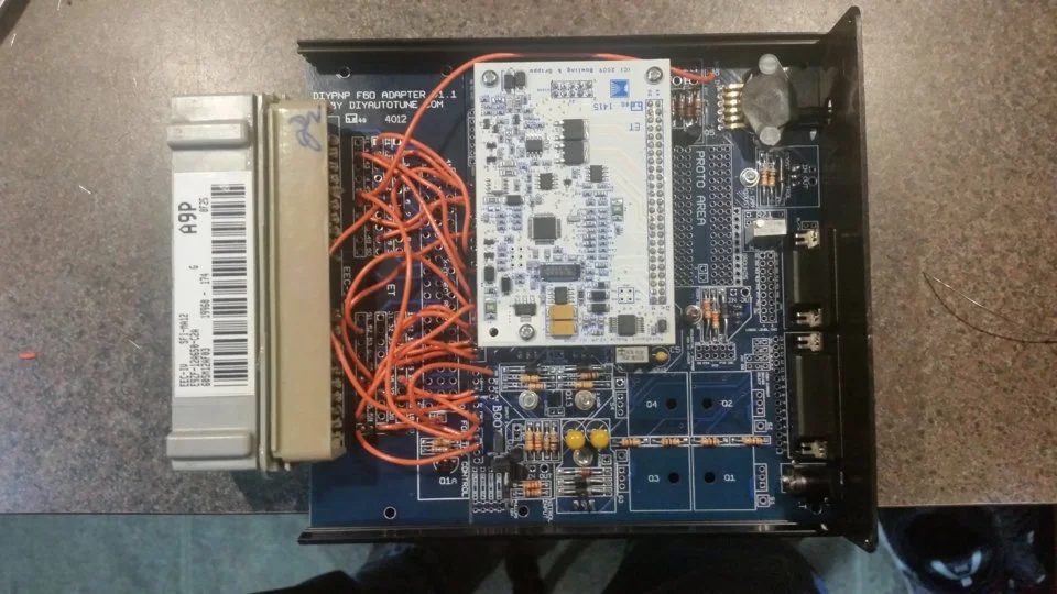

Advice.... buy a desoldering gun you will thank me. Getting the 60pin to separate from the old ecu in one piece was well difficult. There were expletives involved. In the end I was victorious. I will pin it out later after I do some research. I would like to use the stock baro for real time correction, all I would need to do is pin it to the "baro" slot on my ms. Lol you would think that is easy but I need to be sure it will play nice first.

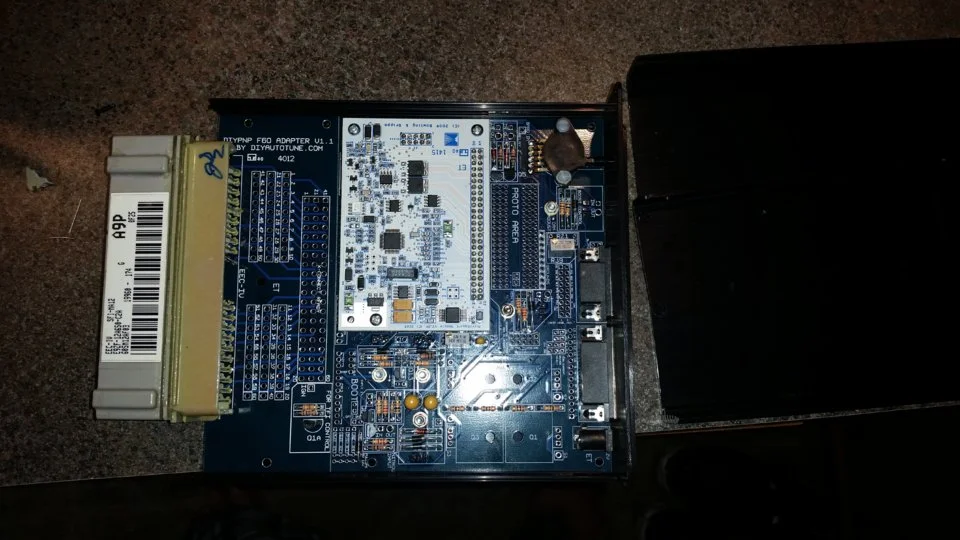

We are ready to load software!.
Extras I added, factory baro hooked up. Will add a 2 step from the clutch switch, just need some info if the sigrtn is OK to ground the input too..
I may try to add fan control as well.

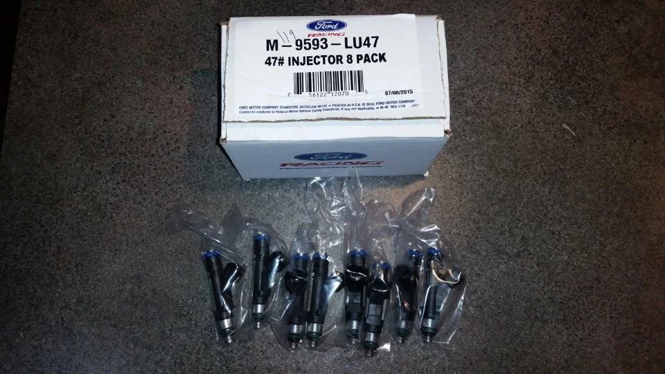

Oh and these came in, rated at 52lb at 43 psi.

Whoever said you were a redneck should have to build one of those kits from scratch.
The monster has a complete kit built MSII/V3. It took me over 8 hours to build that thing, and I've done two before that. I had to use a magnifying glass, as by the time you get every one of those circuits completed there simply isn't enough room for the tip of the soldering iron except right where it's supposed to go.
Bottom line, I'd recommend the mag glass as a must have. When radio shack was still in biz, I bought a kit that had a base, the glass, and two adjustable clamps to hold the wire so it could be soldered.
Invaluable.
I also prefer solder braid to a desoldering tool. You just touch the braid onto the joint you want to desolder, put the soldering iron tip on top of that, and the solder underneath gets sucked onto the copper braid. Worked like magic.
The best part of the whole deal will be when you start the thing, and know that all of the operations that make that thing run are now controlled from a computer that you built that started out as a bunch of doo dads in baggies, and an empty circuit board.

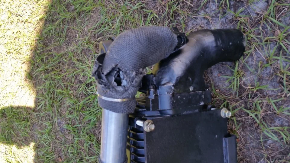

Have no doubt I plan to see this SC build thru to the end. Today I pulled the SC off to replace the leaky long tubes and discovered this.
that's a hole burned into the bypass tube.. it still made 3lbs of boost. I was scratching my head trying to figure out why I got an abrupt pressure drop from 6 to 3. This will require some re-engineering, hopefully I will have more clearance with the shorty headers.
Also I snagged some 1/8th inch plate steel from work and my 3" ss exhaust bends came in. With this I plan to make some adapters and eliminate all the rubber bends in my piping. The outcome will be one tb before the SC. Without an intake tract that will flatten out under vacuum.
On another sidetrack idea, a waste gate on the pressure side of the SC would be a cool idea. That way I can run my smallest pulley and regulate boost to whatever I want. The idea was to add 1psi at a time for tuning the boost ve tables. It's a pita to constantly change pulleys. Any thoughts??

People have run wg's on big centri blower setups for a while so they can pulley it up and set max boost. This also makes for a flatter torque curve, or so I've read. I say go for it!
