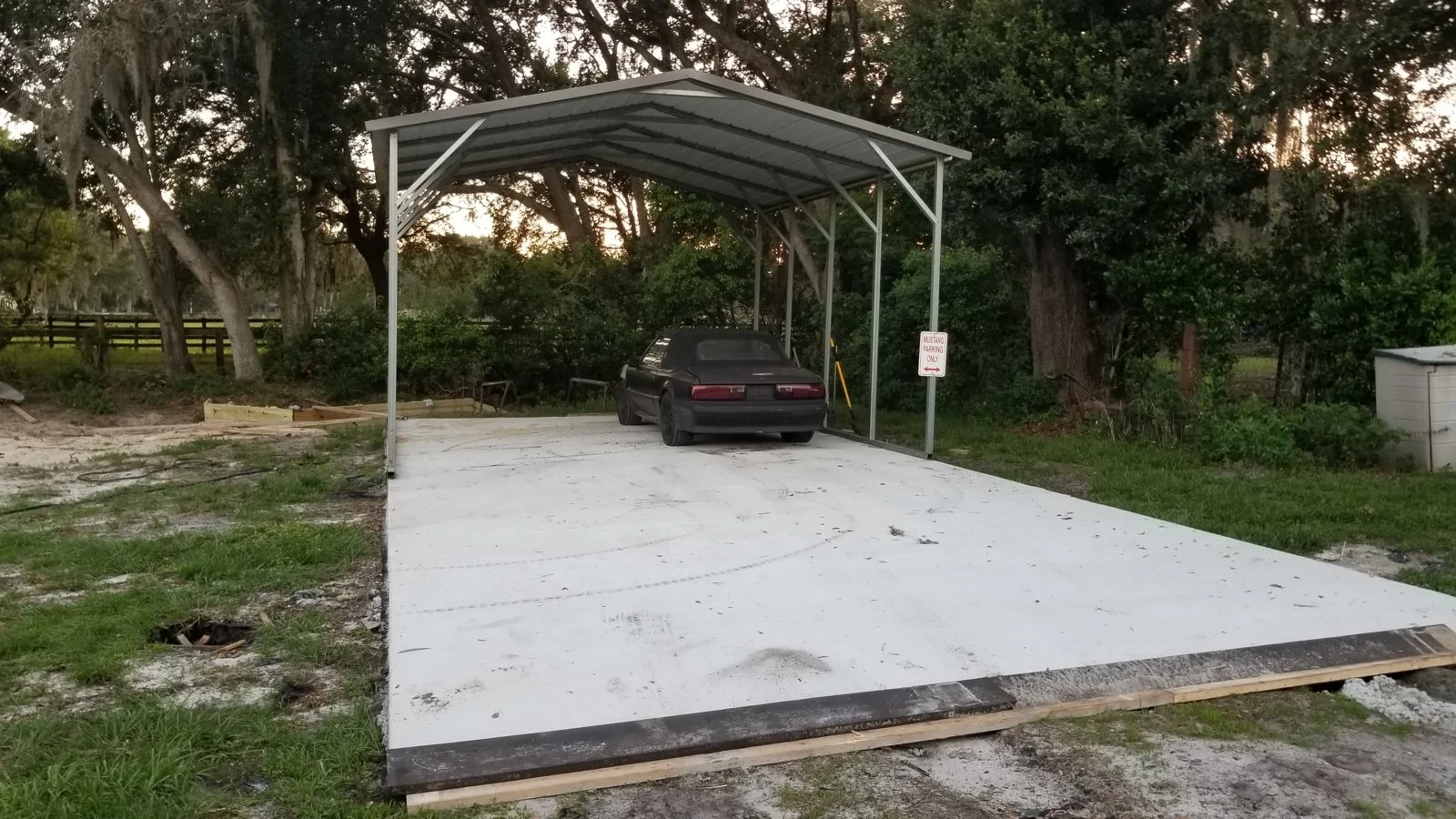

Lots of parts are going to be showing up soon, slowly getting everything needed for the assembly together. Buying lots of quality parts this time so hopefully this should go well..
Also the Mustang has a new home, although a humble one.
